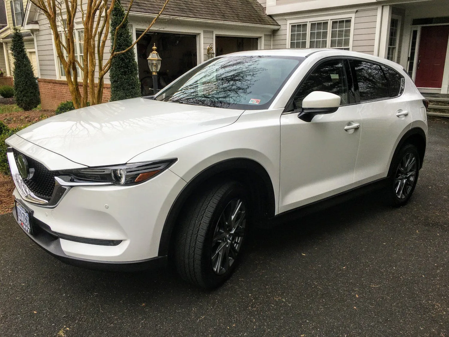

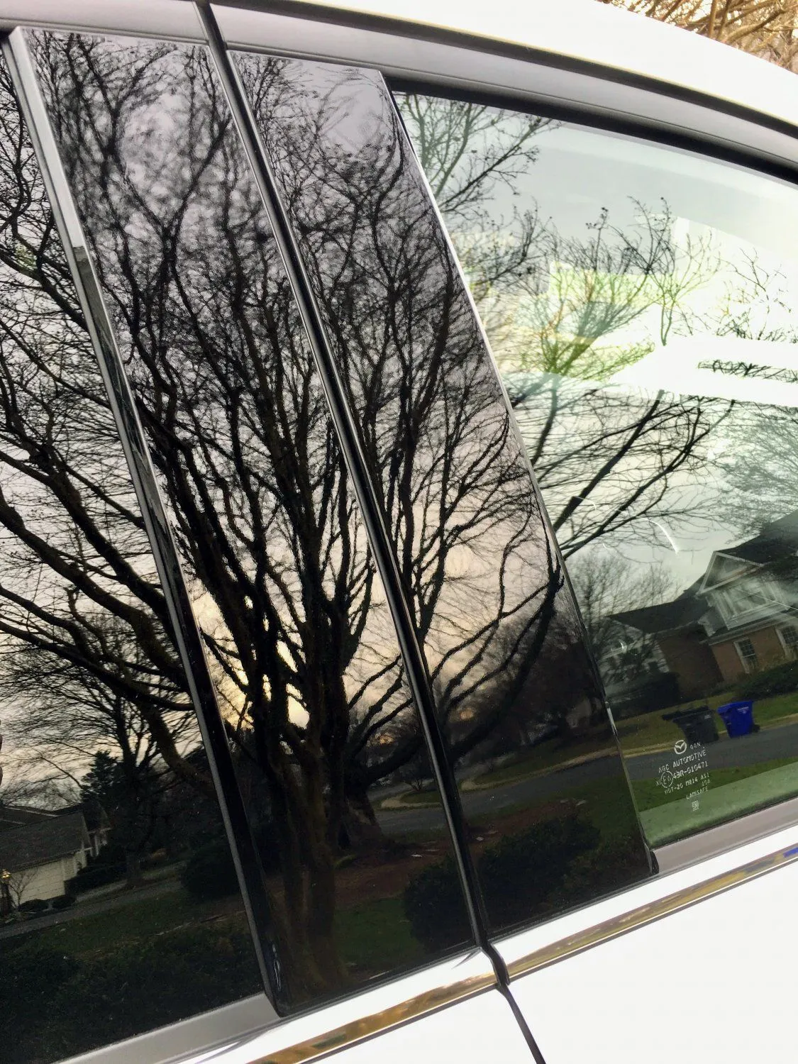

I was able to get some 3M Scotchguard Pro Series Paint Protection Film (PPF) 10 year warranty, installed on a White 2021 CX-5 Signature.
1. Partial Front protection includes front bumper, partial hood, partial fenders, mirrors, tucked and wrapped

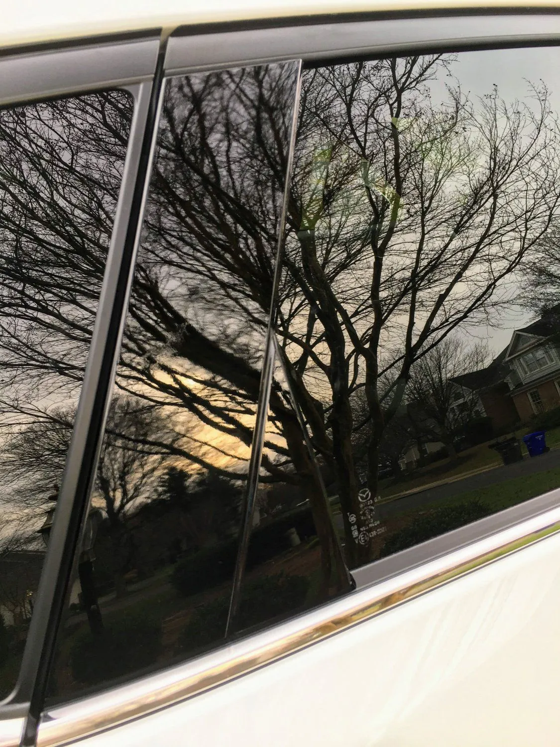

2. Piano Black B and C Pillars - to prevent the bad scratches everyone talks about

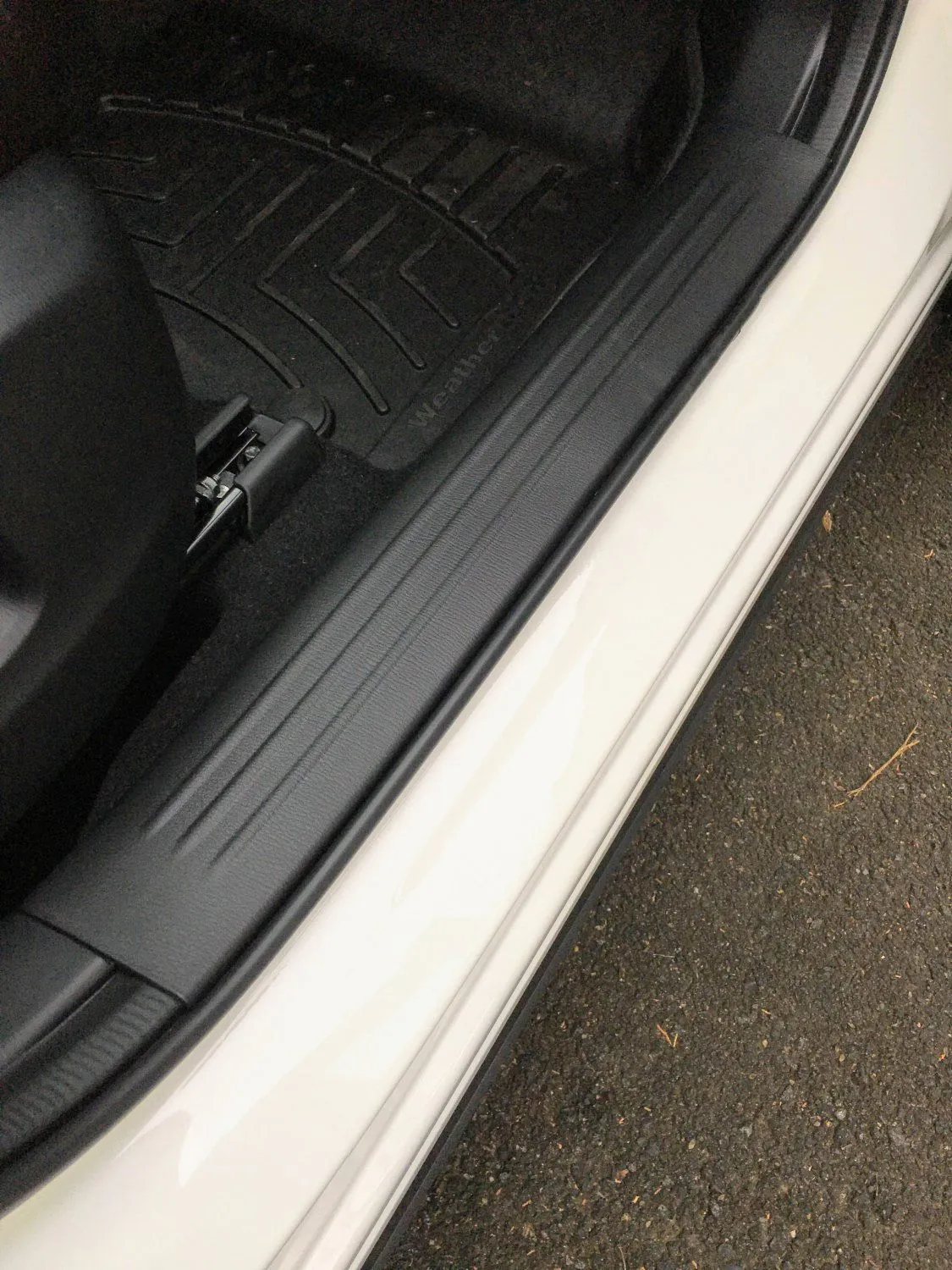

3. 4 Inside Door Sills - to protect from shoe scrapes - top of door sills, including 1/2 inch fold over the outer edge
4. Top Rear Bumper, top of bumper - to protect from cargo accidentally hitting the top of the bumper including 1/2 inch fold over the outer edge
5. 4 door handle cups - to protect from fingernails and rings
The installer is the most important part of the process, and I found a good one.

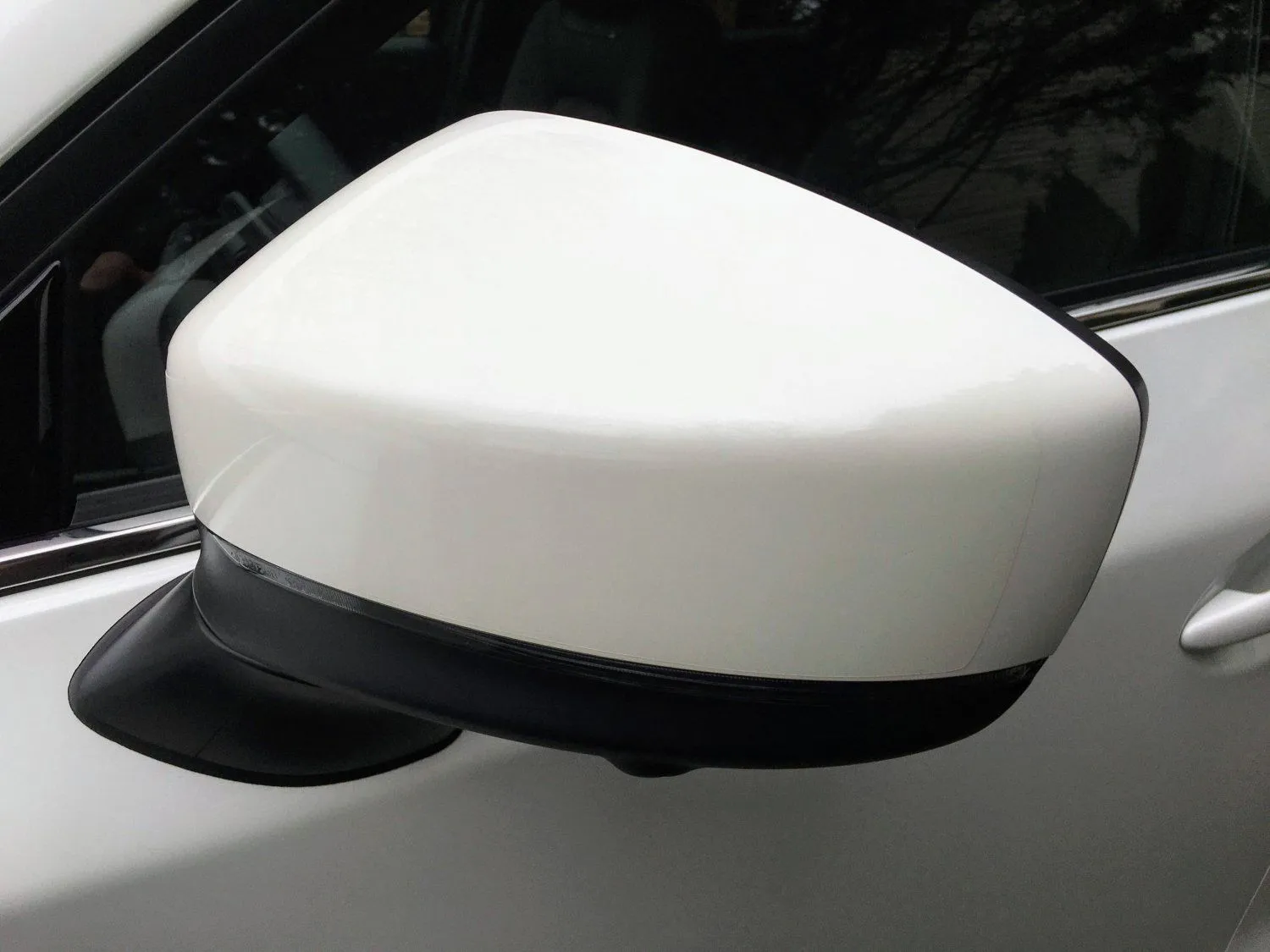

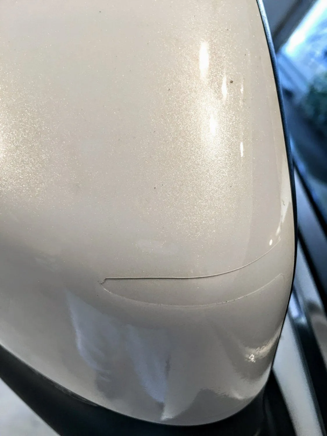

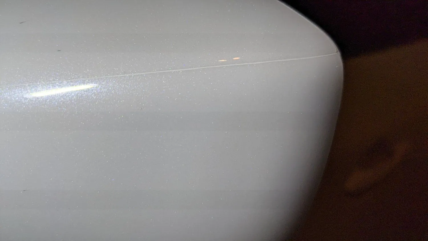

How’d they cover the mirror caps? Try as I might to get the PPF to stretch around the curve to cover the top, front, and inner side with one continuous piece; I still had to make a cut and flap a section around. Can we get a close up view from the front inside view?
Looks real nice. Keep it clean and shiny. :)
Side view mirrors are split down the middle so there's no hard curves. I'll try to get a picture when I get home
They have a cut so there is no excess material on the compound curve
They have a cut so there is no excess material on the compound curveView attachment 233788
Ah, OK. I wound up doing very much the same. I was thinking somehow they stretched or shaped it around the cup without a relief cut and wondered what magic they applied.

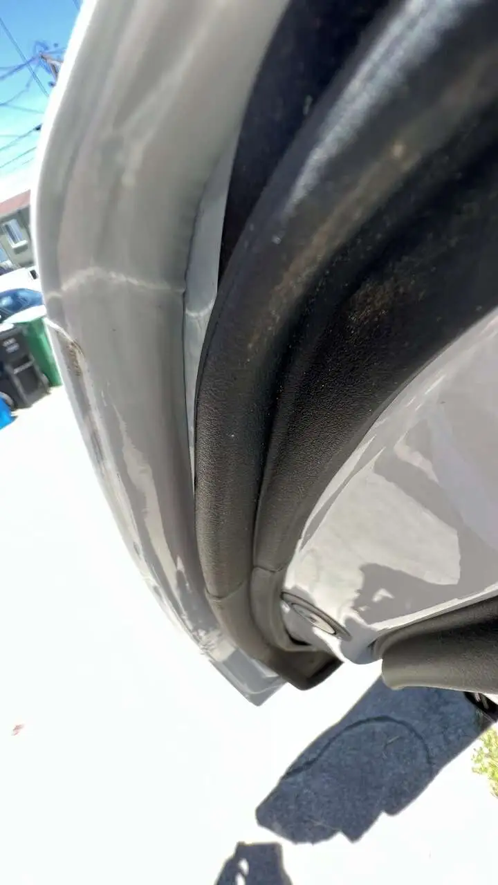

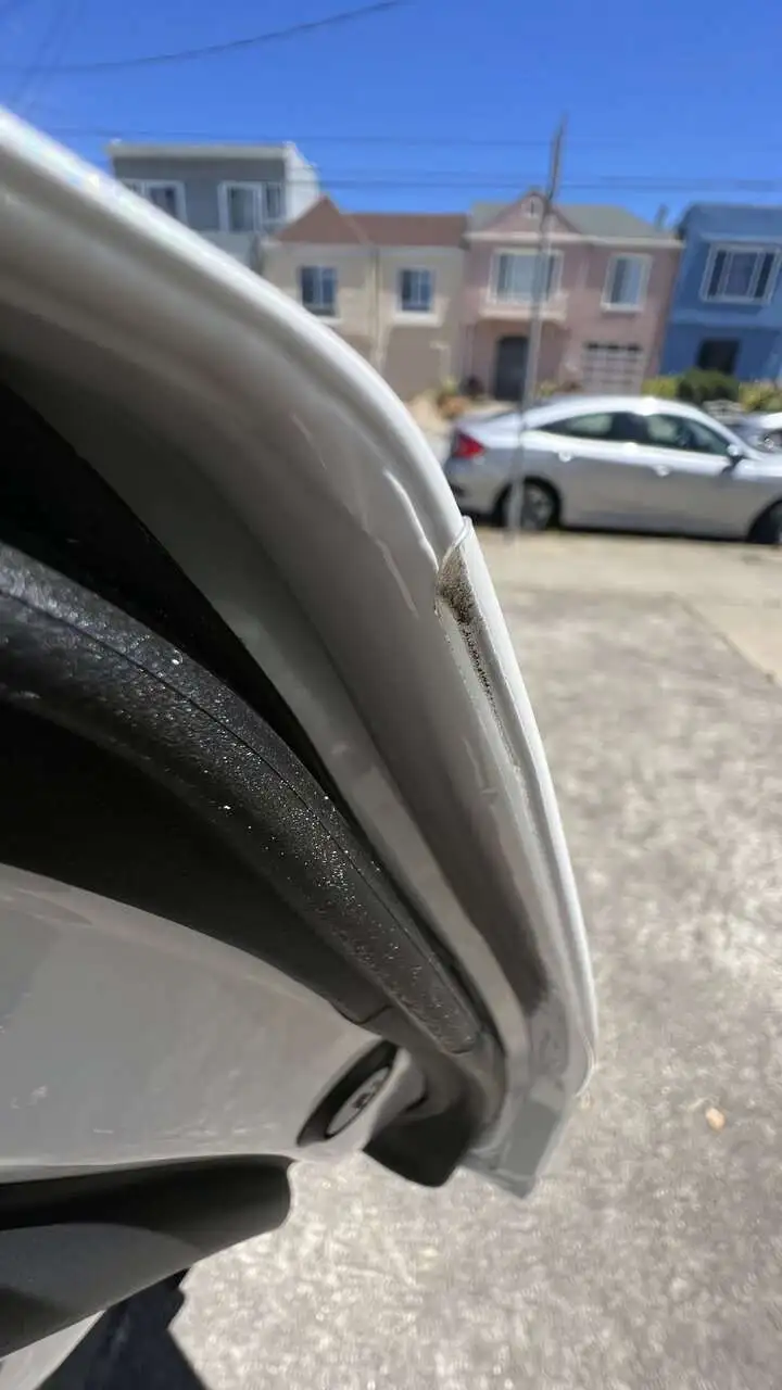

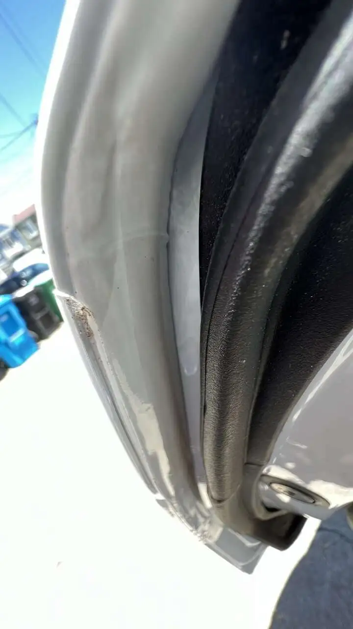

Anyone know when the door edge ppf is lifting and gets a little dirty, is it ok to use water & soap solution and a tooth pick/toothbrush to clean it and then followup with tack solution (90% water & 10% (70% iso alcohol)) or 3m spray adhesive?
It is a 21 GTR with stock door edge ppf.
