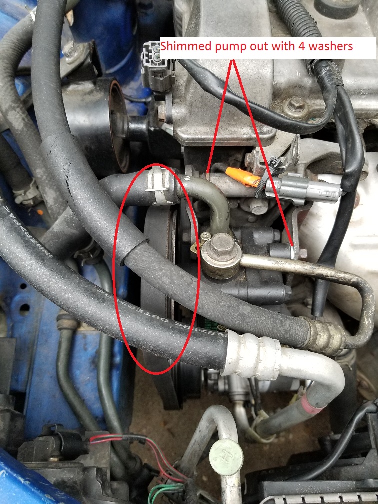

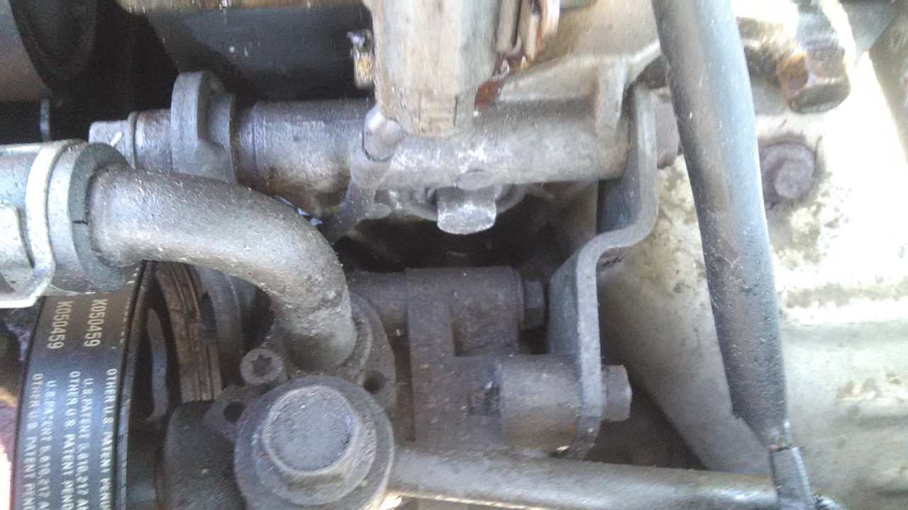

As shown here, I shimmed the P/S pump outwards with 4 washers: two on inner bracket-to-pumpbody, rusty one on swing point, and one between tensioner bracket and pump's arm that bolts to tensioner.
Short test drive = fine.
20 miles on freeway to work = fine.
1 full week of 40 miles per day on freeway = dammit the belt is gradually riding up again!

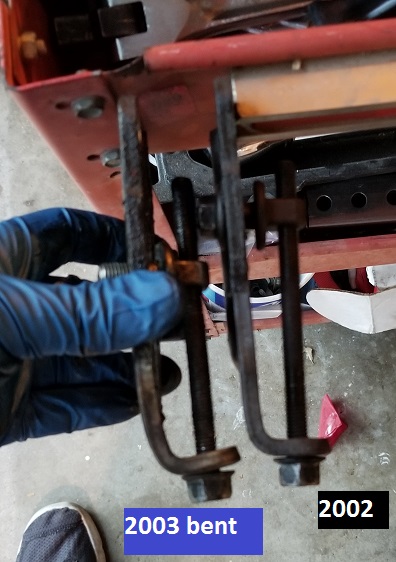

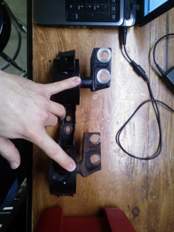

The '02 pump and it's attached upper brackets are visually identical to the dead one off the '03.
The tensioner bracket off the '02 is visually undamaged, the one off the '03 is badly bent inwards, so I am certainly not putting it back on:
-----> So, why does my P/S & A/C belt want to climb outwards? <-----
