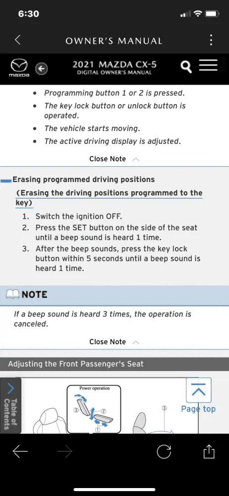

We have programed our 2021 CX-5 drivers seat to the wrong settings. I am trying to find out how to clear the current programming on the memory buttons on the seat and start over to do a new program. Can not find any information on this? The only thing I have heard is you disconnect the battery and that will clear the program.
This is from the online owners manual
I tried that . It erases the command between the key fob and the seat but does not erase the command when you push the 1 or 2 button on the seat. I need to erase that command when you press the 1 or 2 button on the seat.
