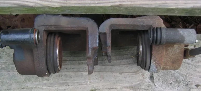

I think there was a large discussion about replacing rear calipers on protege5 2001-2003 with mazda 626 calipers, not sure what year 626, check out eBay and look at the pics to match up your caliper and then find out what year. I read it a long time ago, they found out that the 626's surface area was 10%-15% larger than OEM protege5's. I don't know about the front caliper's and I haven't had any luck re-finding these posts I read.
This pic shows the 626 caliper VS. the Protege5 caliper & you can see the size difference.
The biggest concern that I read was some people were unsure if the caliper might scrape up against the wheels, being that they are larger.
