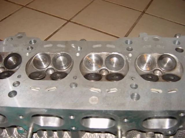

HEy guys. I am new in this website but not to the FS engines.
I modified my engine by porting and polishing the Head, Intake
Manifold and throtle body, plusss i got Ovesize valves.
I can tell you that my car is running really sweet and that i can confirm that it really gives you alot of horses(for the non-believers). I also lighten my flywheel and got a scoop in my hood,so i got plenty of AIR. p5sundevil Said that our engines Have bottle neck parts..... Well he is totally right. This is one of the biggest problems that FS engines have and I already solved it. I am going to start selling intakes like the one you seen in my picture but before that i am going to Dyno my car to get all the right readings. I can assure you that the proteges Engines have alot of potencial, you just gotta find it.

As you saw my intake was not just ported and polished but REDONE..... The normal intake has 8 holes and 8 throttles inside the manifold. allt of them were removed and the 8 holes were converted in to 4 big ones. I was very impressed with the Price in Autralia since it cost me way more than that, but also i need to remember that my head was completly changed since the valve seat had to be re-done (much bigger and wider) so the new valves could be fitted. i am goint to post a picture of it.
here is my head LOL
looks nice, the price i said before was just for a port and plish as well as valve work. it was not anything like what you described above changing the actual design of the holes and so forth.
I imagine that you are planning either big N/A numbers with work like that or huge boosted numbers with all that N/A buildup.
either way very nice work and I look forward to seeing the numbers you get, I have to start pricing out all the work I eventually want done.

The Head was ported and polished and has ovesize intake valves(see picture and you will notice how they barely fit in the chamber)also the intake manifold was cut ported and polished.
the throttle was bored and polished and the flywheel was reduced in weight from 18.5 stock lbs to 14 lbs so i wouldn't loose too much torque like with the 9 lbs that they sell.
