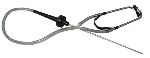

A mechanic's stethoscope is a cheap, worthwhile addition to a tool kit. You can put the stethoscope probe on different parts while someone turns the wheel. The sound of the popping will be amplified and much easier to locate.
