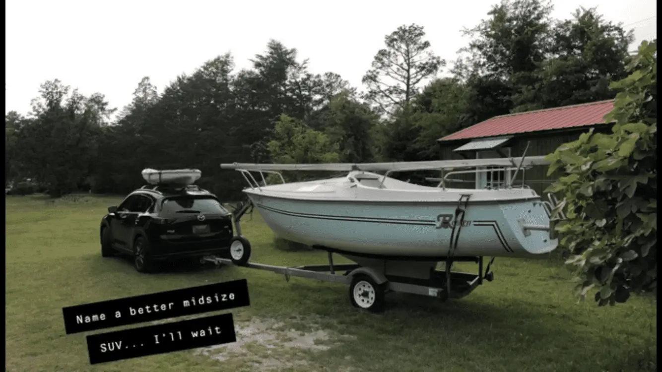

Here's what I was towing for 700+ miles which is why i think it may be a trans issue

Huh. Plus stuff on the roof. I'd say the drivetrain was getting a decent workout.

you're still under the powertrain warranty so have the dealer look at it. Mention the mileage drop and the oil you see, but DO NOT tell them about towing the boat unless they ask. How much does that trailer weigh? The tow capacity is only 2,000 pounds
and the whole car was loaded, and the boat cabin was full... I was moving.
Wow I'd have to imagine it was over 2k pounds towing the boat+ everything else in the car and inside the boat! And over 700 miles! That likely was way to much strain.
Mazda builds their cars on the edge, example the rear differential is tiny and takes a scant amount of fluid to cut down on drivetrain loses......they do not over engineer their cars with tons of leeway to add HP mods or in your case towing capabilities.

That was a heavy boat, car filled to the brim, stuff on roof. I don’t think it would greatly diminish your mileage but I’m worried the transmission fluid is cooked. No fluid is lifetime after a workout like that. My ‘19 RAV4 says to change the transmission fluid at 60k under severe service (and I think it says to leave alone otherwise). 700 miles with that strain and I’d want to drain and fill the trans 3x as you’re approaching 50k. That was beyond severe. I’ll echo another sentiment: have a dealership check it out and don’t mention the 700 mile trek.
