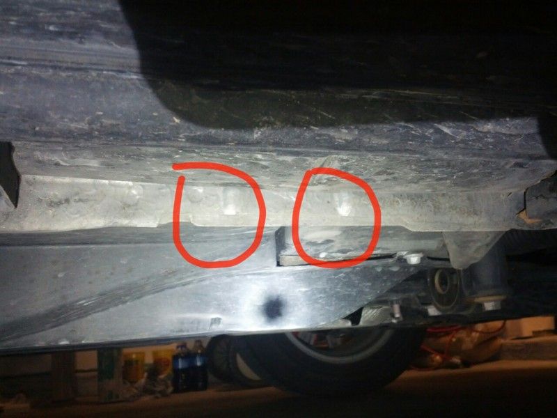

Point out the jacking points for me - please (photos)
DBLXX
REAR TIRES -
Not sure if it's the top left where the oval circle is or lower down toward the center where the bolt slides in?
FRONT TIRES -
Which bolt head is it? Look at the bolts as a triangle - is it the left, right, or the one furthest away?

Uhh.. NO. Jacking points are on the FRAME itself on the side of the car, no where under the car or mechanical parts!
Look in the manual, it's like any other car, there's little | | marks, that's where you put the jack.
There's another thread here somewhere that shows photos!
I found the thread: http://www.mazdas247.com/forum/showthread.php?123823081-How-to-jack-up-your-CX-5
And here's a photo:

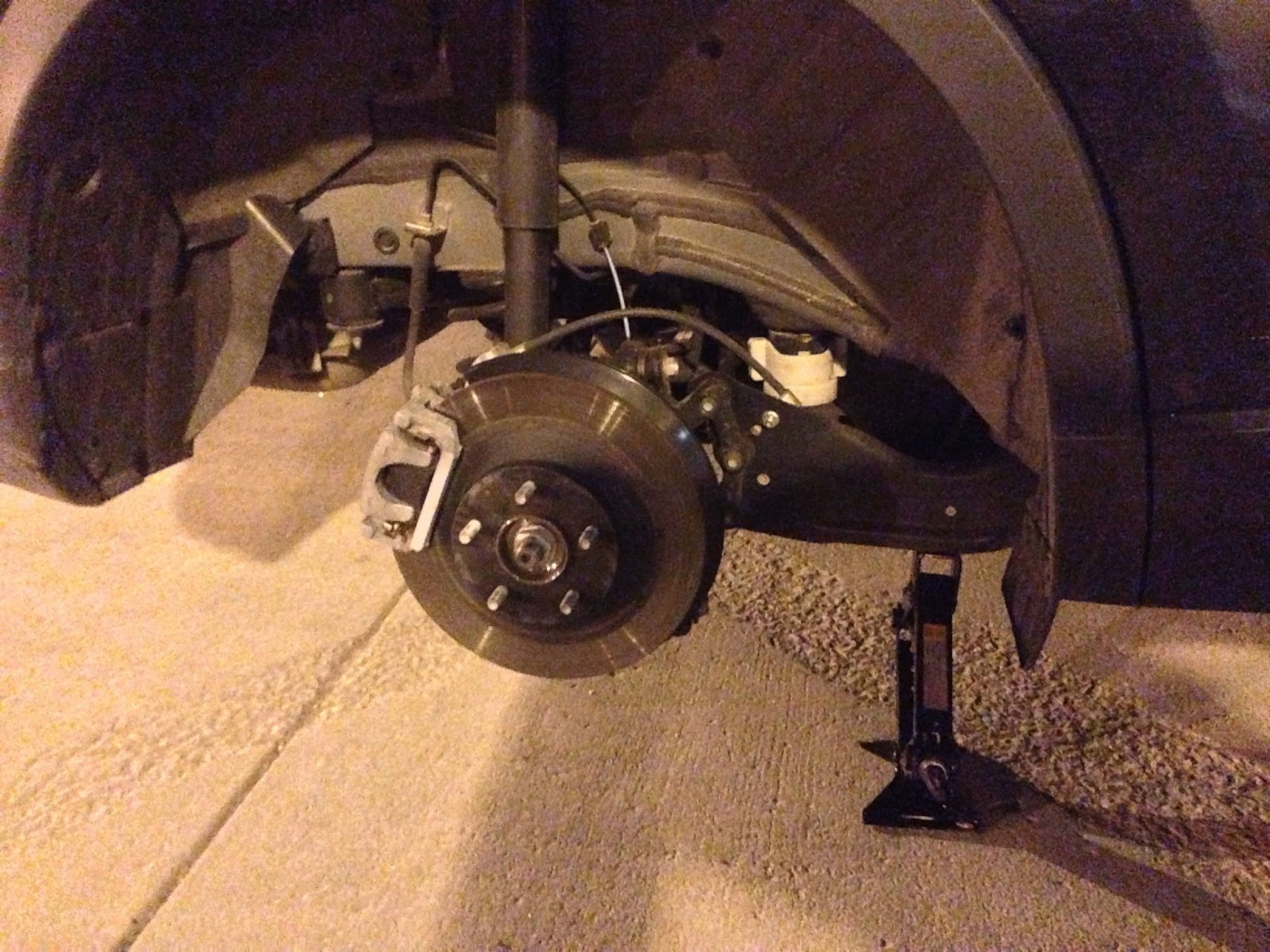

And this is a photo I took:
attachment.php
And I guess this:
attachment.php

That's why I put up the 3rd photo for those spots.
Has anyone actually jacked up their CX-5 from the center of that honeycomb looking think right behind the skid plate plastic.
It looks to be the center point of the crossmember.

Actually I lift the car as in the last picture, but I put a stand under the car. The spring holds the car, it won't fall.
