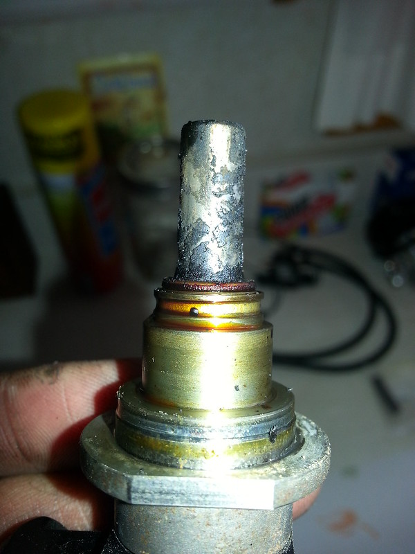

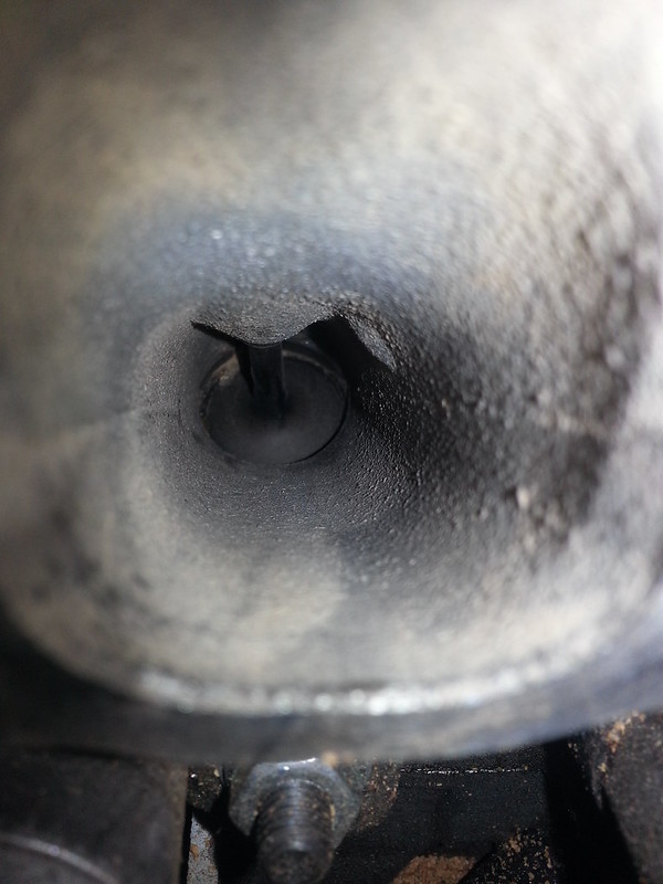

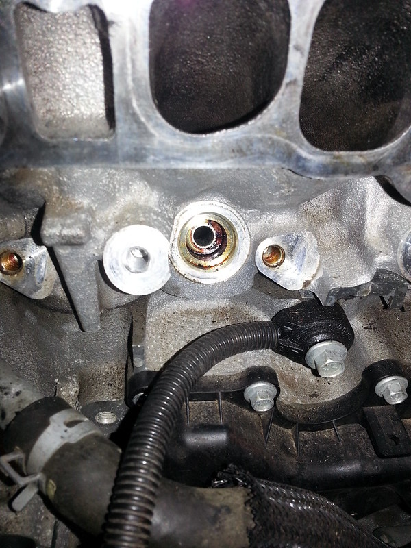

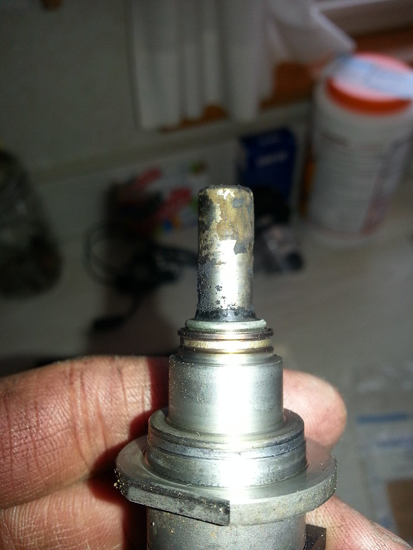

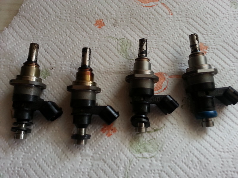

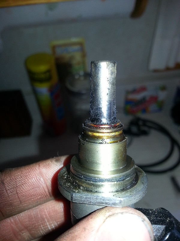

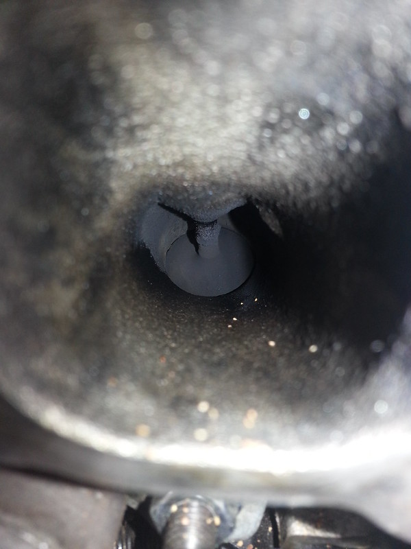

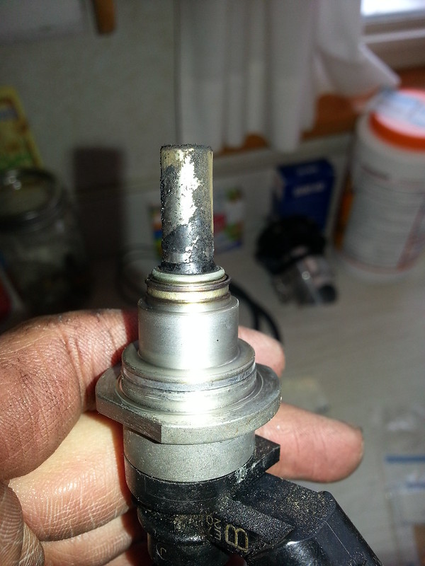

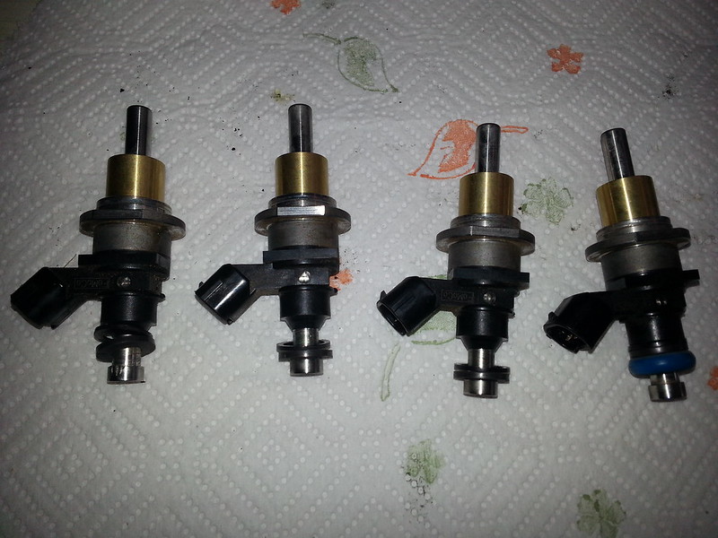

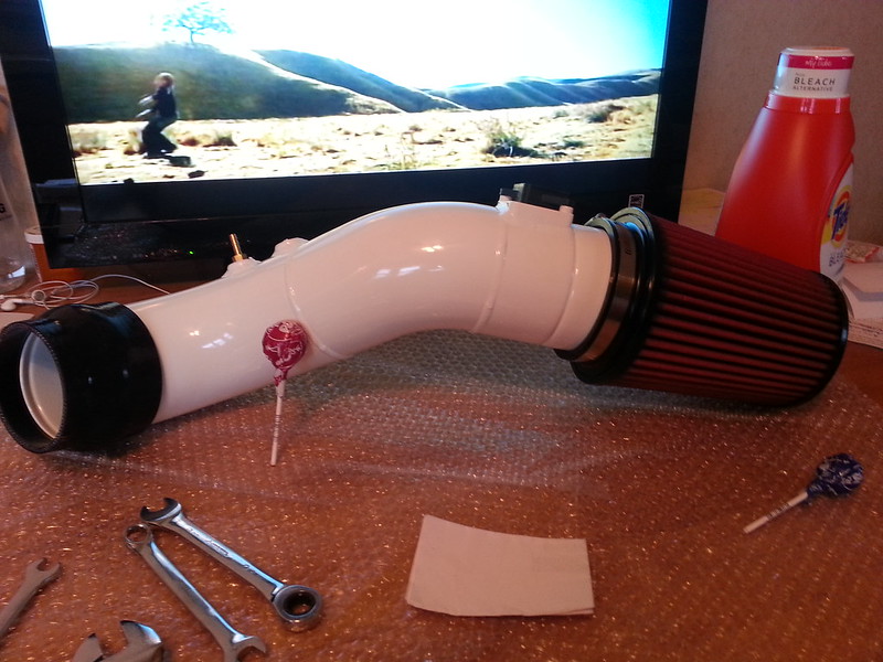

I removed the s*** Toyota injector seals to find out they lasted a full 12k before leaking. I had them in while I was tuned for e85 at the beginning of the summer then I pulled them last week. I also cleaned the valves with walnut media and a media blaster from HF and B12. I put in cp-e safe seals that I got through a black friday sale for 160 shipped. They are very nice also noticed a lot of carbon build up on the injectors from what I would assume be from running ethanol. All clean and pretty now. Will update tonight as well as I am getting my new intake from HTP, 4" custom VTA Powdercoated white.
Injectors with old seals and carbon:
The #1 and #2 injectors were leaking:
The #3 and #4 injectors were not:
These are the cp-e safe seals, came with an injector hammer too which was very helpful:
This was #2 injector runner:
Valves Before:
After:

Meh, 2/4 leaking aint bad. Haha. I'll have to get some better injector seals in the spring.
It could be from all the carbon on the injectors could have caused separation. Idk I just know I replaced them with some good stuff this time.

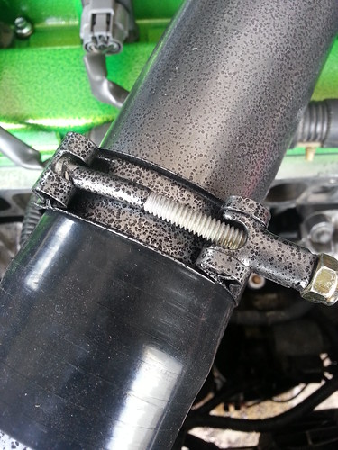

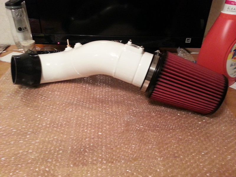

Also update, I did get my new intake and damn is she sexy
This makes me sad. I ordered those Toyota seals like a day before you sent me pics of how bad yours got. Got a call from the dealer that they arrived today.
For as Cheap as they are I really don't see a problem with them.I don't think they are very reliable when pushing much more than bolt ons without a tune. But I feel with the stress of having a tune and running ethanol it got the best of them.

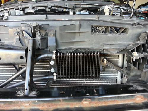

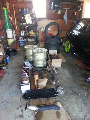

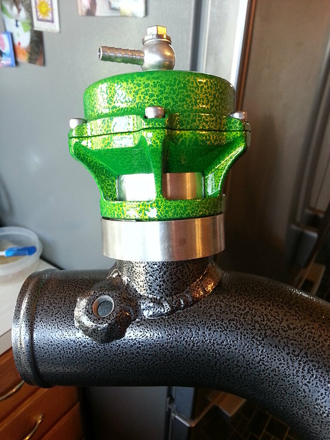

I did get sposored by Full Race but they were not able to make the cost of their parts make financial sense to me even with their wholesale discount. So I am getting a custom tubular exhaust manifold made. I also ordered a precision 5858 cea turbo full v-band turbo. I am getting a tr11 core and a 6th port to be put on before the winter is up to help with the air flow of the new turbo as well as the extra fuel needed.
Haha I know I know but it was 1950 for a turbo then 950 for a mani and I could get it for 850 from edge and they insisted it was their wholesale pricing. So I will make my own s***

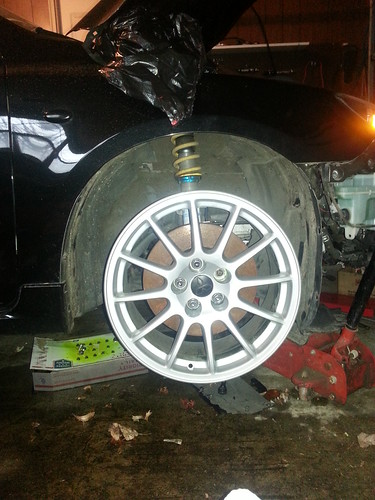

Few pictures from what I have been screwing with this winter!
^^^I would never buy XXR wheels my new Evo x wheels came in the boxes

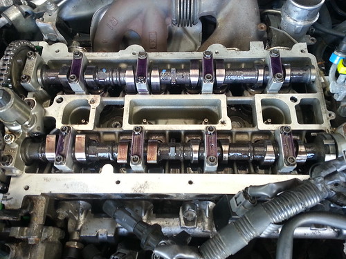

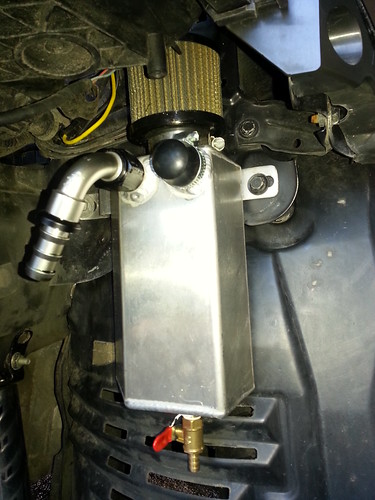

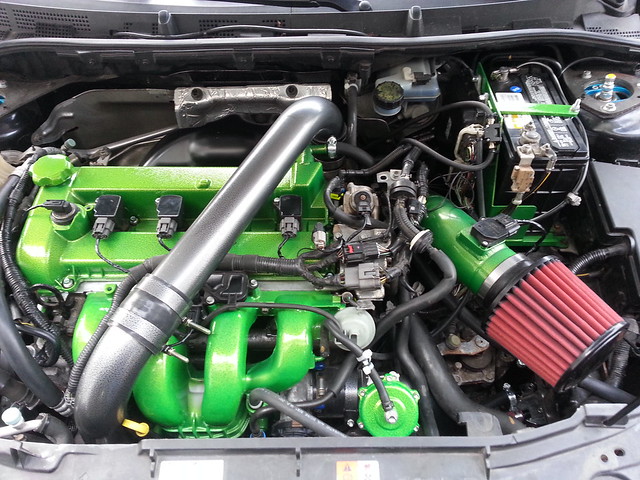

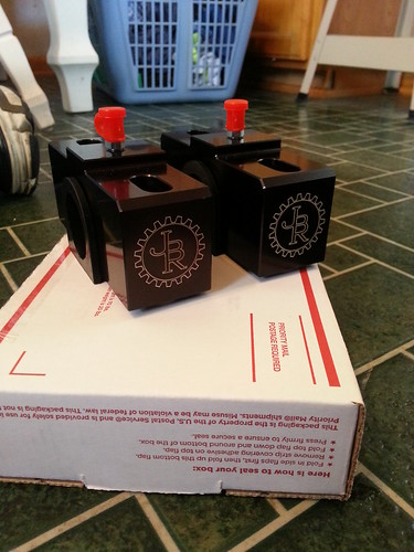

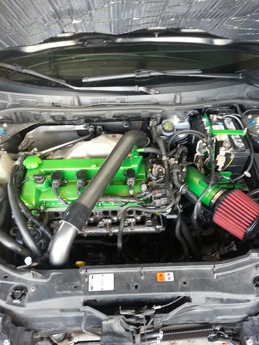

did a few things this morning before I have to leave for class. Put oil in the engine (Royal Purple 5w-30), hooked up both Oil Catch Cans and check valves, painted the heat shield that is over the exhaust manifold, and installed some of the parts that I got back from the powdercoater last night.
Put that purple stuff in the engine and on the new cam

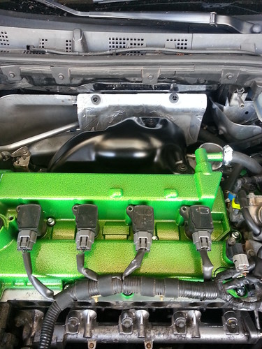

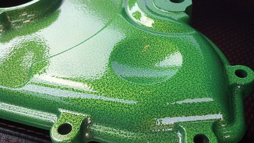

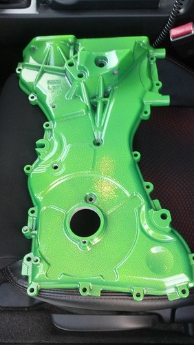

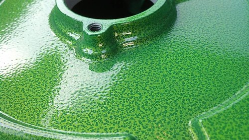

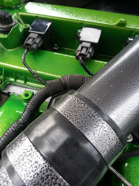

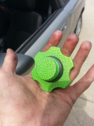

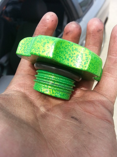

got about 80% of the stuff back from the powder coater. The final color is a base of Silver Artery with a top coat of Shocker Yellow. the stuff that is not green/yellow is just coated in the Silver Artery without a top coat to offset the Shocker Yellow
Also painted the gross heat shield over the exhaust manifold with high heat rattle can paint just to clean it up

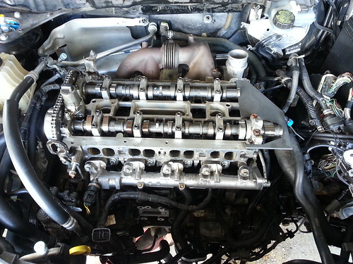

Little update I got the car running and back together. Did have an issue with the oil pump taking a s***. But its fixed and running again like a champ.

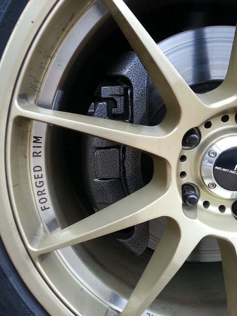

Forged WHEEL Konig/Enkei! haha
And don't tell Baby Marc, but I don't like his wheels at all...
I love yours though. Don't sell them. Or I'll kick you in the nuts.
