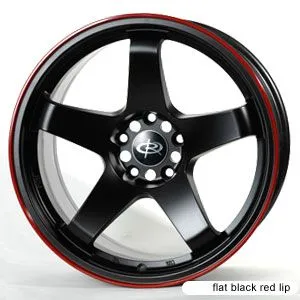

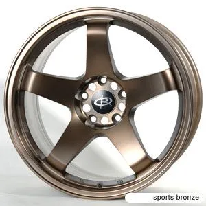

I feel in love with the Rota P-45R's. I `m not to familiar with rim sizes and fitment but here is what they offer.... Will it fit? And what tire sizes would work? (Rolling the fenders is not an issue, I`m ok with that) Thanks guys!
18 x 9.5 5 x 114.3 +30
18 x 9.5 5 x 114.3 +48
18 x 9.5 5 x 114.3 +25
18 x 9.5 5 x 114.3 +12

Suspension geometry would be out of whack. Too much of a deviation from the stock set up. I wouldn't recommend.
the wider you go the lower offset you would want to go to get it away from the struts, and then you would have to roll the fenders, but like previous people have mention your geometry would be out of wack

18 x 9.5 5 x 114.3 +48 will be your best bet. You'll have some clearance issues with the inside of the rear fender. Rolling might take care of that. I'm not sure what issues you might see with suspension components.
it'll really depend on the tires, you'll have to stretch a 215/35/18 over them and you'll still rub,
fold the rear fenders flat and if possible run camber on it.
stock streched tire should be ok.....if you are on stock suspension rolled fenders should be enough , but if you will lower car in future start saving money for coilover because there is no way any of those wheels will fit with lowering springs.....

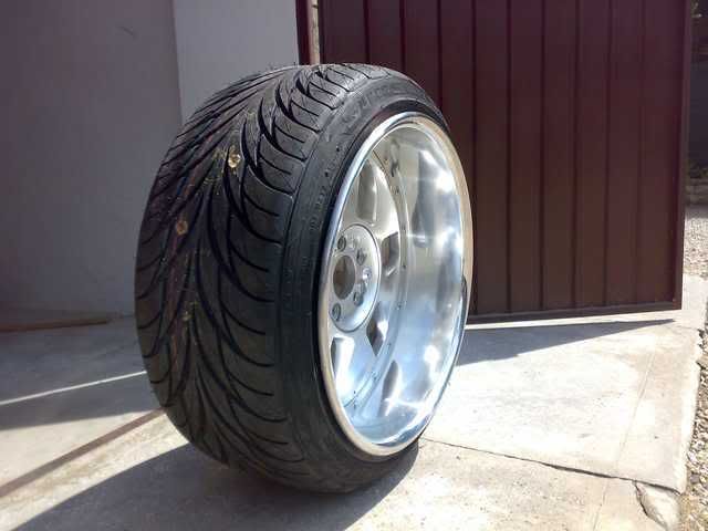

215 on a 9.5 is not that crazy of a stretch, the 240 guys do that all the time
here is a 225 on a 10.5 wheel
