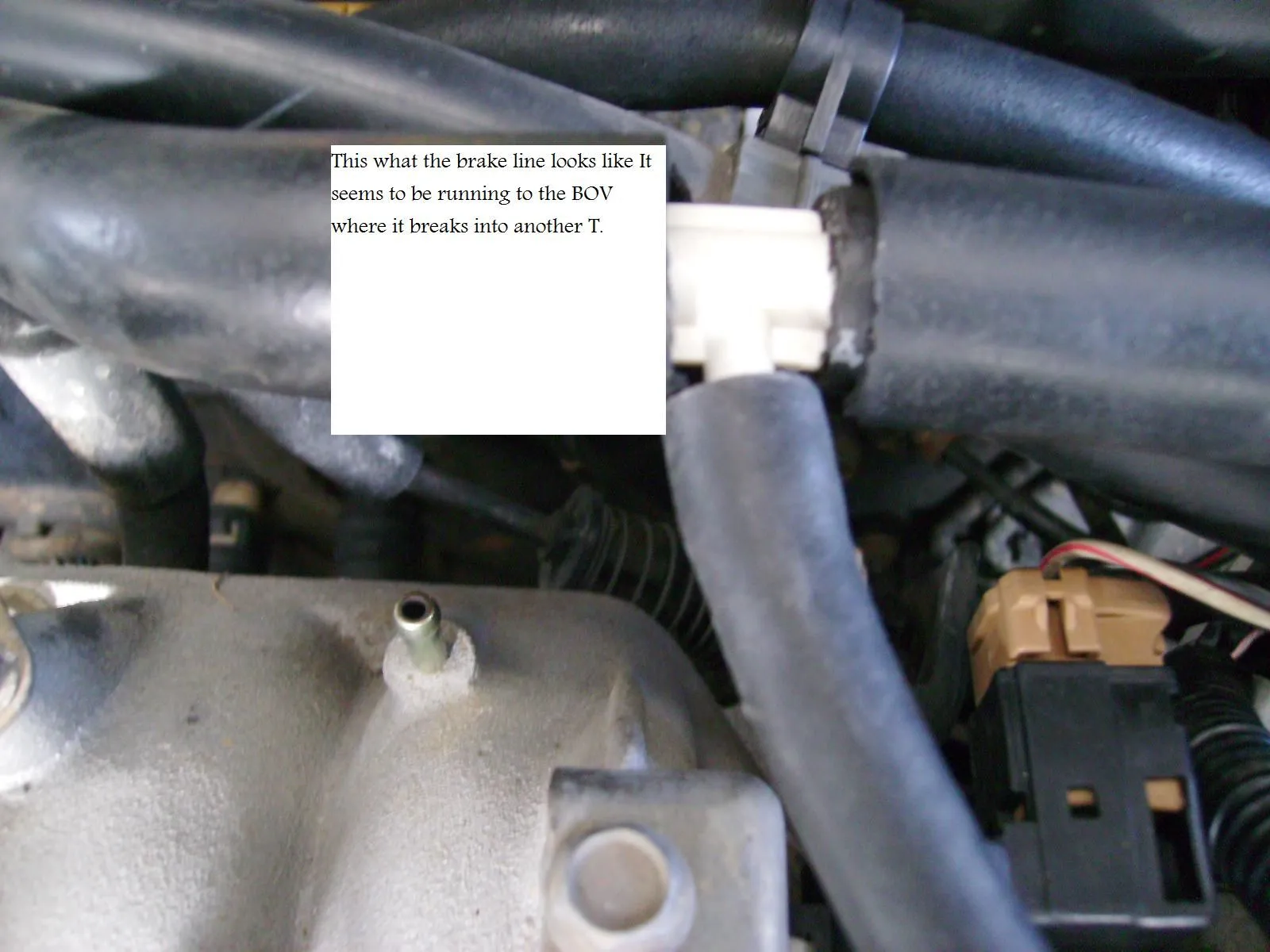

Ok thanks i tell you what ima upload a photo of mine and see if you could see exactly whats disconnected and go from there, ill post pics soon. I feel like an idoit

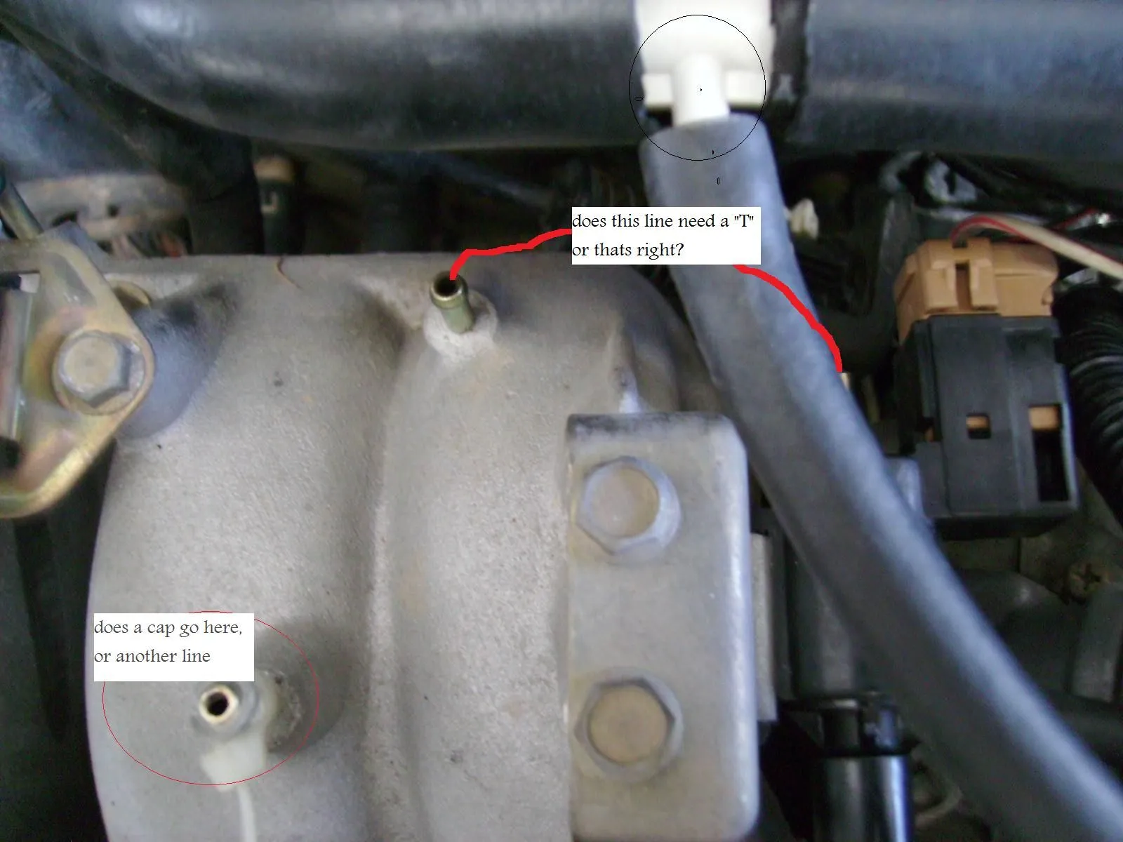

Ok this what Im dealing with as you can see in the pic there is at "T" in the brake line. And i took the other hoses off. I would just do trial and error but rather get it right the first time.

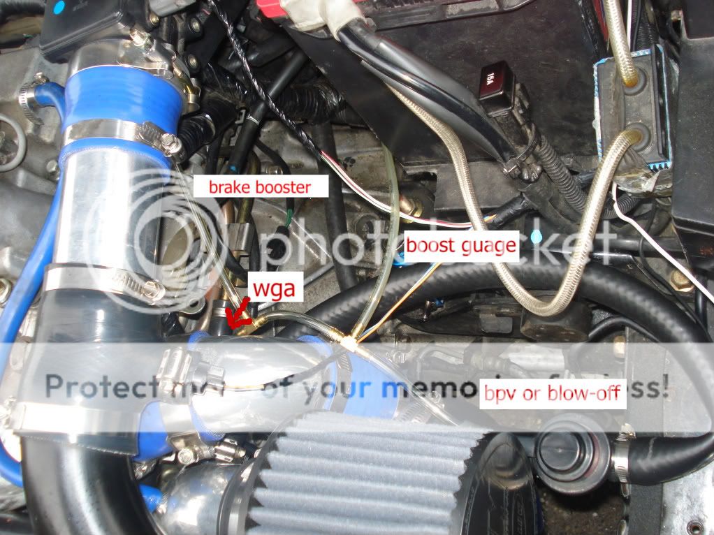

the red line is the brake booster an I have the intake mani fitting just recirculateing itself. but to put it to stock just use the intake mani fitting to supply wga and bpv and put straight fitting on the brake booster line.
Ahhhh I got it!!! ill send pics of the finish product, but does the setup you're using recirculating the intake manifold fitting work fine. What affect does it apply. Thanks again.
Ya it works fine. i do that because i use to use it for the boost guage but it fluterd. the brake booster line much more stable flow. there's to much going on in the mani to get a stable signal but its good for bpv and waste gate.

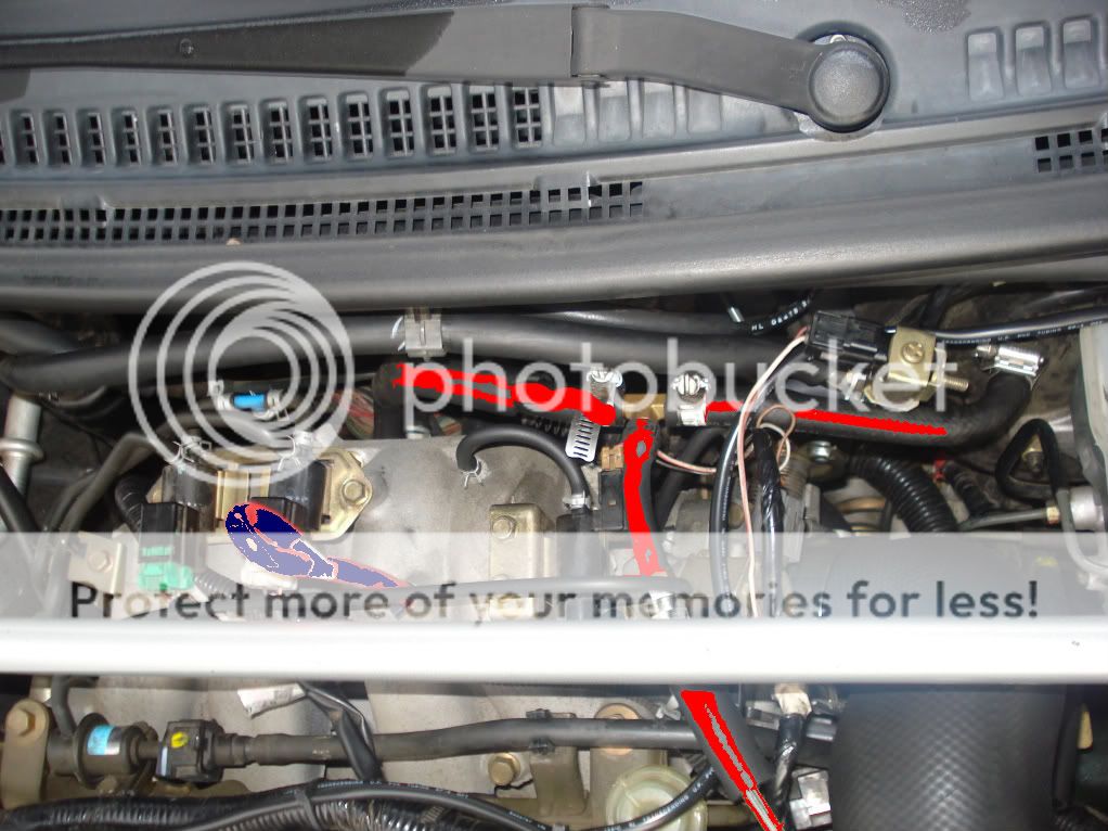

Hey everyone! I know this is a slightly old thread but. . . the picture is purfect for what i need
In the picture above. What are the two vaccum soleniods that are attached to the intake manifold with the gold bracket?
What are their purpose ? AND how are they properly hooked up? Currently mine are totally disconnected from vaccum.

Maybe you have a 626 intake manifold?? they are for valves in the manifold called VICS and VITS
no its the msp manifold i think, either way; i still have those TWO soleniods in that location disconnected. the current bolts for that bracket are being used for direct port nitrous..... from the previos owner, dont ask me lol. I just need to know how to hook them up. A crude vaccum routing would be great. that also shows the input/output of the soleniods.
