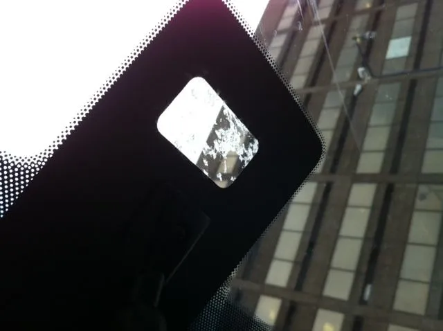

I attached a picture, but basically the entire sensor box is missing and there is just a clear spot on the windshield with some adhesive on it (where I imagine the senor was previously) surrounded by a dark coating that goes up to the top of the windshield.
Thanks for the advice!

Yep, the dealer tech screwed up big time. The sensor fills in the clear rectangle.
At this point, I suppose all you can do is let them try to fix it, and keep after them until the auto wipers work. If they can get some clear adhesive and reattach the sensor, it might be ok.

If you look at jschwa image, you can see adhesive residue.
I just want to ask jschwa to see if the remain adhesive is still sticky or hard.
