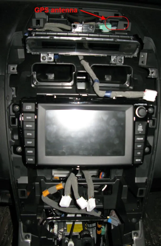

1. Please tell me where you put your gps antena in the car. For those who own an original navigation system, can you post a photo of the location?

1. Unless there is a change between '07 and '08 models' GPS antenna location, it is under the centre panel close to the tweeter. See attached picture of a '07 model.
