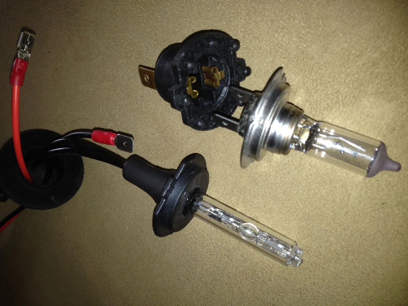

This cars headlights have definately been messed with at some point. The wires have electrical tape on them and bare wire is under the tape I removed. The here is what I'm looking at... Headlight assembly, then the stock bulb, then a plastic adapter, then a plug, black rubber boot seal, etc. when I carefully just stick in the HID, I swear I think it's bottoming out in the reflector cup. Nothing they provided will bring the HID back out of the reflector cup in my lense assembly.i gently just put in the HID, then closed the wire clamp, and it's not gonna work. I took pics, and emailed them to myself, but too many login attempts blocked me. My phone stored the password I guess. I'm just having a very bad week and then this...

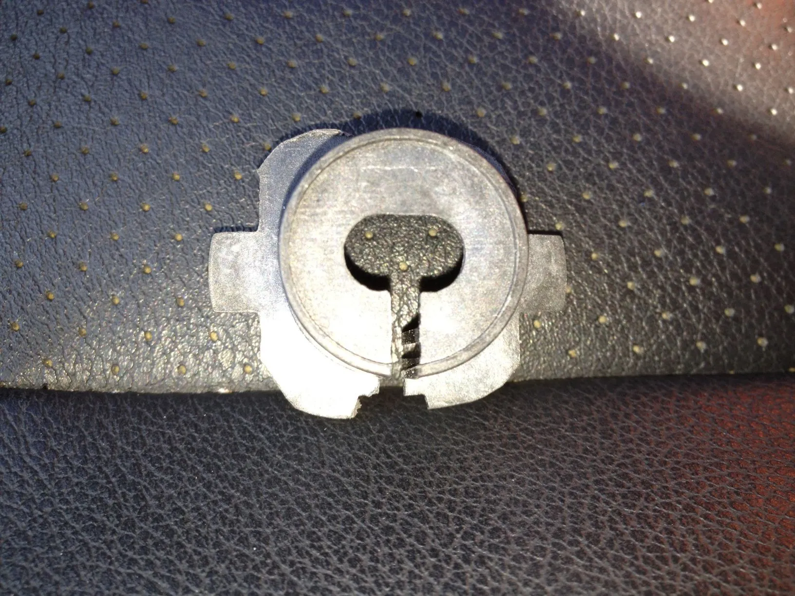

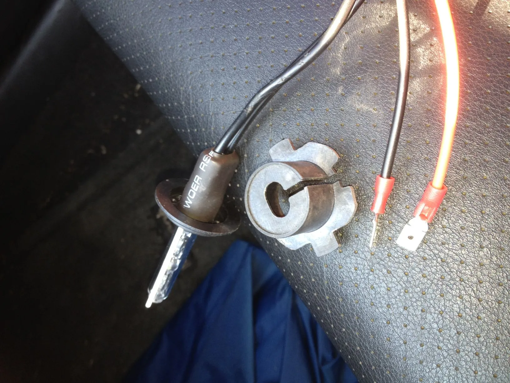

get-attachment.aspx.webpget-attachment.aspx.webpget-attachment.aspx.webpget-attachment.aspx.webpI tried just setting the bulb in there, but that spring retainer clip is designed to have more meat under it, therefor it was not going to stay put. Thats what I was going to do. I ended up just modifying what they sent.

The problem with the adapter that they supplied is that once you slid the wires through, and put the adapter on the back of the plug/wire group that comes out of the plug hits the adapter before the adapter can properly seat against the plug flange. I had to dremel/ clearance the adapter a lot.
