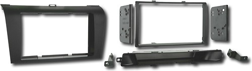

not sure what kit you got, but I got the metra dbl din kit and it included the 2 plastic brackets to do the stock LCD panel. It also included the pocket if I wanted to remove it, but it required no glue or cutting or anything. You got a weird kit.
Where did you get the metra dbl din kit ?
i got it through the stereo shop thats around the corner from the house. But you can get them from best buy, amazon, etc.
In the image below, there are 5 parts.
1. The main bezel
2. 2 side mounts for stereo
3. Pocket if your not going to use the climate display
4. 2 small brackets to connect the climate display and not use the pocket
5. Outside trim piece.
part 4 is what you need. They are the pieces on the bottom of the pic on either side of the pocket.
