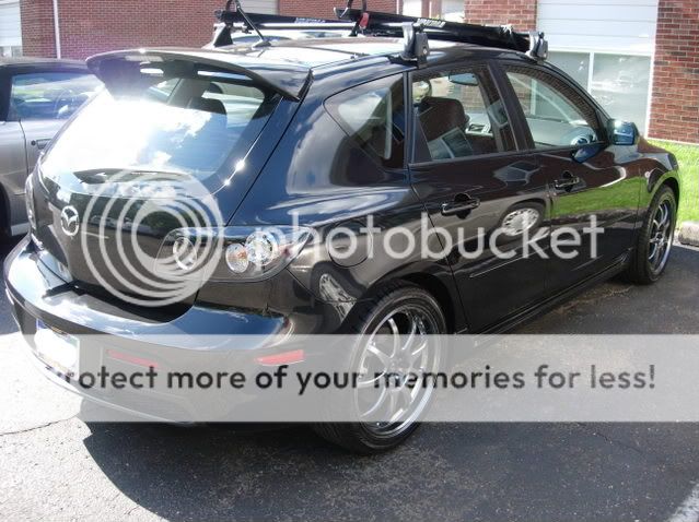

This is what I had....
Tenzo Type-M 18X8 with a 45et.
Now, alot of people are running this wheel (or were running it).
BF Goodrich G-force KDW 2
225-45-18 (same size the OP has purchased)
Many people said that this tire is too tall, and it would not work. In some ways they were right. The worst part about this set up was that it threw my Tachometer and Speedometer off (about 200 RPM and 3-4MPH respectively). I honestly felt that the handeling and over all charicteristics of the car were much better on the stock set up.
So, I took those off, put the stock wheels and tires back on, and I was content again.
