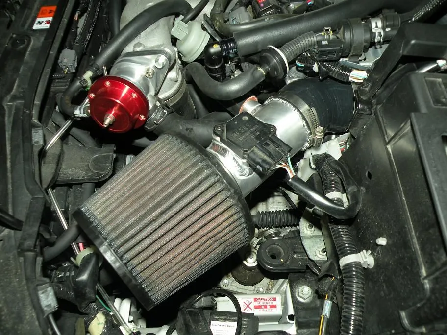

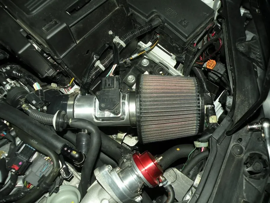

That's probably true but when I had mine on and clamped down, and I pushed on it with my finger, it moved, so I made a bracket...
I know, crappy camera pics but I hope you get the idea. Its bolted to the rubber thingy that the stock airbox snaps into.

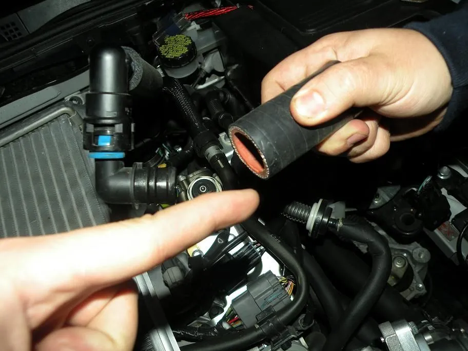

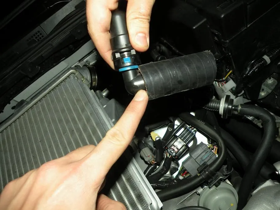

here are some pictures to help with install as well. be sure the vent hose / fitting goes into the smaller hose as pictured. it needs to be pushed all the way in!
Got it installed today. It was really easy.
One mentionable regarding the valve cover vent connection as Ken indicated to shove the silicone hose all the way over it. I actually connected it a little short of all the way on. The base or flange on the fitting of the PVC elbow has a stub that goes into a notch to locate the factory hose position on the OEM accordion elbow. If you put the new hose over this stub up against the flange, you can't get a good seal. Not unless you shove it all the way over the flange and on as far as possible as Ken has shown. I pulled it a bit shy of the stub and cranked the hell out of the worm clamp. It's sealed at this point but I'm sure it works fine either way.
