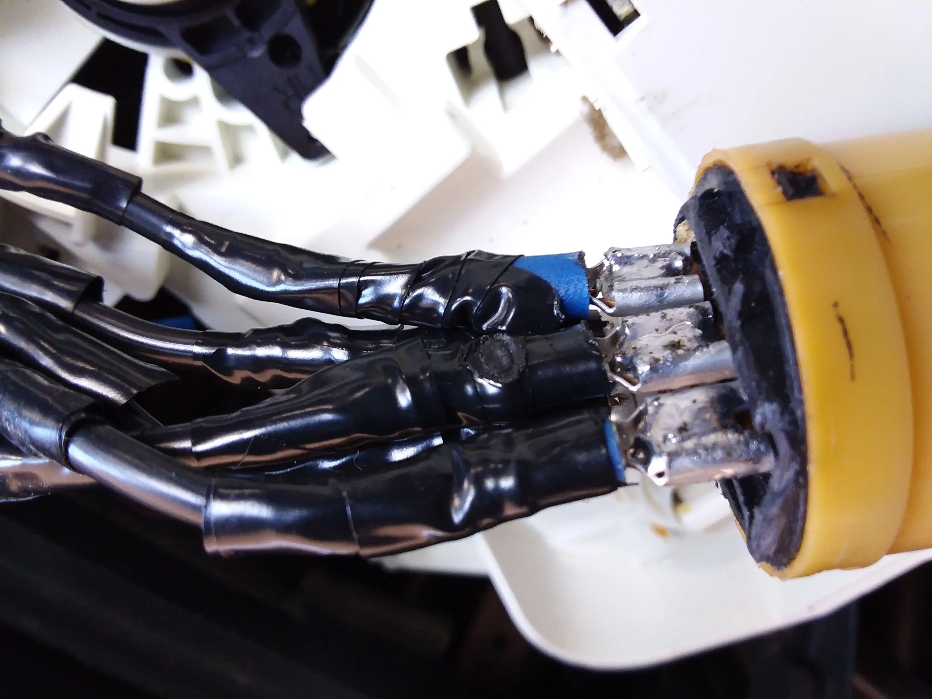

I am going to give this a try this weekend or next week. I tried the trick where you cut the black housing to expose the male contacts on the fan switch and connected/soldered the wires and it didn't change anything :/ (Still issues with fan speed 2 and 3). Living in Florida this AC issue can be a real buzz kill when driving my car.

You could have a bad connection inside the switch itself.
Mine was kinda burnt inside.
I took it apart cleaned it a greased it.

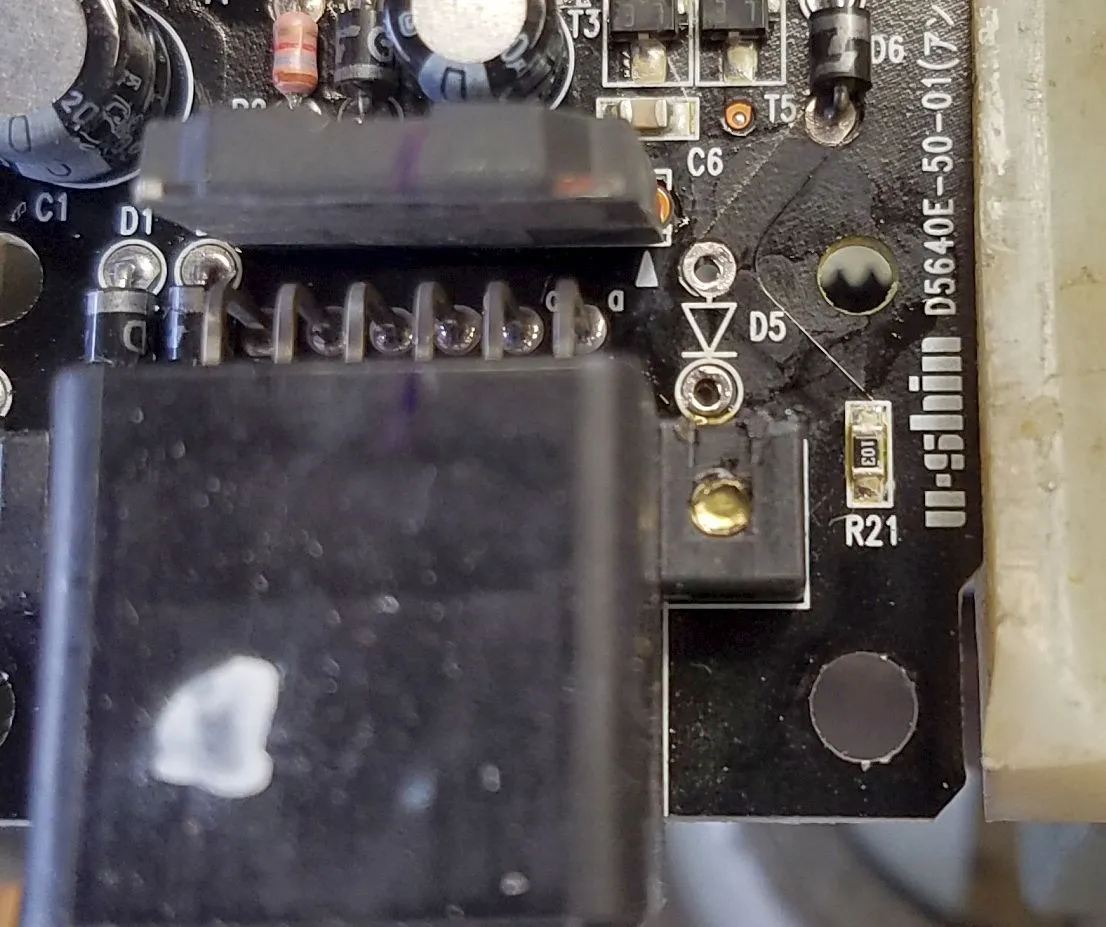

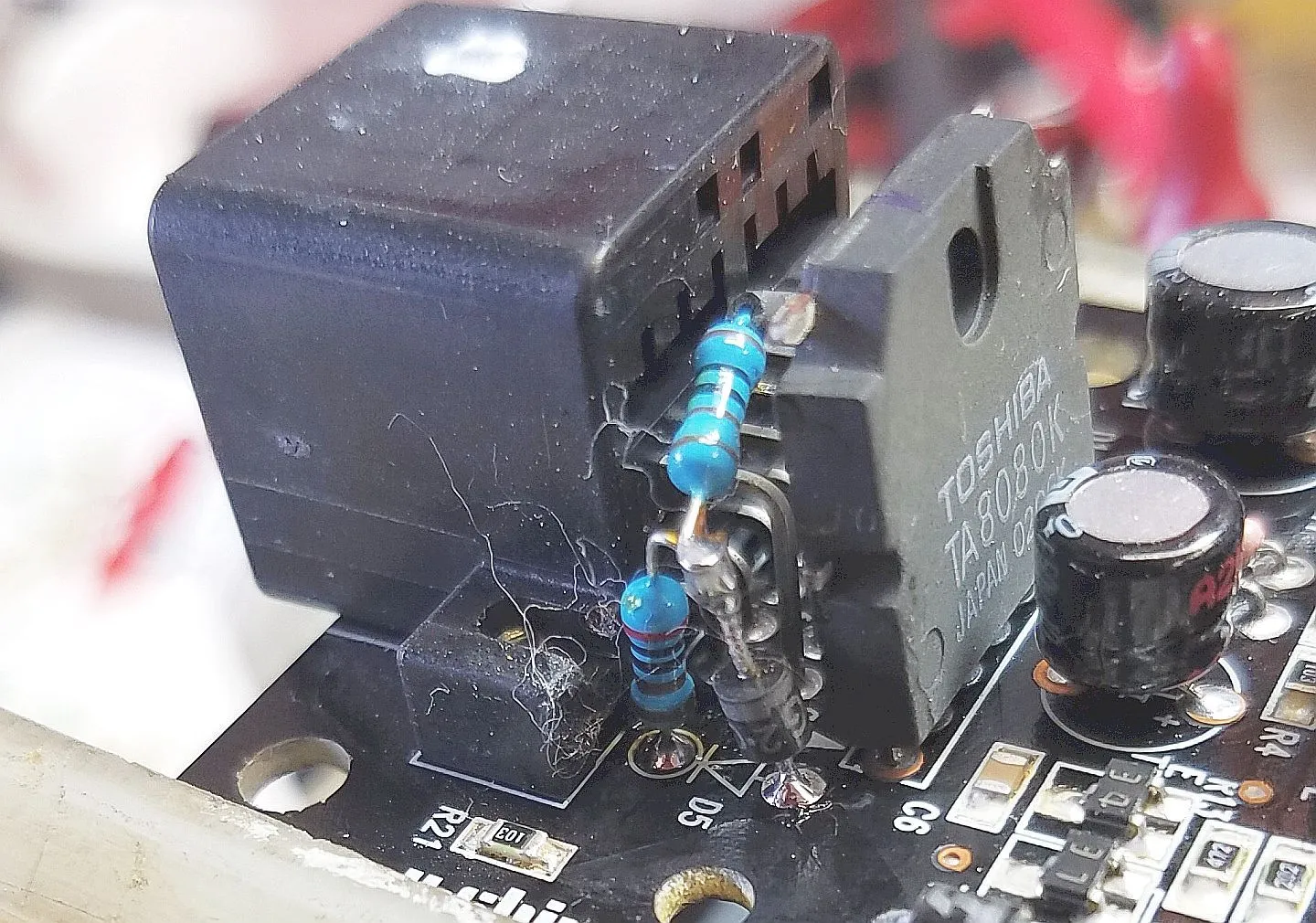

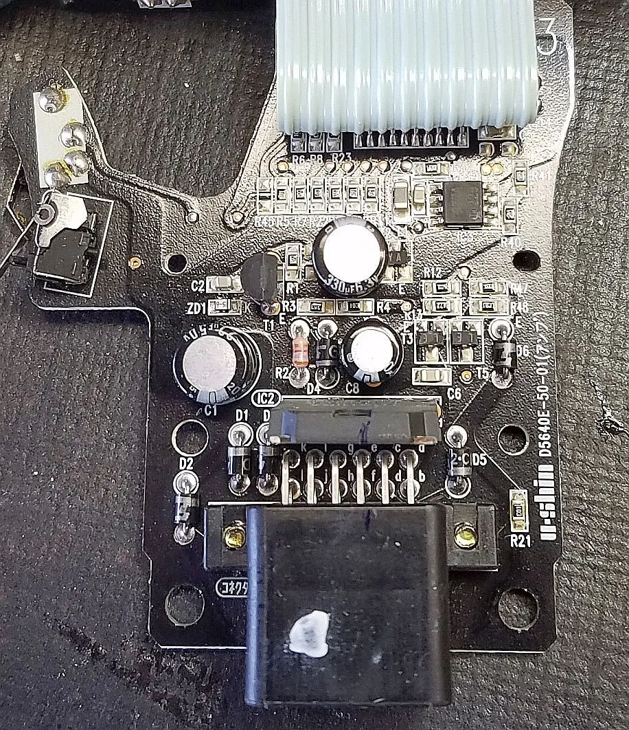

Not to resuscitate a necro thread but I just did this "fix" this last weekend on my GFs P5.
Instead of hacking the wiring I did the mod on the PC board itself.
From the connector the sense signal goes to the cathode of diode D5 and from there to the sensing circuit. Instead of the resistor values stated at the beginning of this thread I increased the resistance to 2 K and 1 K Ohms to reduce current draw. As long as the voltage at the junction of the resistors is between 4 and 6 volts it will work fine. I used 1/4W resistors.
I carefully lifted D5 from the board and placed the 2K 1/4W resistor in series from the PC board to the cathode of D5 and reinstalled with just the anode connected to the board.
Then soldered one end of the 1K resistor to the ground pin [third from right, top row] and the other end to the junction of the 2K resistor and D5.
Also replaced the switch. The old one had a couple Ohms resistance between poles. -should have ZERO resistance.
