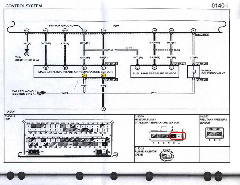

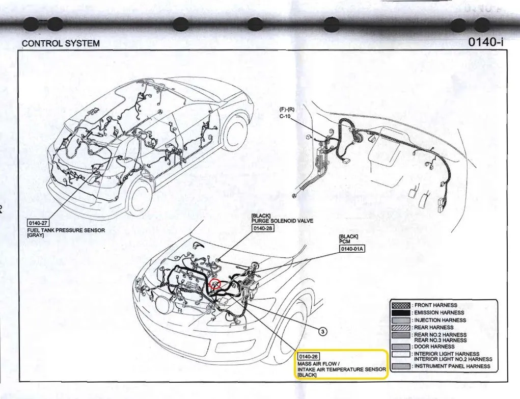

I know about the resistor, but which 2 connections does it go across on the 6 wires on the IAT, I figure that means Inlet Ambient Tempature.
Just Fyi...
IAT = Intake Air Temp (Measured at the Mass Air Flow sensor (MAF) )
AAT= Ambient Ait Temp (Measured from a sensor in your lower front grill)

Hello Tom S,
Did you had the chance to locate the "right" wire on IAT? Let me know how it went. thanks
Tom,
Here's the wiring map as I mentioned in PM to you. Hope this help. I'm going to try it out this evening after work. Let you know the outcome.

I bridged it across the White & Black wires, now its waiting time to see if it works. Took it for a drive, not sure if its me wanting to feel the difference or it seems to be taking in more air by the sound of the engine. Need to take on trip to find out.
Hey Tom,
No probelmo. PM me once you have the "feeling" on the product. I've installed last night and drove this morning. It might be just my imagination of wanting something improvement, but it seems smoother. Time will tell. Have fun with the gadget.
