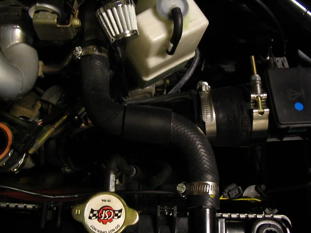

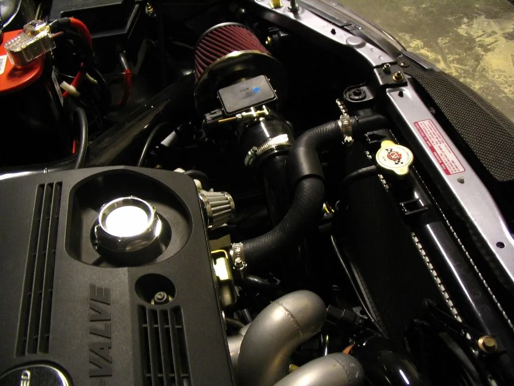

Here is a couple pics of the stock MSP hose and the p5 hose on the car.
The first pic is the stock hose which you can tell is a bit short. Look at where the hose connects to the radiator you can see the gap from the stopper. It also looked the same on the block side. If I pulled it to both stoppers the hose was stretched. I didn't like it.
The second pic is the P5 hose. you can tell it is a bit longer, and fits much better IMO.
Now the MSP hose is probably a hair better but none of us should have any issues with either. I figured for $12 might as well get the correct length hose. The MSP hose would have been fine but it was just my choice.
