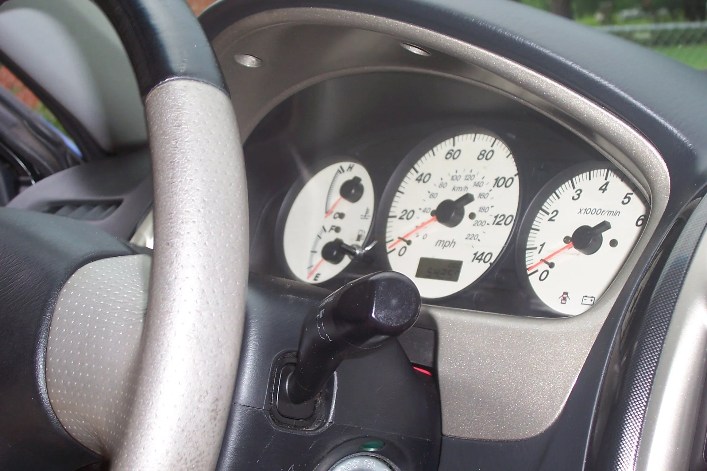

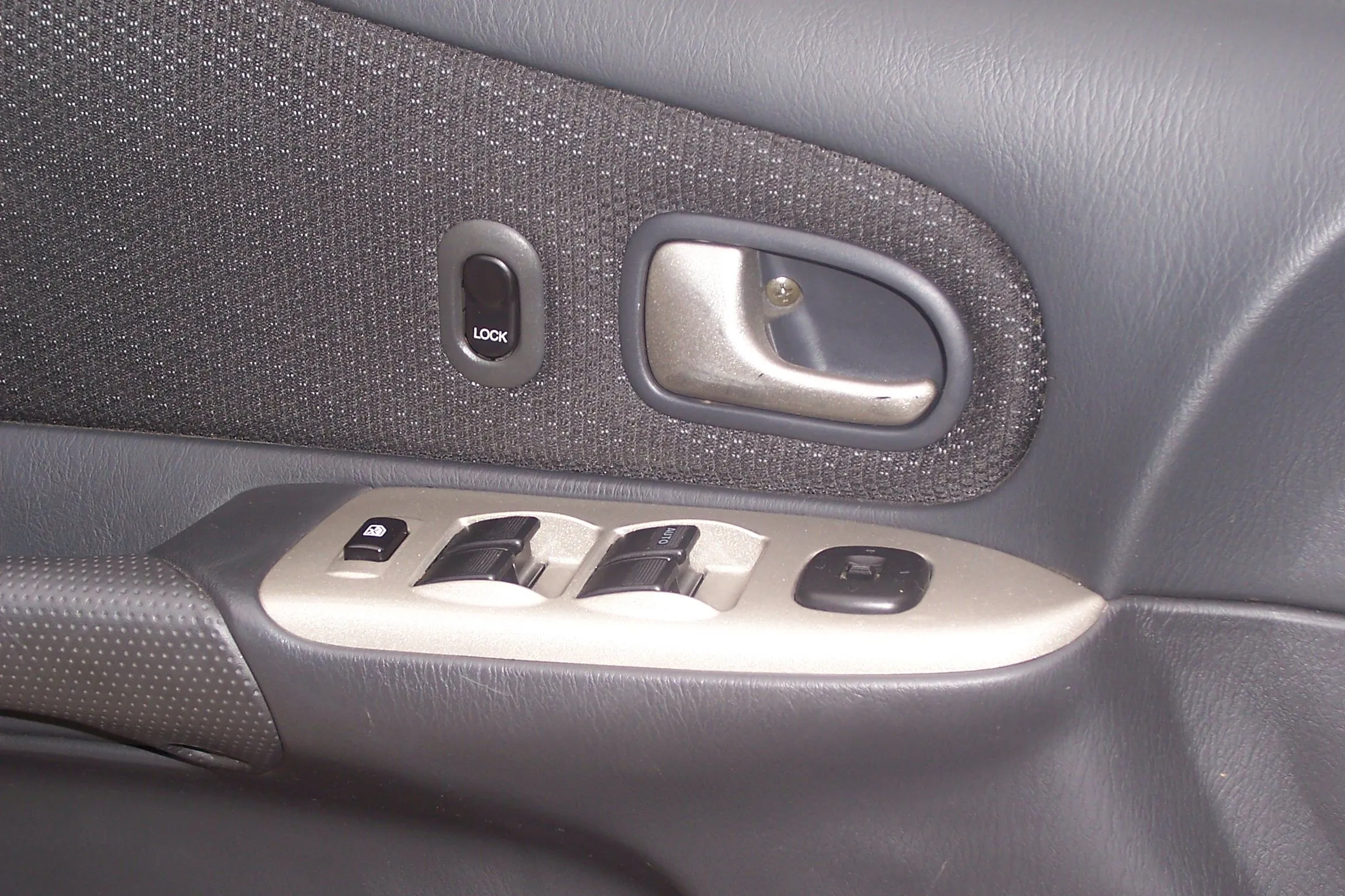

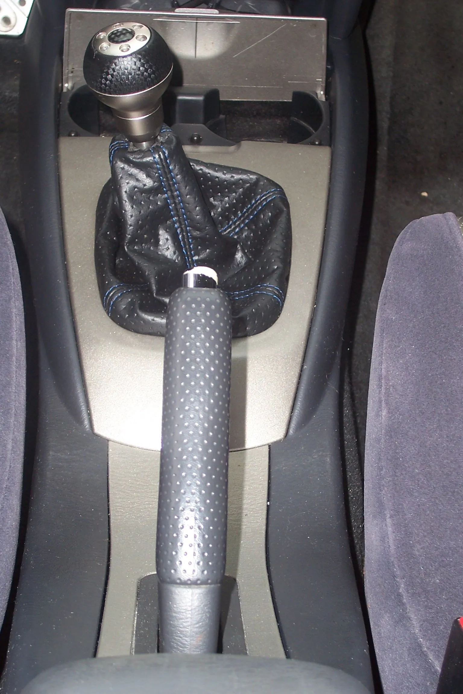

here are a couple of pics of mine. i had the color matched at a car paint store and i painted a few pieces that were not done from the factory. i cleared all of them also.

I painted my ENTIRE interior! Pillars and all. After the painting process is complete, you'll need to clear after, and only after the paint has cured. 2-3 good even coats of clear should be applied. Takes about two days of an even warm and dry temp to do so. Then use a rubbing compound. After that a good waxing. As for paint, use the factory paint that you can request from the dealer in an aerosol can. Also, any of the "import" colors are pretty damn close.
