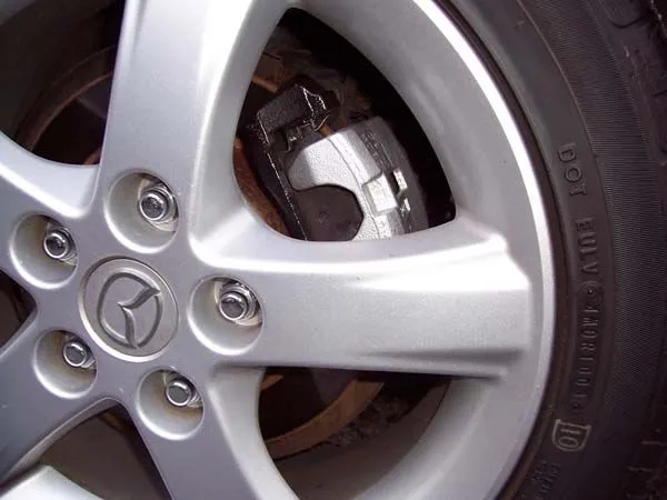

i like that colour. what kind of silver is it and how long did it take to finish?
the color is just Dupli-Color brand silver caliper pant (black was same brand). i bought a spray can but sprayed it in the lid and used a foam brush and some small kids art brushes to apply.
the prep work is the biggest pain in the ass (not to mention i started in the middle of this crappy heat wave we are having in N.E.) to do all 4 i think it took 3 1/2 to 4 hours. with 85% being prep work. the other thing i bought, which i will swear by is a wire brush attachment for my cordless drill. if you have a lot of build up it will be impossible to remove without some powered device.
