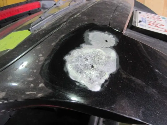

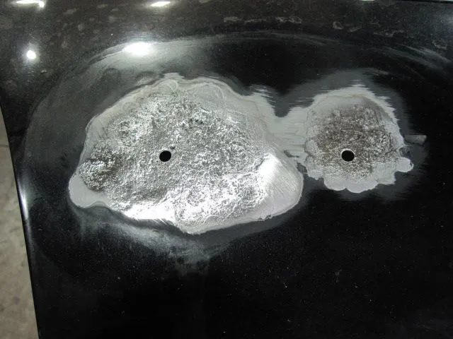

(attn)(attn)Hey see pics for hard work(boom08)(attn)(attn)(attn)
