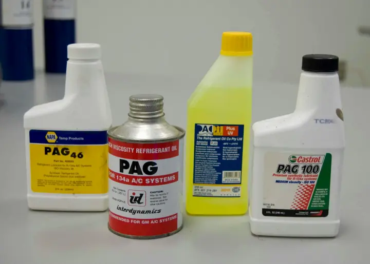

I have a busted condenser from an accident so i'm replacing the condenser, drier, serpentine belt, and ac compressor while I'm at it. i cannot for the life of me figure out which type of PAG oil the p5 2003 takes in the compressor. I'm seeing listings for the compressor with PAG 46 and then another listing with the same compressor but this one is listed as containing PAG 100, and i'm also seeing posts from people on different forums either saying 46 or 100, there's no uniform answer i can find.
has anyone that's done an a/c compressor replacement for a p5 03 know which PAG oil to use???? i'm losing my mind, thank you.

The FSM calls for Atmos GU10. While there's not much about it online (like where to buy. Online "compatibility" charts say PAG46. As you've seen yourself, other online commentors have used PAG100 with success.
This link is from Sanden (the maker of AC compressors). It opens a PDF that shows a viscosity chart. You can find the Atmos GU10 listed under the OEM column and Pag 46 as the equivalent.

thanks for chiming in man. I ended up finding the service manual and the recommended oil was indeed PAG46 so im just going with that. I've decided to not go through with the compressor swap and instead only do the condensor/drier (the only damaged parts). I previously thought it would make more sense to do the compressor also all together since the car has some years on it, but im just not gonna touch it till it actually has issues.(theres a bit of a pop/bump from it when i turn on the AC but the AC seems to be working fine, just gonna change the belt) The replacement compressor I ordered was chinese made off amazon and the pulley gets caught and skips a bit when i spin it by hand....probably not the best idea to put that into my car, just gonna return it. Unless of course you have difference advice
