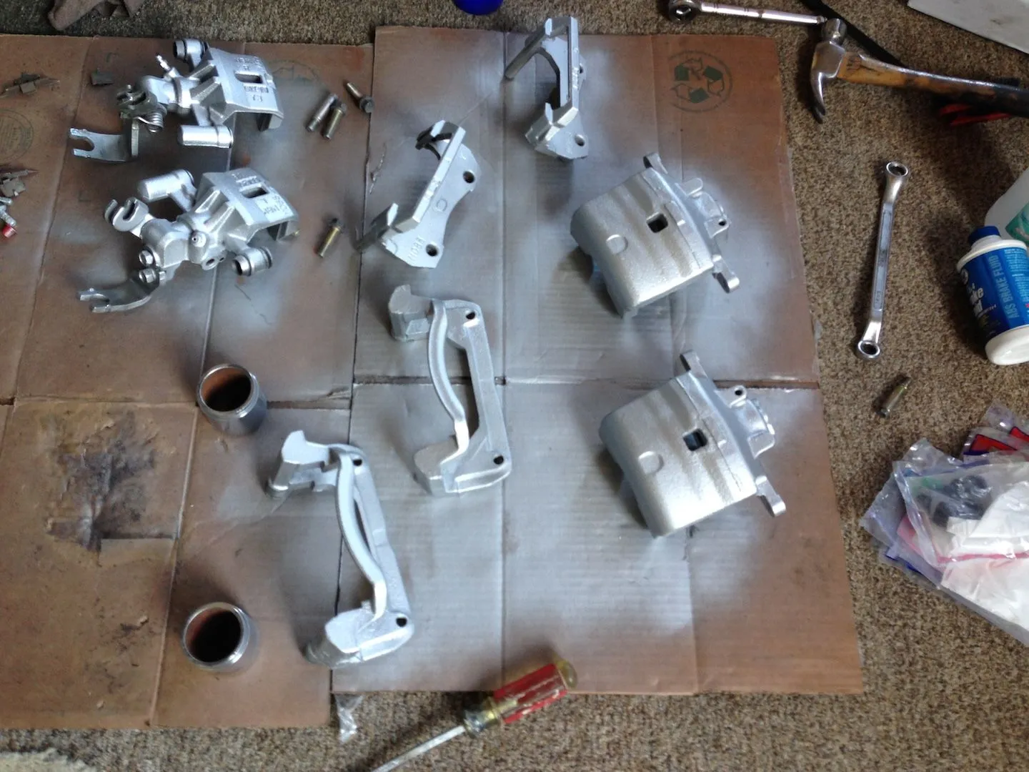

Cleaning Calipers and rebuilding with a silver paint finish

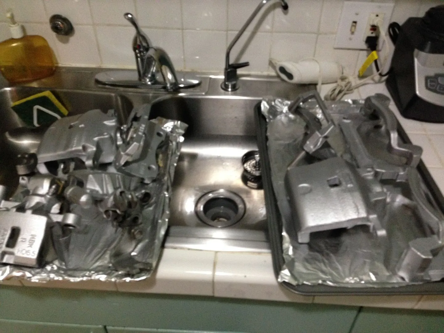

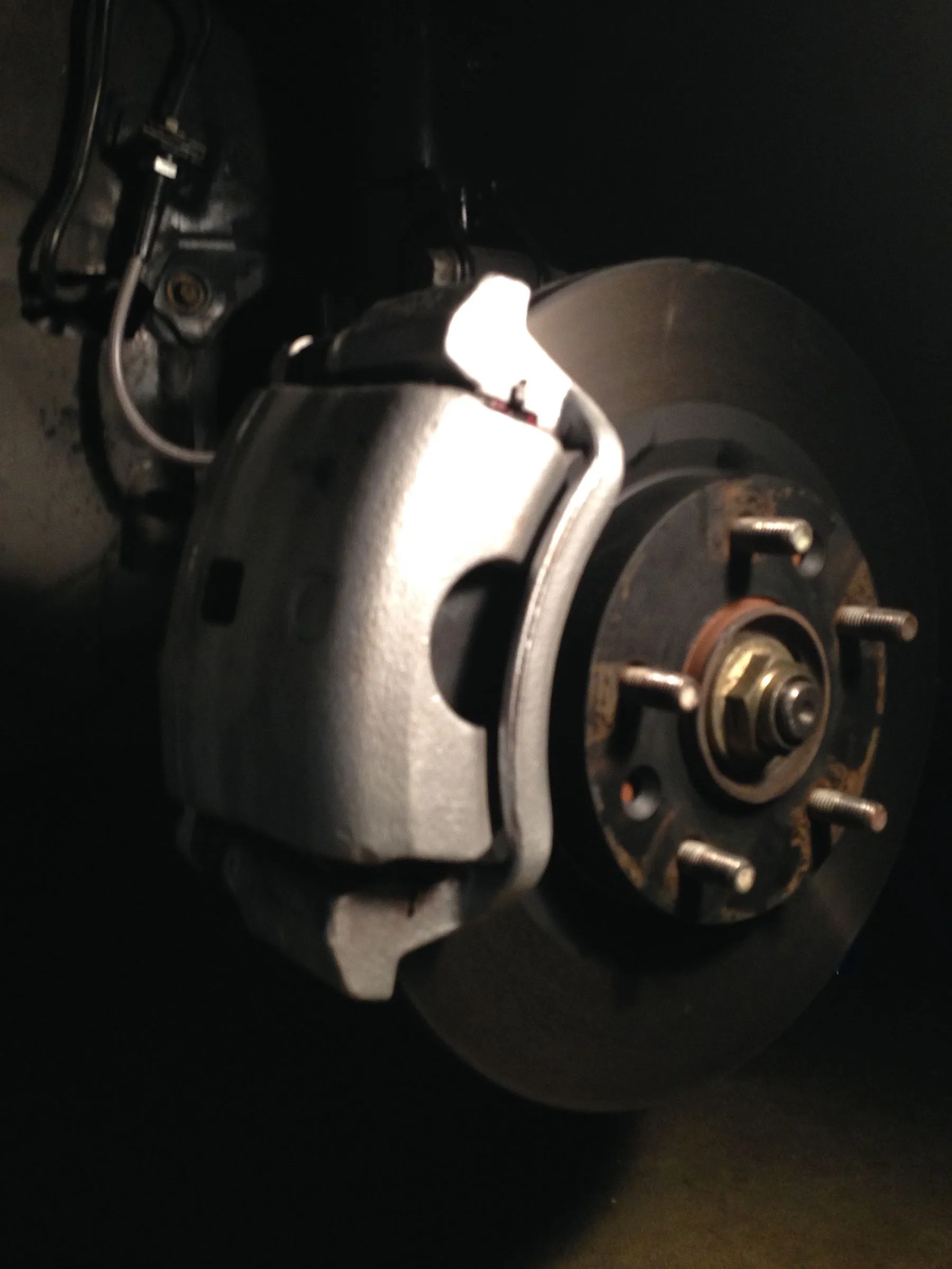

Calipers are painted and Baked (cured)
I used a 900 degree Silver Paint. You have to bake the paint to a cure for 1 hour at 250 degrees in the oven.IMG_0336.webpIMG_0337.webpIMG_0336.webpIMG_0337.webp

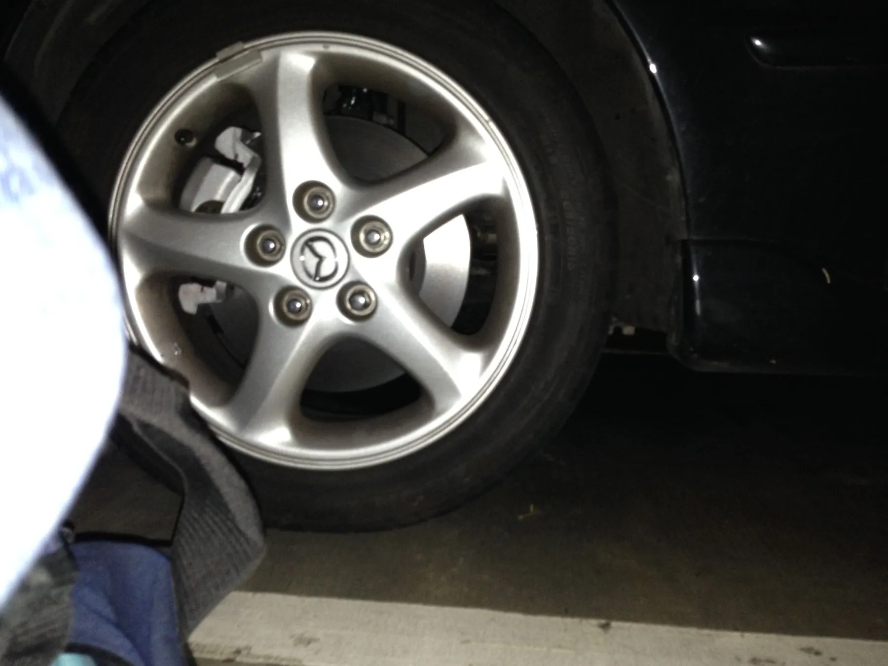

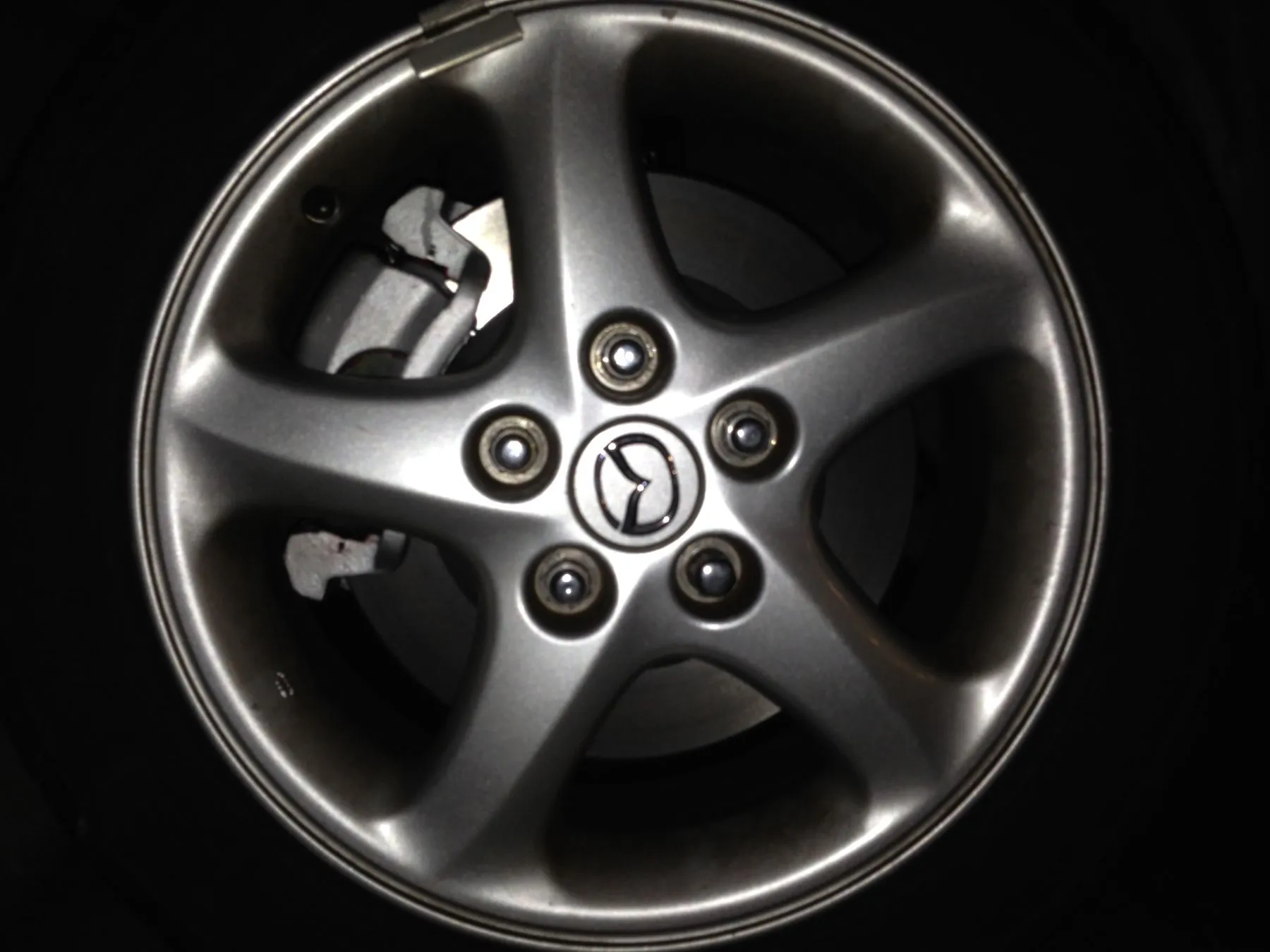

Stock P5 16 rims with Brake Mod - more pics to come
Here are a few pics to confirm stock P5 rims work with the BBK Mod.

I will remove the wheels this weekend when I do the rears and take pics with the Braided lines.

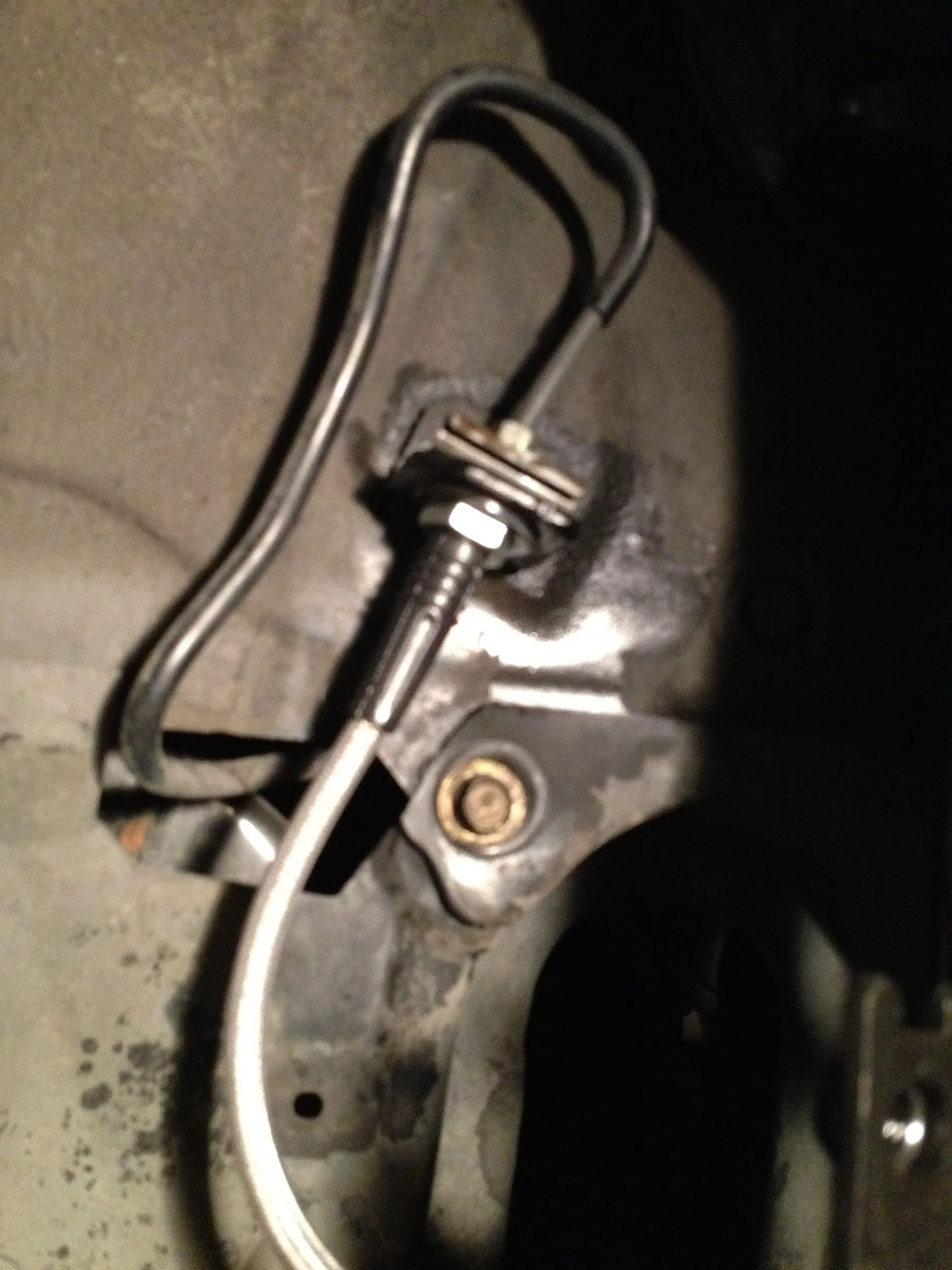

Issue: Installing the braided lines, you have to make sure you line up the keyed end into the mount for the retainer clip so it is secured fully.
The clutch is definitely more responsive with the braided line installed.

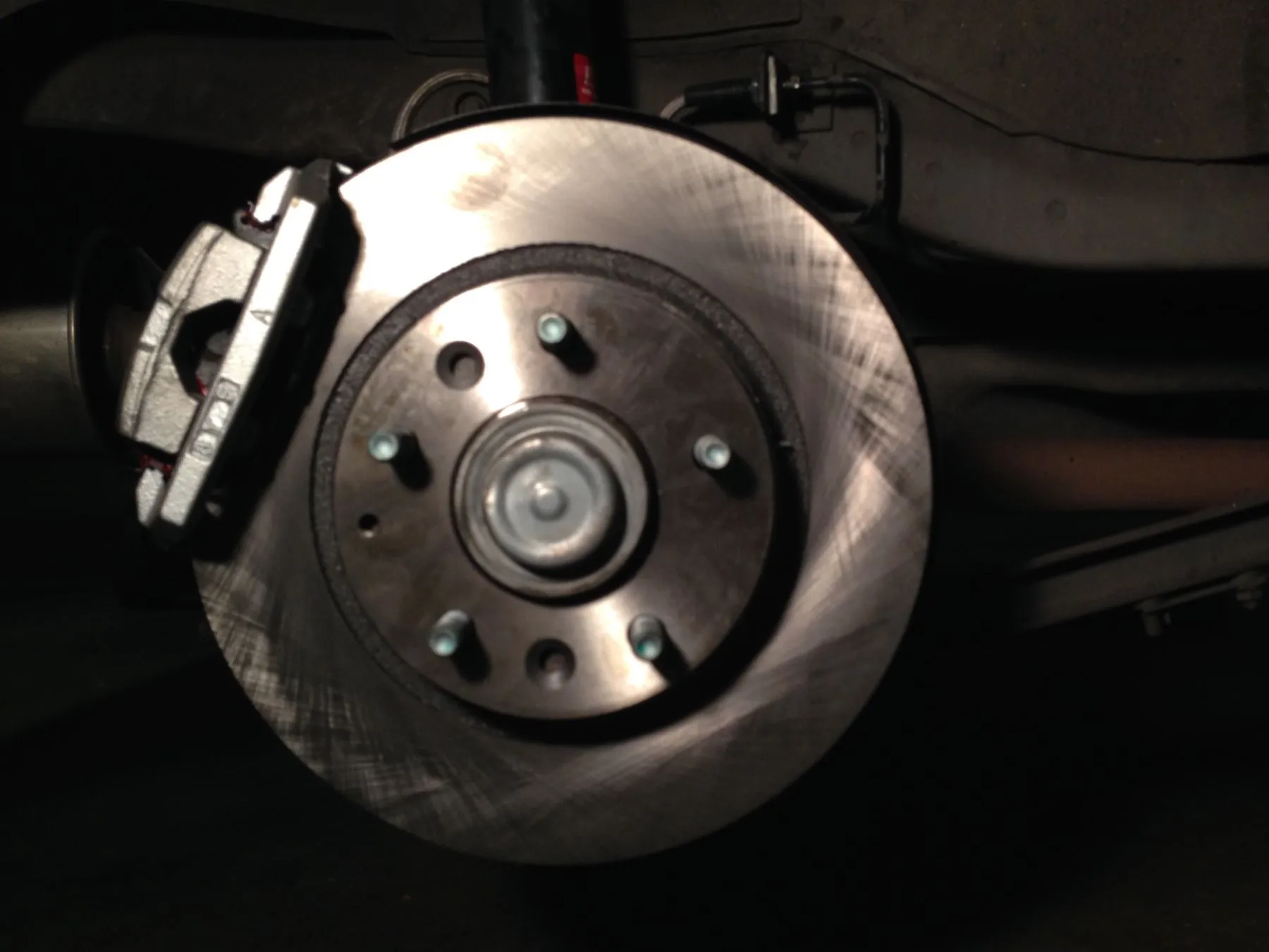

Rear brakes installed. Adjusted and job Complete!
Was it worth it?
Braking is definitely better. Cost almost $600: Rotors, calipers and brackets, brake pads, caliper rebuild kits, fluids.
Since my brake hoses were all original, I popped my original clutch line last year, I knew it was time for them to go. Braided lines are worth it.
I do find it weird that the brake pads don't cover the rotor fully. My neighbor has a 2007 Mazda 6 and I confirmed that is how it is on his as well.
