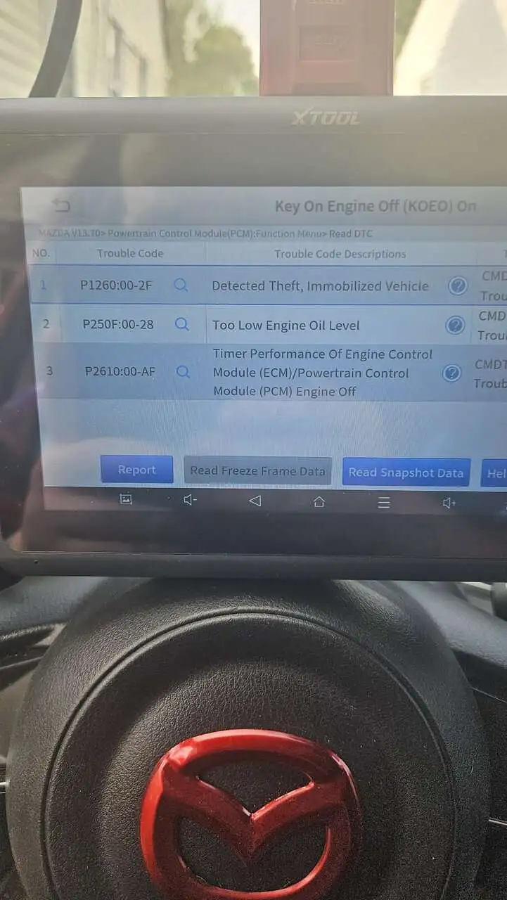

2019 CX5 with 46k miles on it. During a radio replacement, engine light comes on and keyfob no longer operates the car. I cannot lock or unlock the doors with the fob or keyless entry. The radio doesn't power on, and automatic windows don't function. Door lock and unlock does not work. And the engine will only start when the keys are pushed onto the start button. I have a reader telling me
P2610 Timer performance of engine control
P1260 Detected Theft, immobilized vehicle
Both keys I have had worked for the last year of ownership without issues. I'm not sure how to reset the PATS system, however that's the best guess as to what's causing this issue.

I've added oil, I'll do an oil change tomorrow. I also put a new battery in the car as well. I still don't have the keyfob abilities or radio power or windows roll down.
