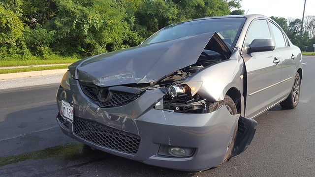

Well the good news is I don't have to worry about the code anymore.
Bad news is that it is probably totaled...
Someone did an illegal u-turn directly into the path of the car. No one hurt.
