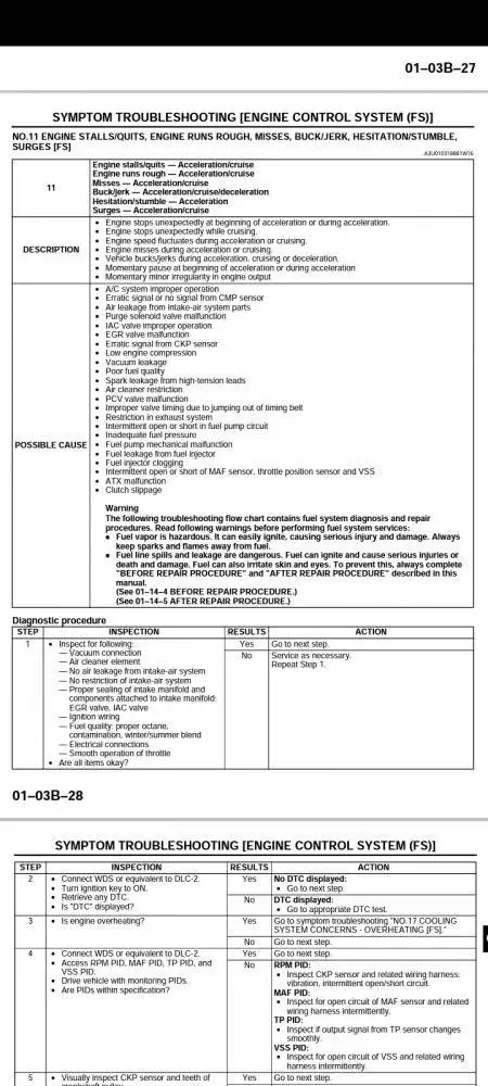

Inadequate fuel pressure could possibly throw a PRC code.

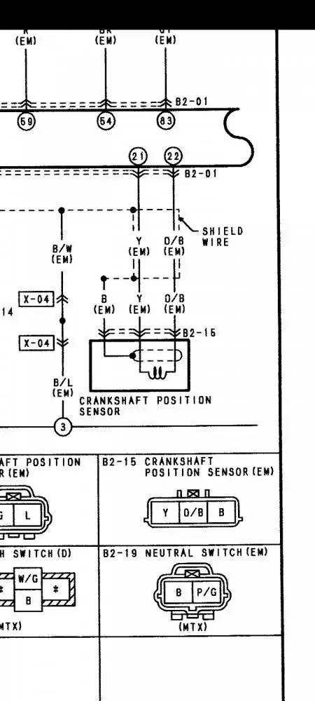

Inspect your crank sensor wires.
Some guys had their wires rubbing on the engine somewhere and it wore through the insulation and was shorting out.
The ECU shuts down the engine the instant that it doesn't receive crank info.
Check your crank sensor for contamination and the gap and make sure that your toothed sprocket is still connected to the crank pulley.
They have been know to slip and break free.
Check your cam sensor wires too, but the engine will run with bad or no cam sensor information and you'll get a code.

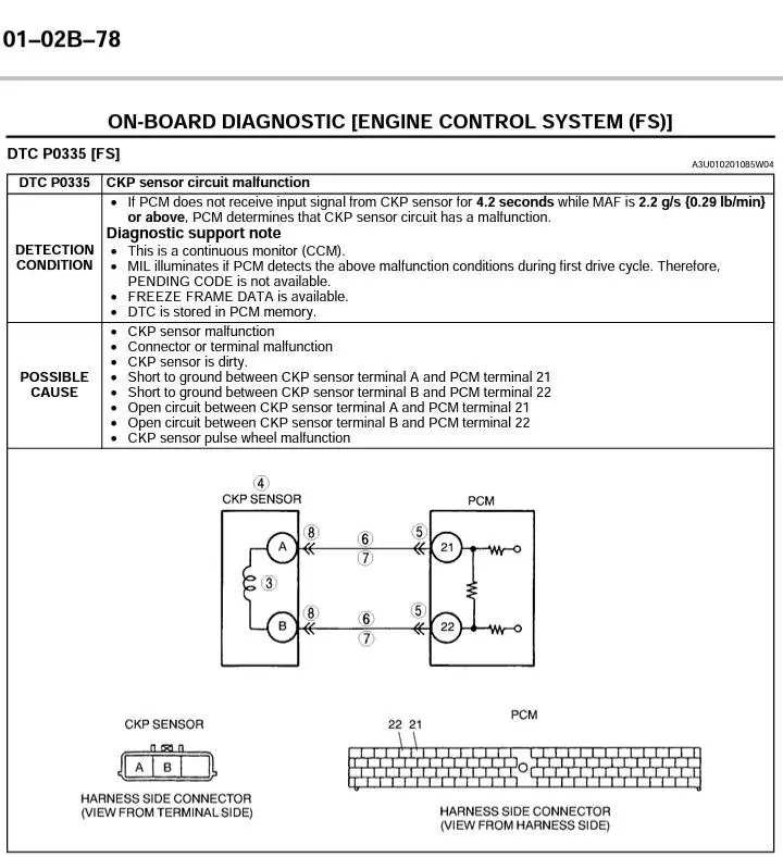

There is a code for the crank sensor but I don't know of anyone that has popped that code even when they had crank sensor issues.
It looks like the ECU shuts down the engine so fast, that it doesn't have time to register that code.
You may have disturbed the crank sensor wire when you replaced your PRC solenoid, causing your issues.
What a useless code...
You will pop this code if your ECU doesn't receive data for 4.2 seconds, but the ECU shuts down the engine in a millisecond if it doesn't receive crank sensor data, so you will never pop this code. Lol

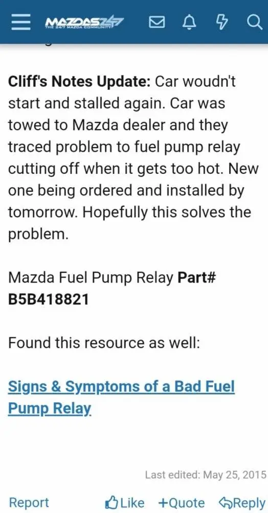

Another thing to check is under the hood in the fuse box. The fuel pump relay. Ive seen some that have started to arc and short out.

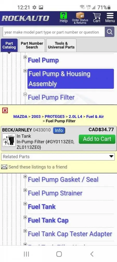

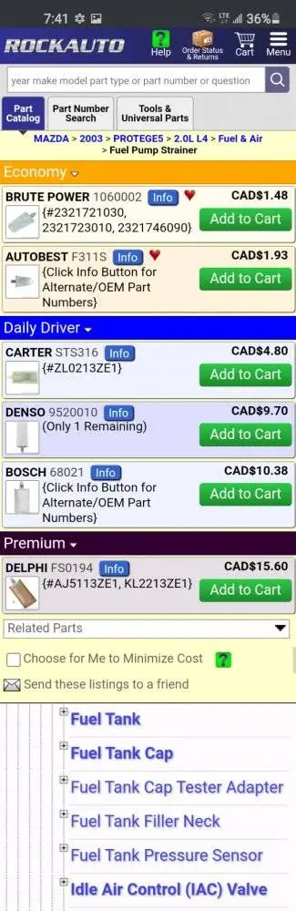

It's not too much money...
Here's what you need...
And this...

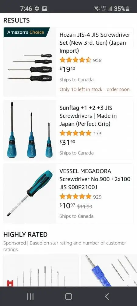

A JIS screwdriver.
Thread 'PSA: Know your screws! JIS vs Phillips (IAC valve, etc...)' PSA: Know your screws! JIS vs Phillips (IAC valve, etc...)

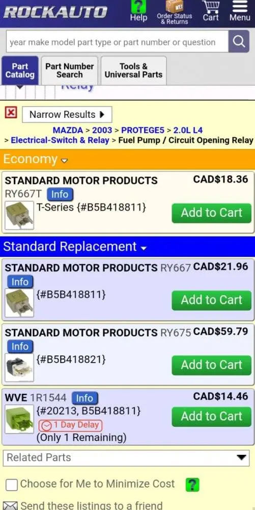

Thread 'P5 Won't Start & Rough Idle' P5 Won't Start & Rough Idle
I like rockauto.com
Their stuff always fits and works.
Amazon and eBay can be sketchy.
Remember too that I live in Canada.
You guys would pay about ten bucks for everything. Lol

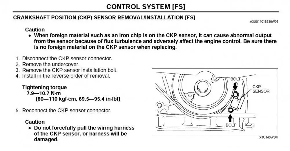

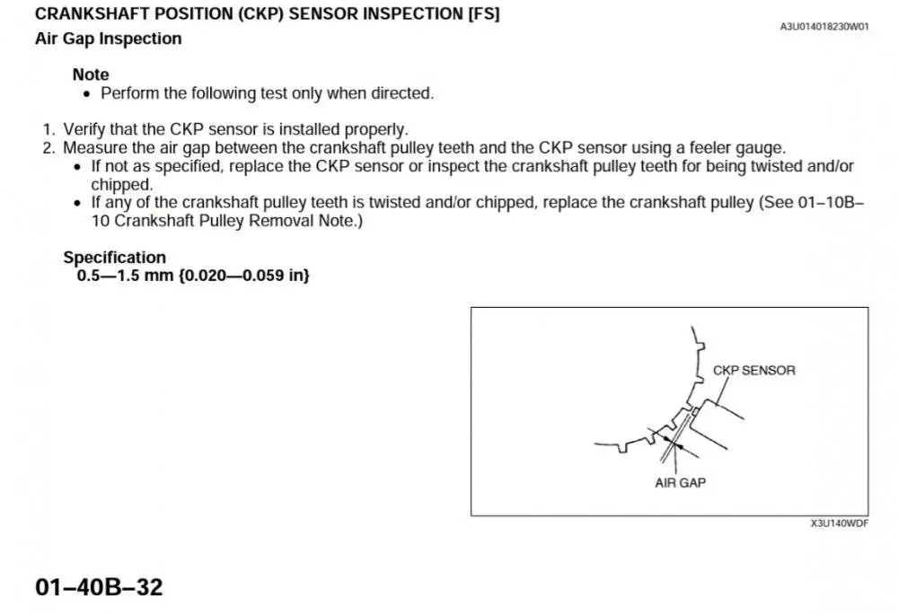

Take a good look at your crank sensor wires..
Maybe even remove it to check it.
The top had some exposed material, looks like the insulation just gave up due to heat/age on the top, haven't got a look at the bottom. Going to be ordering a new one and I'll see if that fixes anything, for now, electrical tape.
Cool!
You may very well have found the problem.
Keep in mind that the wires have have metal shielding around them (like cable TV wire) and you don't want the shielding to be touching the wires inside if the insulation is worn through to the wires inside.
Pcb is awesome!! Def the guy with links and pics! You can try to tape up the crank sensor wiring sheathing and see if that fixes it as long as the wires inside arent damaged. Also check the relay. Open the lid and it will show you which relay is which. If its burnt looking, corrosion on the plugs, or even the surrounding plastic looks melted that might be the issue. At the very least you can glob some dielectric grease on it and plug it back in if it looks ok.

Did you inspect your toothed ring and check the air gap ?
