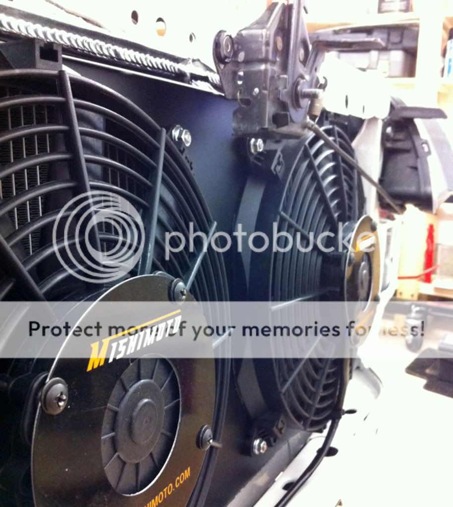

OP, I know this may sound stupid, but make sure you've got your condensor fan wired correctly and it's not pushing air from the engine bay into the condensor because you would run into two problems- 1. It's hot air and 2. It would have a hell of a time trying to push that air while driving.

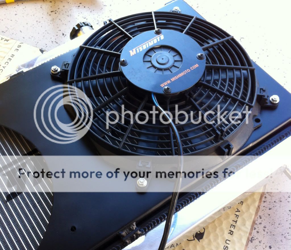

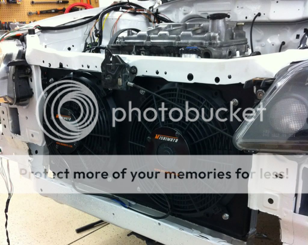

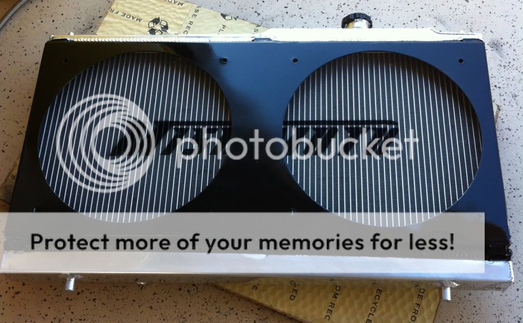

The Fans are probably hooked up poorly, as in the way that they are attached is probably missing good seal..
It isn't like a fan that blows cool air on you... that it can just blow air on you.. the Radiator needs AIR FLOW (Through the Rad not on it)
NOTE: Just attaching them to the front of the AC Condenser will NOT make good airflow to the rad. People who try to run a pusher system like me, without removing the AC have to understand that the air will flow well past the condencer, but then do nothing to cool the engine. There is 1" of space where the air will simply blow around the radiator.
Mazda uses Puller Fans on the back of the rad..
BikingPro there, has them zap strapped over the oil cooler, AC etc.. His car will not cool itself no matter how fast he runs the fans... It will overheat stuck in traffic.
Yup. Im thinking fans now too. Today is was about 90 out and after a lot of driving my car iverheated. This time without the ac on. The temp needle would go back down once i started moving again too. My fans arr pretty tight against the radiator with zip ties but they are obviousy not covering the entire radiator. Who makes custom shrouds for the regular protege stock radiator?
