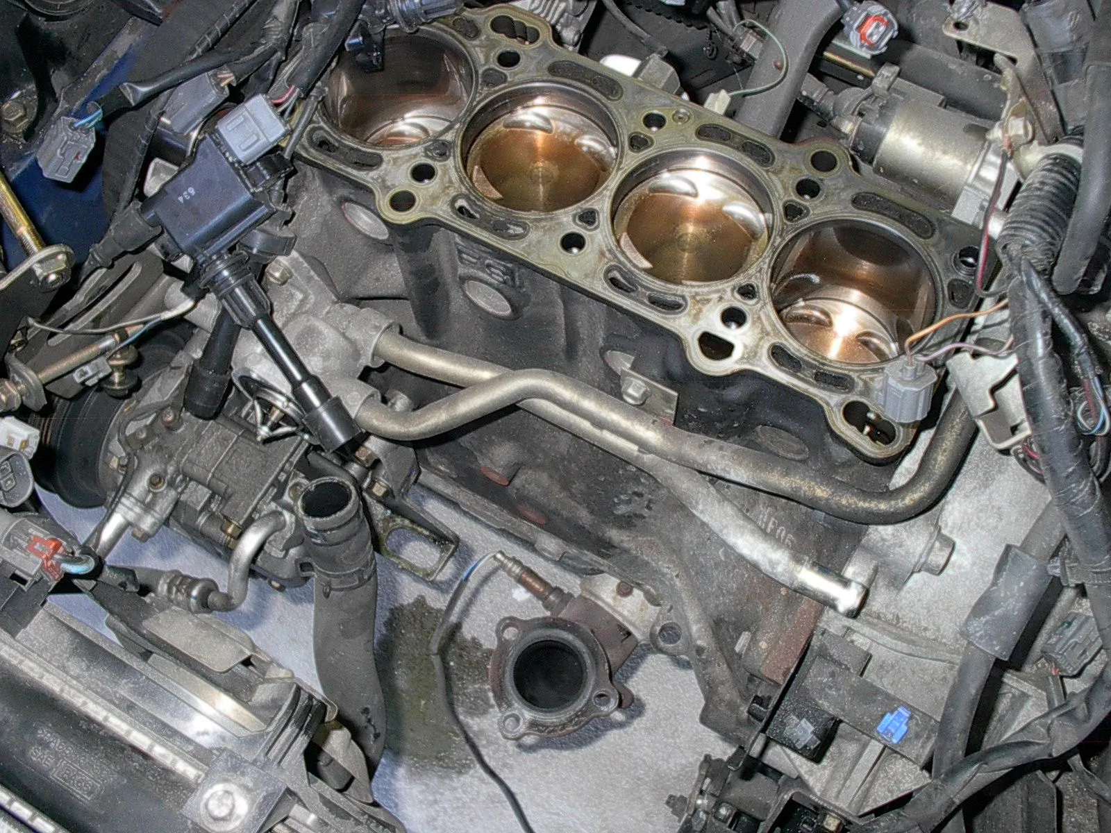

check compression. I bought my car with a blown engine. it was overheated. It bent all the exhaust valves. 0 compression
yup indeedy - blown headgasket.
Compression
100 55 55 75
Across the block. Head contracts and bends up in the middle and the gasket blows. Hopefully nothing else. The valvetrain looks intact from up top.
But the head has to come off - I will get it to a machine shop to see how badly it warped and if it can be surfaced.
Go from there. Could end up buying a whole used engine or something.
