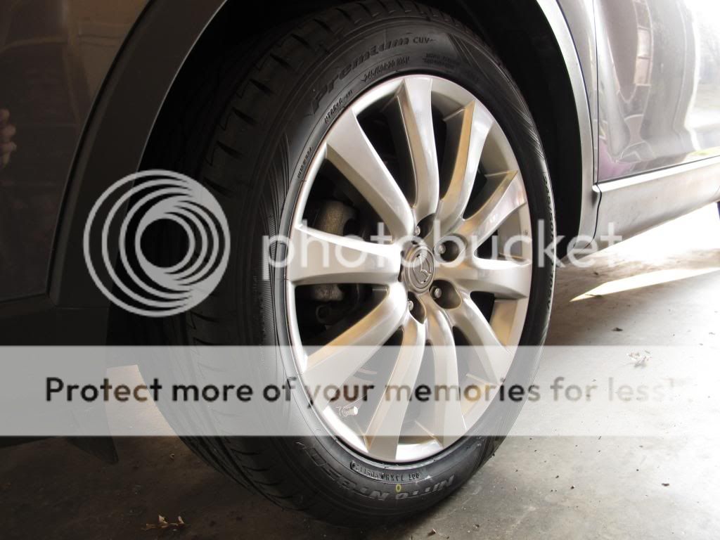

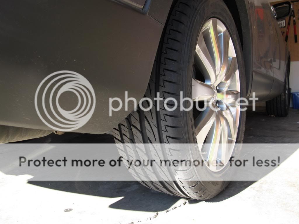

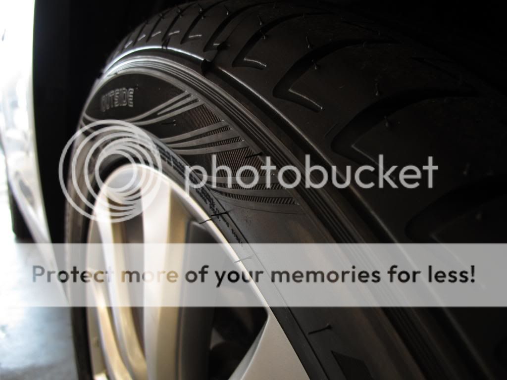

Ordered me some TIRES!!
I ordered 4 tpms OEM Mazda sensors on ebay for 120 dollars shipped! This is dirt cheap.
https://www.ebay.com (commissions earned)
Then ordered my tires from Tirebuyer.
It was fate. I pulled out of my house this morning and less than a mile later a big truck blasted past me with a big "TIREBUYER" sign on the back (American Tire Distributors truck)
My local trusted tire shop wanted over 200 dollars more, and although the install is free to go through the local shop, it still is a huge price difference.
By ordering over-the-phone they gave me 20.00 off.
679.60 Shipped to my house. Nitto NT850 Plus CUV 245/50/20. This is pretty much the best price you are going to find for tires for our car, other than Eagle RSA.
Good price with shipping. I'm SO glad I don't have to buy a $et of $now tire$ too.
