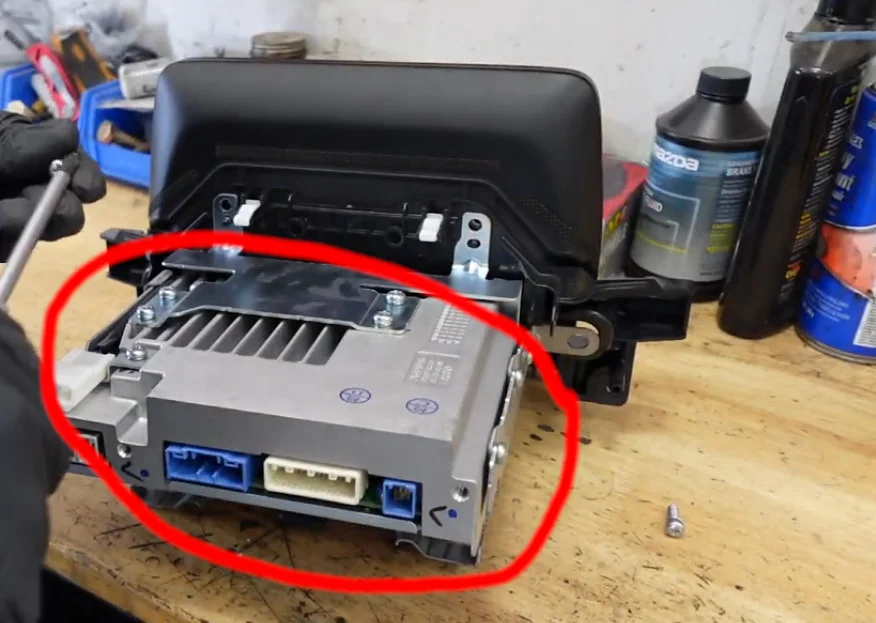

Update: It's fixed!
I ended up buying a used master control unit off ebay and that did it. Screen working, backup camera working, etc. As noted, my car is a 2017. The MCU I bought is technically a 2018, but works fine in my car.
