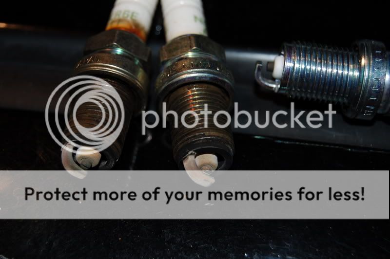

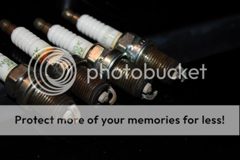

Code PR0300, random misfire. Felt like the car dropped a cylinder or two.
I pulled the plugs and this is what I found:
Could this be the culprit?

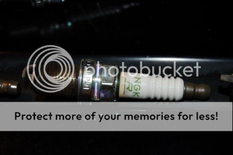

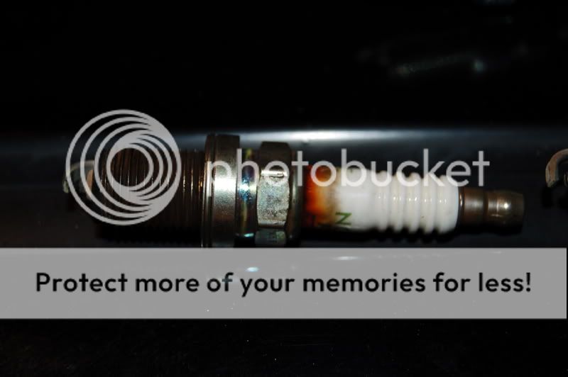

Unfortunately I did not pay attention to what order they were in when I pulled them out since I was just looking at the electrodes. It wasn't until I laid them all down next each other that I noticed what appears to be burn marks.
(uhm) the color of the electrode doesn't look really bad, but the porcelin is really burnt looking? weird?(confused) never seen that? so did you change them out? how's it run?

Changed them out last night after those pics.
*Seems* okay but only drove it around the neighborhood so no real load on it.

reset that cel!
Maybe a coil going bad?? Mine have gotten pretty burnt looking but all the same and those look pretty new too! Also I'm not sure what they call for gap in the manual but I know they come gapped to like .050. At lower boost I always did .032.
The -11 on the plug code indicates a gap of .035 I believe.
I just spoke with Mazcare and they think it's most likely a coilpack/wires going bad.
What is the general lifespan of those parts?

Replace both ignition coils, reset the ecu, enjoy.
replaced plugs, reset ECU.
tried to "recreate" conditions that led to the CEL and nothing happened.
Drove the car all weekend and this morning with no issues so far....
