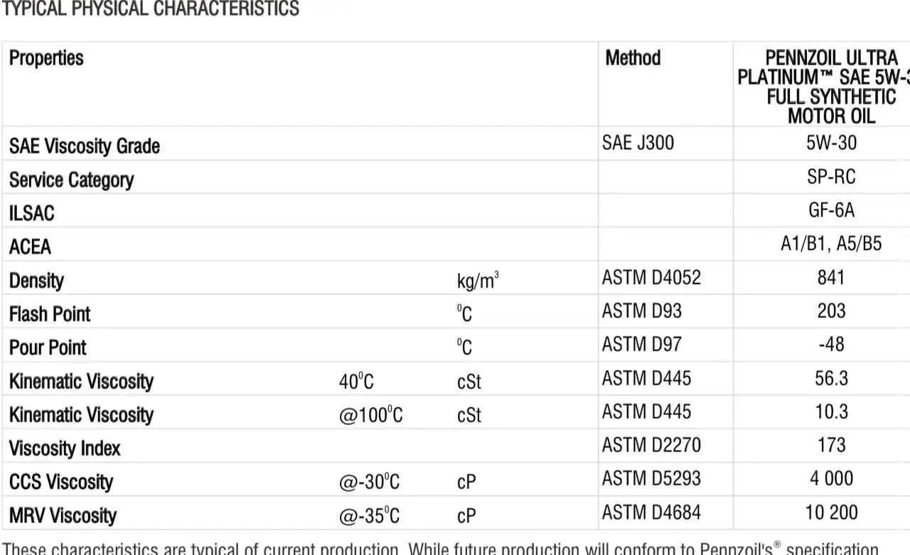

And in regards to the cold temp, any decent oil manufacturer has the physical characteristics.
There is pour point for cold temps. Go near or below and yes the oil becomes a problem :)
example
for reference , our most common Mazda Moly 0w20 pour point is -57C
