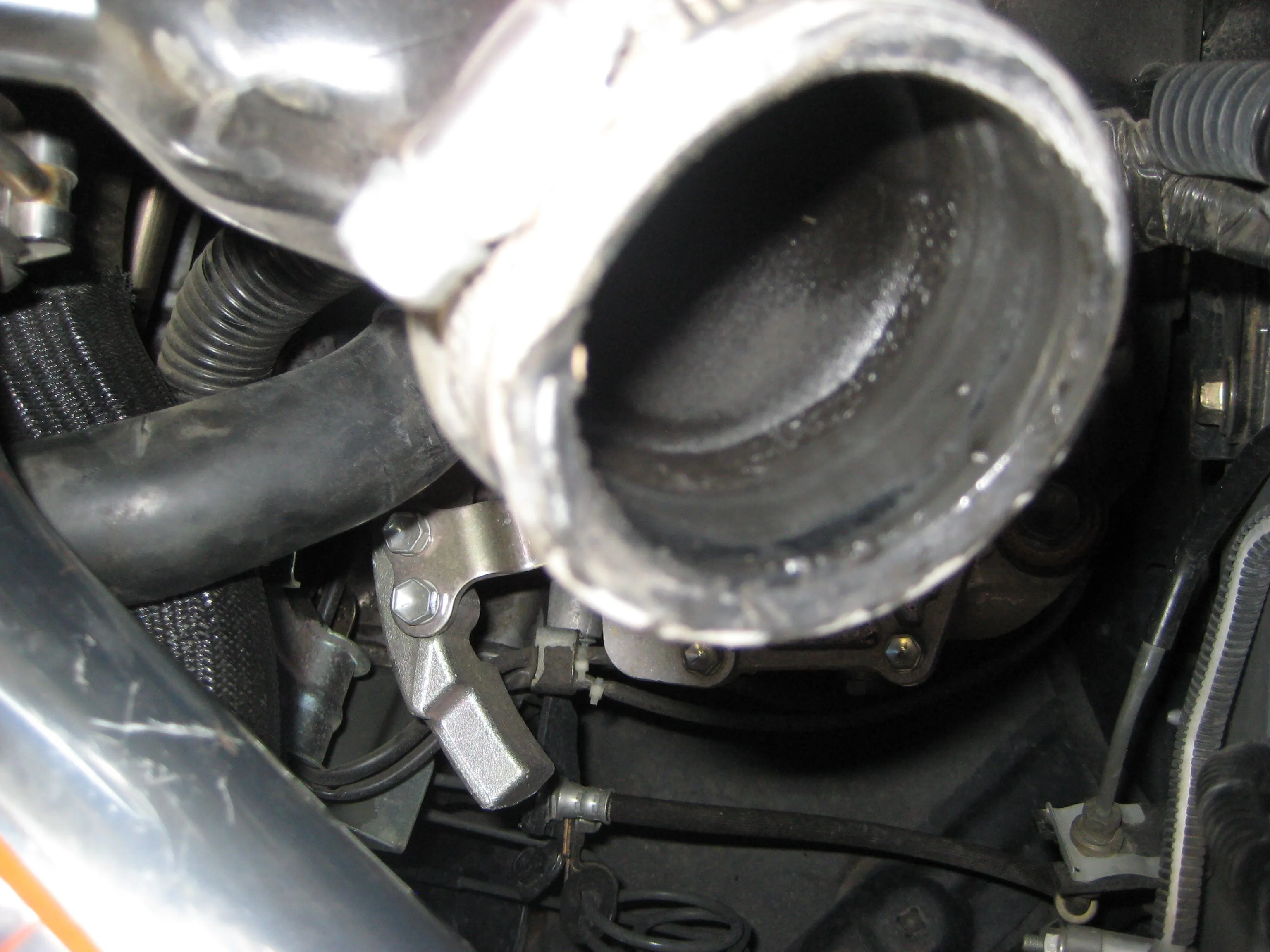

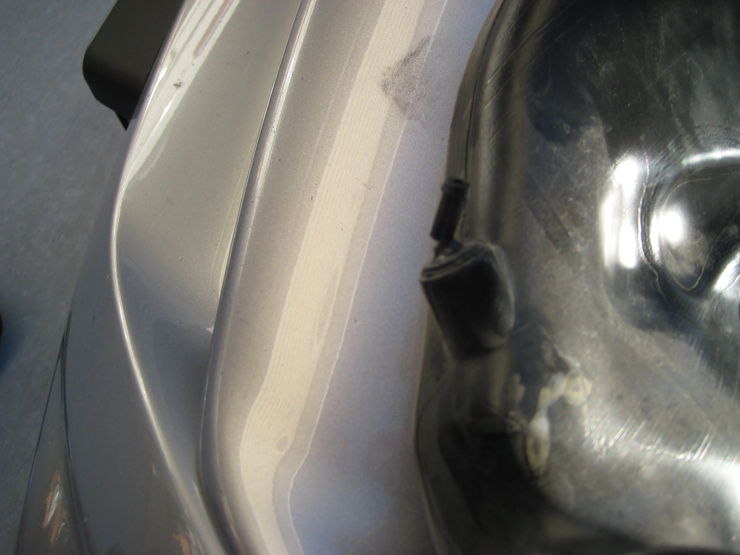

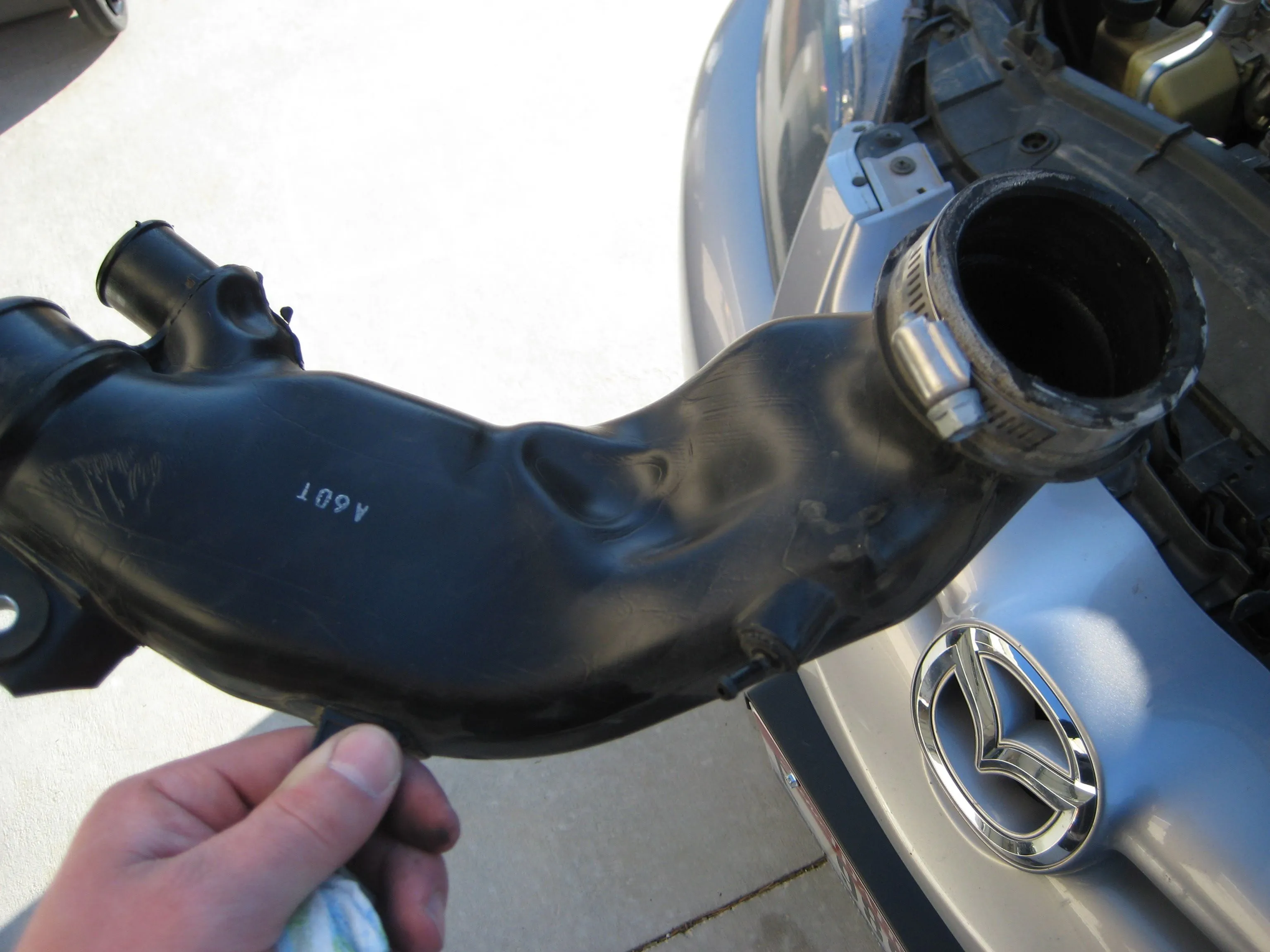

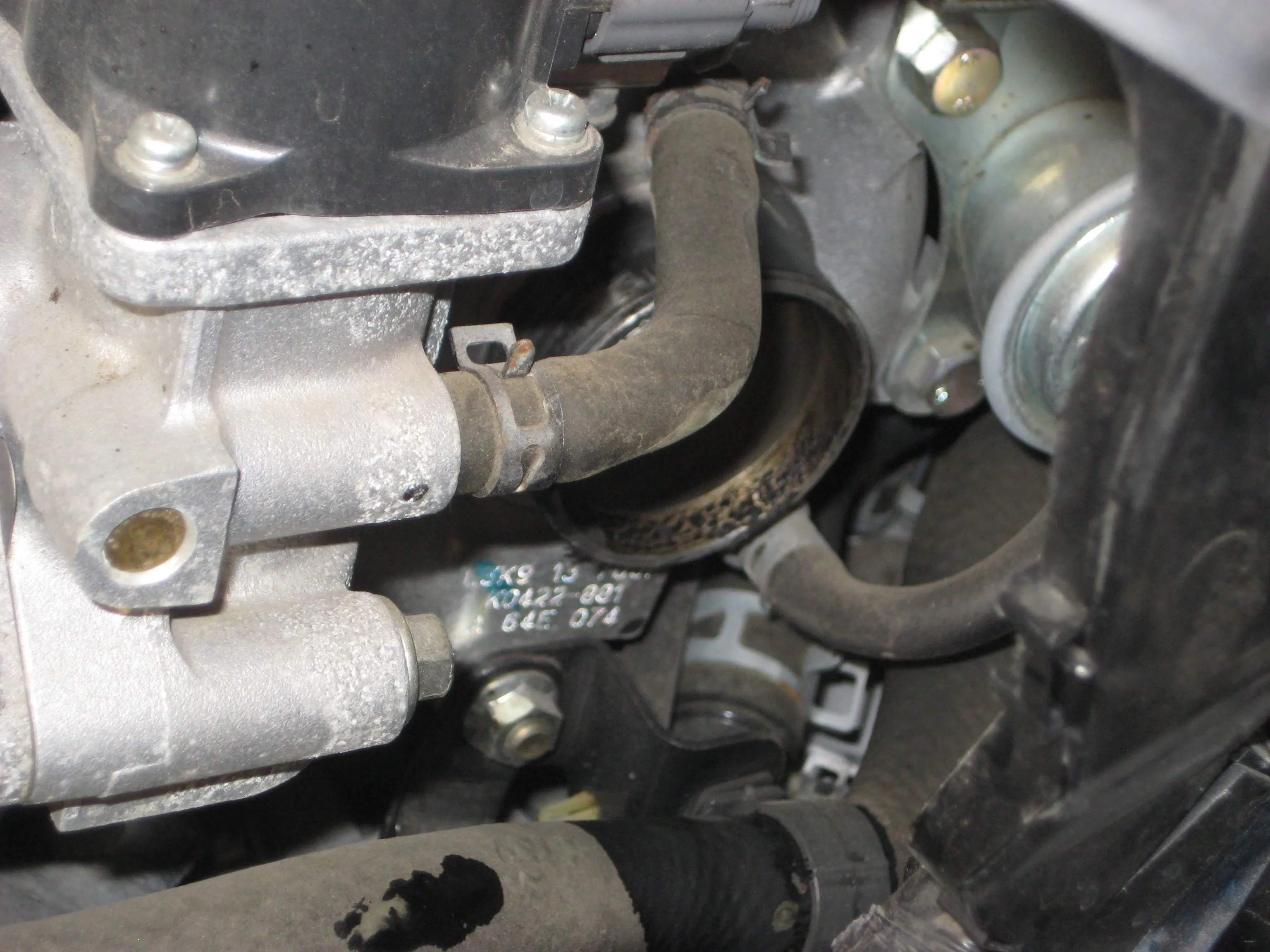

So i changed my TIP and the stock plastic pipe had oil on the turbo end. And the turbo had a litle oil residue on it...So is that bad? Normal? Or no big deal??

The last pic shows where i broke that DAMN NIPPLE!!! CRAP! Hope it doesnt have to go back on...Ill have to super glue it back on...
I have seen them but never really understood them... Why does it not come with one? What does it do? Obviosly catches oil but where and why is there oil to be caught?
In a nutshell, you're venting pressure from one part of the engine to another (PCV; or Positive Crankcase Ventilation). Sometimes an oil or sludge residue comes with that and is cycled back into the intake to be burned up during combustion. It's the lowest maintenance approach because there is no can to empty every month. However, it is not the most efficient approach.
Semi normal...
I know on my last car my 1.8t Beetle there was a ton of oil in the intercooler piping and the turbo was fine as well as the motor.. But I had some PCV issues that I had to fix

EDIT: After looking at your pics. Mine wasn't that bad. On the Tube itself was just some residue. I didn't have any build up on the actual inlet. It had a problem with cutting out. But It was also due to my clamp being completely stripped and loose. Bought a new clamp and it runs perfect right now.
