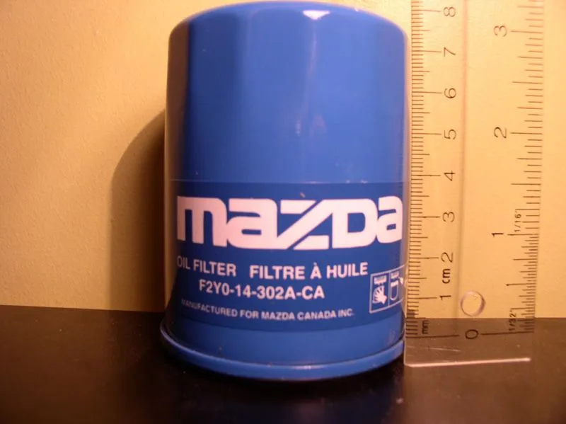

Okay, so I changed my oil & filter today.
After swearing and cussing and asking KD where the little buggar was, I removed the stock filter. It was black, and quite short. I was able to remove it by hand.
I then took the filter tha dealership provided me QUOTE: "I NEED THE MSP FILTER" REPLY "HERE YOU GO SIR" *handed me a blue colored filter*.
Now the BLUE colored filter is actually LONGER than the black filter that came off. Did my dealership shank me and provide me the wrong filter, or is it the factory installed filter smaller for some reason?
Please advise.
OLD filter: BLACK. Codes on it:
TNX 610P1
B6Y2 14 302
New filter: BLUE. Slightly longer.
Codes:
F2YO-14-302A-CA
Thx.

the ZR1 filter will NOT fit into the msp due to the oil cooler
the B6Y2 filter *was* made by Tennex, it is no longer in production
I have no idea who makes the F2Y0 filter since it is only sold in Canada... if you can take a pic of the filter or post what it says on the filter, then that could probably help... the F2Y0 filter is a V6 oil filter, which will BARELY fit into the msp (it is only about a centimeter away from the intake manifold after installation)
here in the US, the dealers are currently selling the B6Y1 and JEY0 filters made in Austria by Mahle.... the B6Y1 is the 4 cyl filter and the JEY0 is the V6.... in Asia, the filters are made by Tokyo Roki in Japan under the same part #

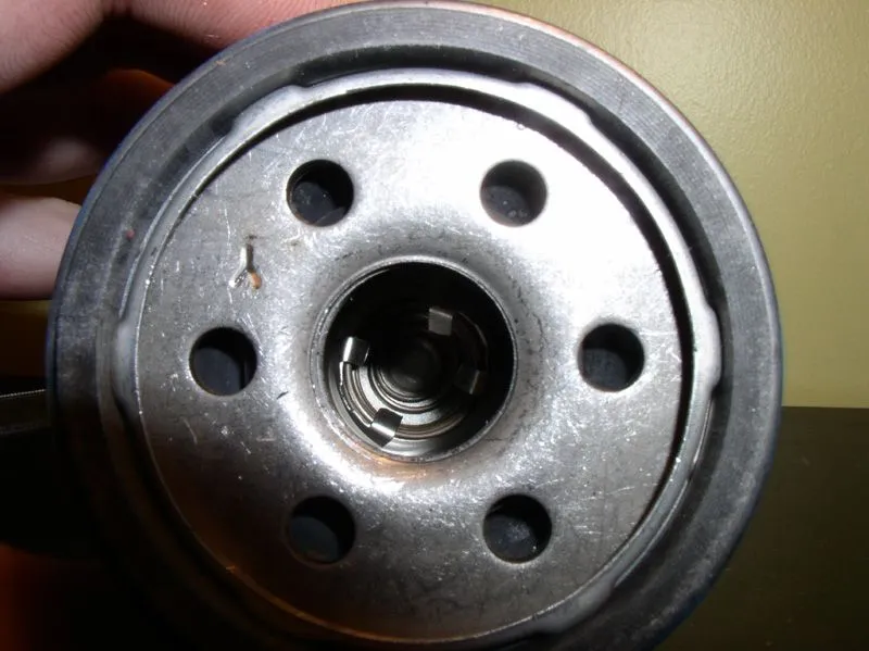

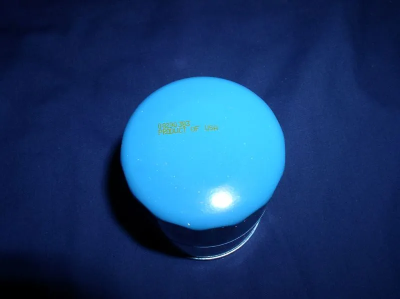

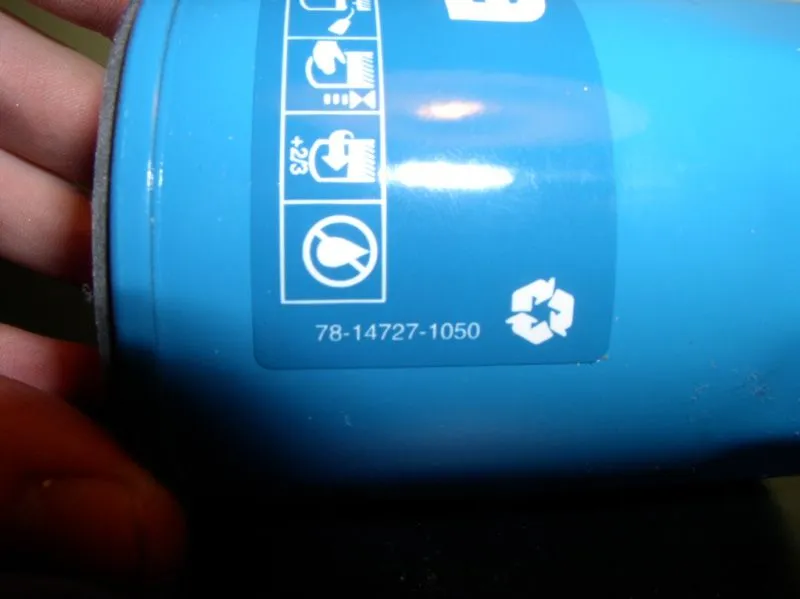

Here are pics of the filter. I want to know if I should order the V6 model sold from mazdastuff or if I should just stick with these ones.
hmm... that filter appears to be made by Champion Labs (company that makes the STP filters)... pretty bad... I say order the "JEY0" filters from a US dealer... they are made by Mahl... thick canister construction, well constructed filter pleats, good by-pass valve design and a much better quality O-ring seal

damn that blue filter is big! almost the same height as the V6 filter!

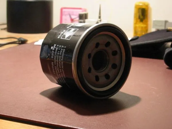

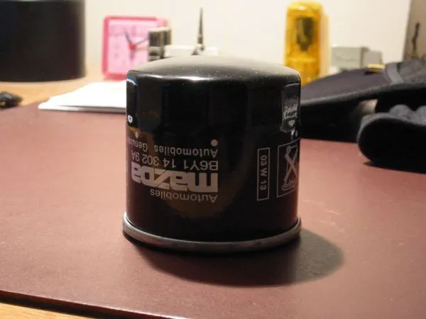

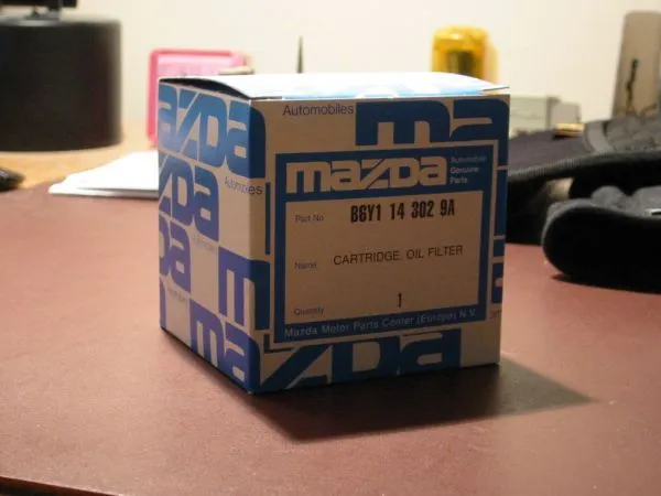

anyways, here are the pics of the 4-CYLINDER (not V6) Mahle-made filters that are currently the OEM filter for the US market
this is the box that it came in:
and here's a shot of the connecting surface, note the high quality rubber gasket :)
this is also the new OEM filter for all Mazda rotary engines :)
