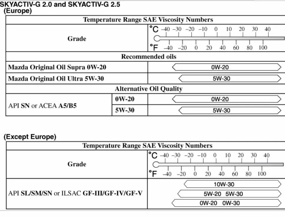

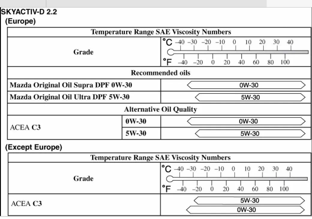

Here are engine oil viscosity charts for Mazda’s SkyActiv-G 2.0L / 2.5L and SkyActiv-D 2.2L used in Europe and worldwide:

So in your situation in the Netherlands, you can use Castrol Edge 5W-30 if 0W-20 is not available as long as it meets or exceeds API SN or ACEA A5/B5. Castrol Edge 5W-30 should meet such standard and actually 5W-30 is my preferred viscosity than 0W-20 on my SkyActiv-G 2.5L.

Europe usually has newer oil specifications coming out earlier than the US. API SP is one step newer than API SN, hence it exceeds Mazda’s API SN requirement. Use it with no hesitation.
Either Castrol Edge 0W-20 or Motul 8100 Eco-lite 0W-20 should be fine for your CX-5. It’s really your personal preference and how much money you’d want to spend.

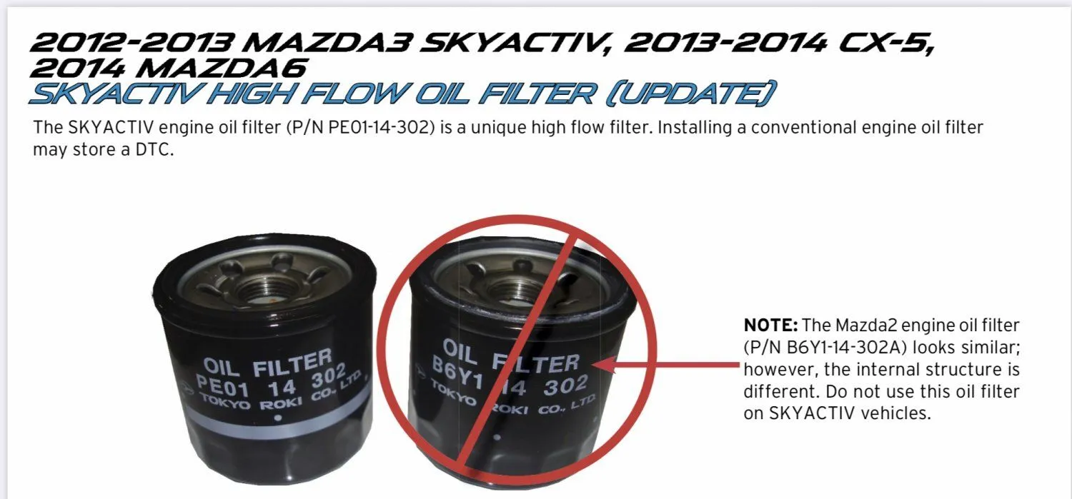

The reason why I don't use Mobil 1 oil filter is that the Mobil 1 oil filer (or many other after-market oil filters) is one-size-fit-all, and listed to be used on SkyActiv-G 2.0L / 2.5L、2.5T、and older 1.5L used in Mazda2, whereas Mazda has 3 different OEM oil filters with different specs for these engines.
Skyactiv Oil Filters
Here is one MNAO PDF to their US Mazda Dealers concerning genuine Oil Filter(s) installation and use for ALL SA Engines..
Mazda Dealers (in USA particularly) are also seeing stored DTC's (Diagnostic Trouble Codes in PCM) when they use even 'other' genuine Mazda oil filters in Skyactiv engines, see pic, they look identical, but it is what is inside.
