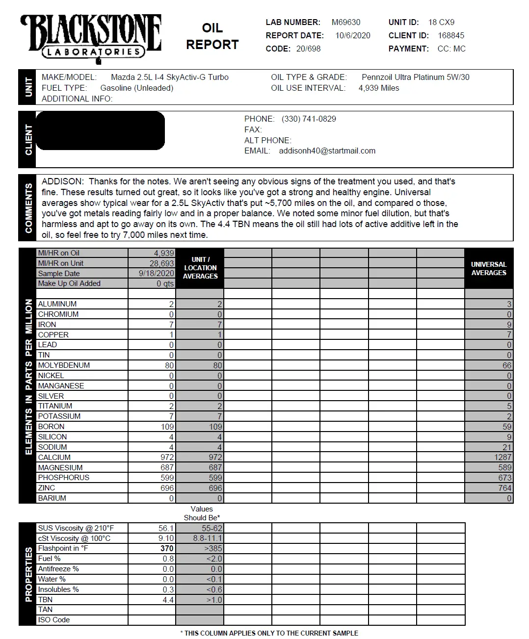

Your iron is more than double mine on the same exact oil and over a similar interval. Also your UOA is showing more shearing of the PUP 5W-30 than mine and I had another 300 miles on the oil.
I do not drive this car easy either and frequently haul around a wife and three kids plus cargo (aka the vehicle is reasonably well loaded with cargo). But I don't do any towing presently.
I suspect this is due to the fact that I am using Hydrogenated DLC coatings (TriboTEX, check out pages 6 and 7 of the "Anyone Here Get Their 2.5T Tuned Yet?" thread) which enhance ring seal and significantly reduce piston ring and cylinder liner wear (hence the difference in iron levels).
That's most likely why my viscosity @ 100C is also still showing 9.1cSt vs. your 8.4cSt (fuel dilution causes oil thinning). Better ring seal will reduce fuel dilution during cold starts. I didn't see a fuel dilution test in your UOA so that portion is only a theory without the results. The viscosity of PUP 5W-30 is 10.1cSt @ 100C when new.

BTW fuel dilution issues are far more prevalent in ALL direct injection engines vs. port injection engines. I do not believe turbo charging itself is going to impact fuel dilution significantly, there are older port injected turbo engines that were not prone to fuel dilution. But many DI engines run more aggressive timing at lower and mid-range RPM, in order to prevent knock they spray extra fuel to provide cooling (consequently Mazda's cooled EGR reduces the amount of extra fuel for cooling by cooling inert exhaust gases and using that instead to cool the combustion chamber).
Also climate and driving habbits significantly impact that. For example hybrid engines typically have higher fuel dilution because they are more often driven on short trips where the engine doesn't fully come up to temp and vaporize the fuel and moisture. Consequently it only adds to engine wear because of higher acidity, lower peak load support and frequent on / off cycles where bearings drop out of hydrodynamic lubrication regimes. I have a 2012 Prius C, but using a good quality oil (PUP 0W-20) and pairing it with TriboTEX minimizes those issues while enhancing long term wear and increasing fuel economy while cruising on flat ground or down hill (where friction losses matter the most).
It's a great technology but not many people are aware of it as it's relatively new and was not originally developed for commercial applications (it was developed for wind turbine gearboxes and military vehicle axles that have very high torque loads and are prone to wear issues).
I'm not an "oil additive guy". I've never once used an oil additive (TriboTEX is not an oil additive btw, it does not alter the chemistry of the oil but simply uses it as a carrier, it is an In Situ Hydrogenated DLC coating that forms over hundreds of miles via heat and pressure on wear surfaces). It is suspended in an Ester base oil and once formed enhances overall function via reaching super lubricity levels, providing a wear film that reduces wear in the boundary layer and mixed lubrication regimes, supports higher oil film strength (due to enhancing oil molecule adhesion to bearing surfaces) and allows more power to the wheels (reduced friction looses, again in boundary and mixed mode lubrication regimes).
