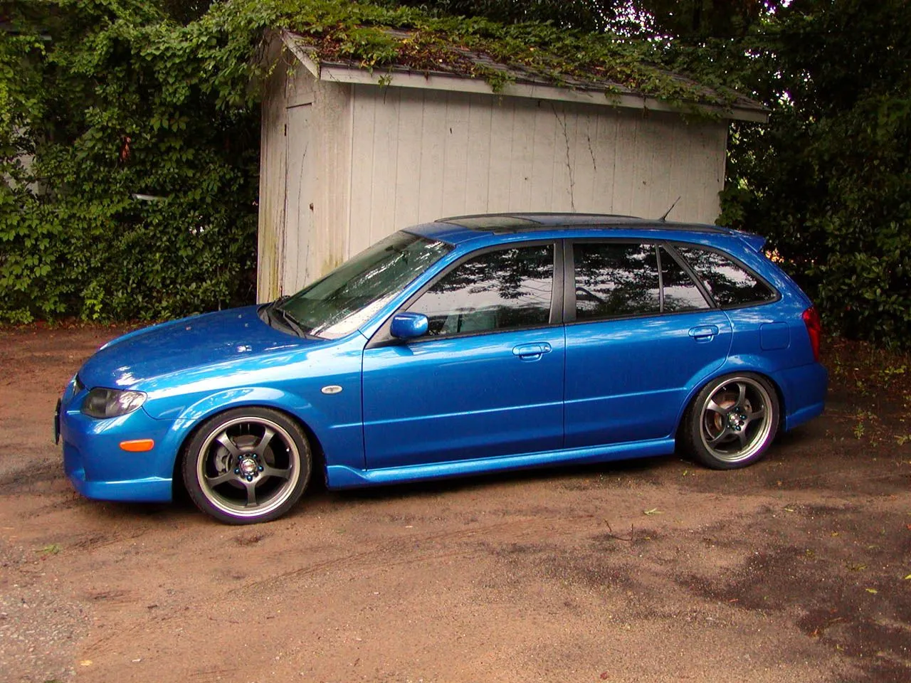

17x7 Rev Model VI gunmetal with a polished lip, +43 offset
205/40/17 Toyo Proxes 4 tires
Zero rubbing at all

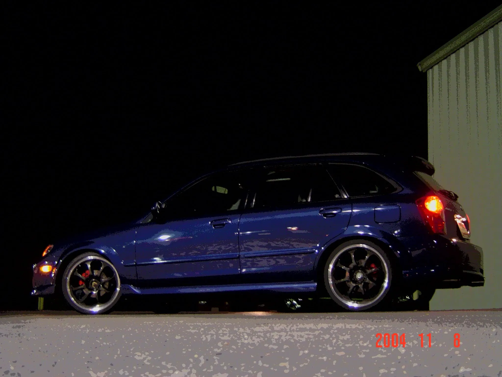

Finally. 18x7.5 Gunmetal Arospeed Crazy 8's. 48 offset, 215/35/18 Nankang NS 2's.
