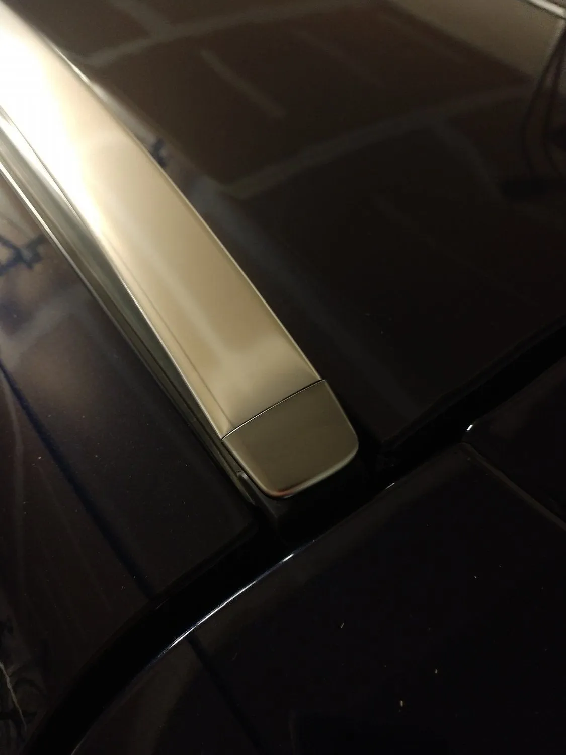

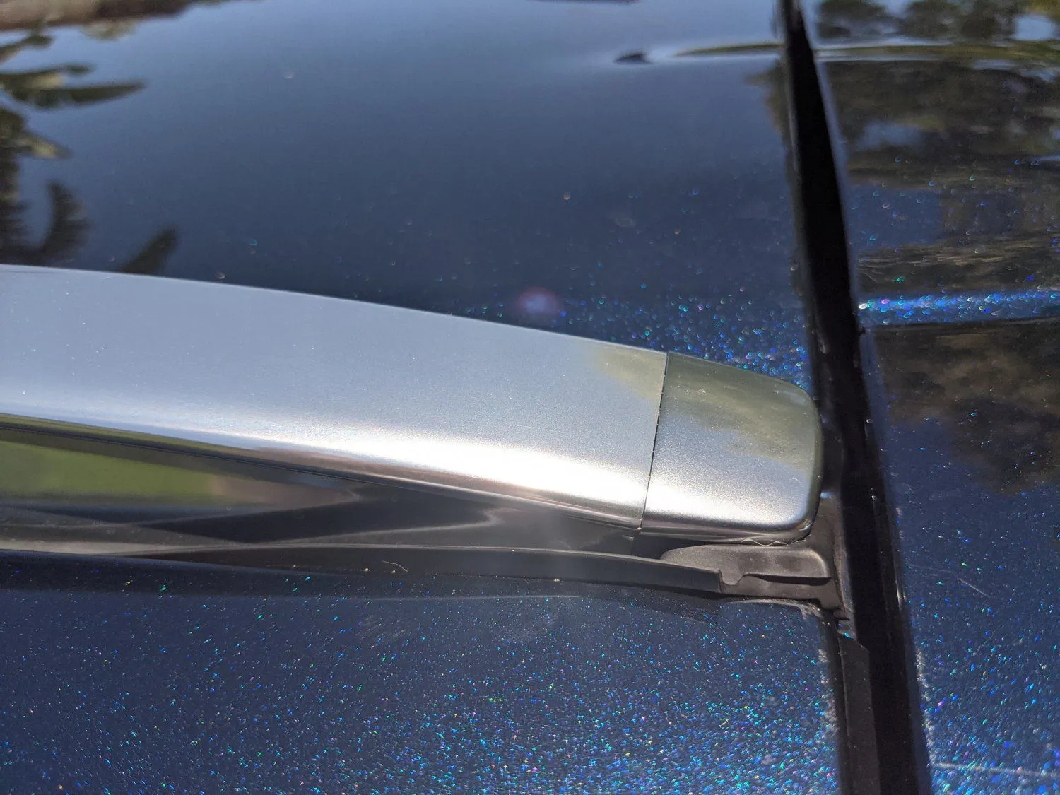

The roof rails for my 2020 CX-5 were installed by the dealer (already on the car when purchased) I've had the car about 3 weeks. Yesterday I was washing the car and noticed the rails aren't installed correctly. The left side rear molding part is not flush in the channel the rails mount in and is kinda bulging up on the sides. I've attached some pictures.
My questions are does this even matter? Does this affect water draining off the roof correctly or over time will this lead to the roof rails breaking or damaging my car? And based on that is this something I can easily fix myself by removing the rail and reattaching it or should I just take it back to the dealer? The dealer is about 45 minutes away so it's not just a quick hop over there to deal with this.
I am kinda OCD so now that I know this is messed up I'm gonna notice it all the time so I probably will want to fix it one way or another.

it appears from your picture that the rubber moulding piece twisted under the rail during installation.
There are no bolts/screws that far towards the end, so it’s not bulging the rail, just the rubber underneath. So no damage would be caused aside from the rubber.
To fix; carefully remove the caps (at least 4 of em) loosen/remove the screws, lift the offending end gently, then adjust rubber accordingly.
Tighten screws to 110in lbs. don’t over torque.
Tools needed would be a t-25 and a thin sturdy pick of some sort for cap removal. Just insert gently on each side of cap(pop one side at a time works)
A fiber stick is handy too if needed for the rubber movement.

I would first try to just push the rubber down and in with a plastic spatula, or the edge of a credit card. You may well find you can seat it much better. Even if not, only loosen the screws at the front to get the rail lifted slightly and try the 'pushing in' again.

And I wouldn’t try shoving it around, that will tear the rubber with how twisted it looks.
