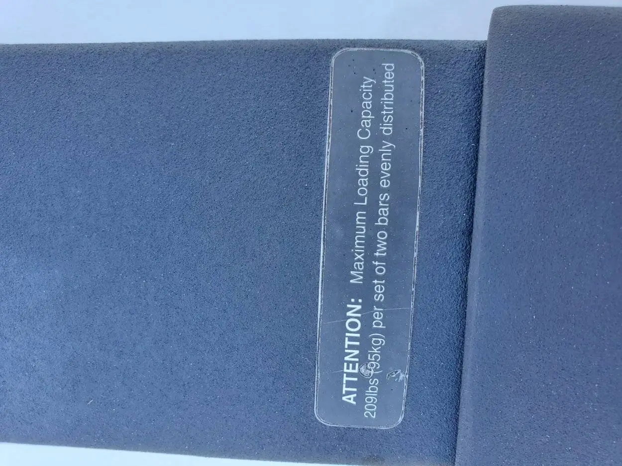

Weight-wise you are in the clear. Useable space for attachments on the bar is 32.5". Hope this information will help.
