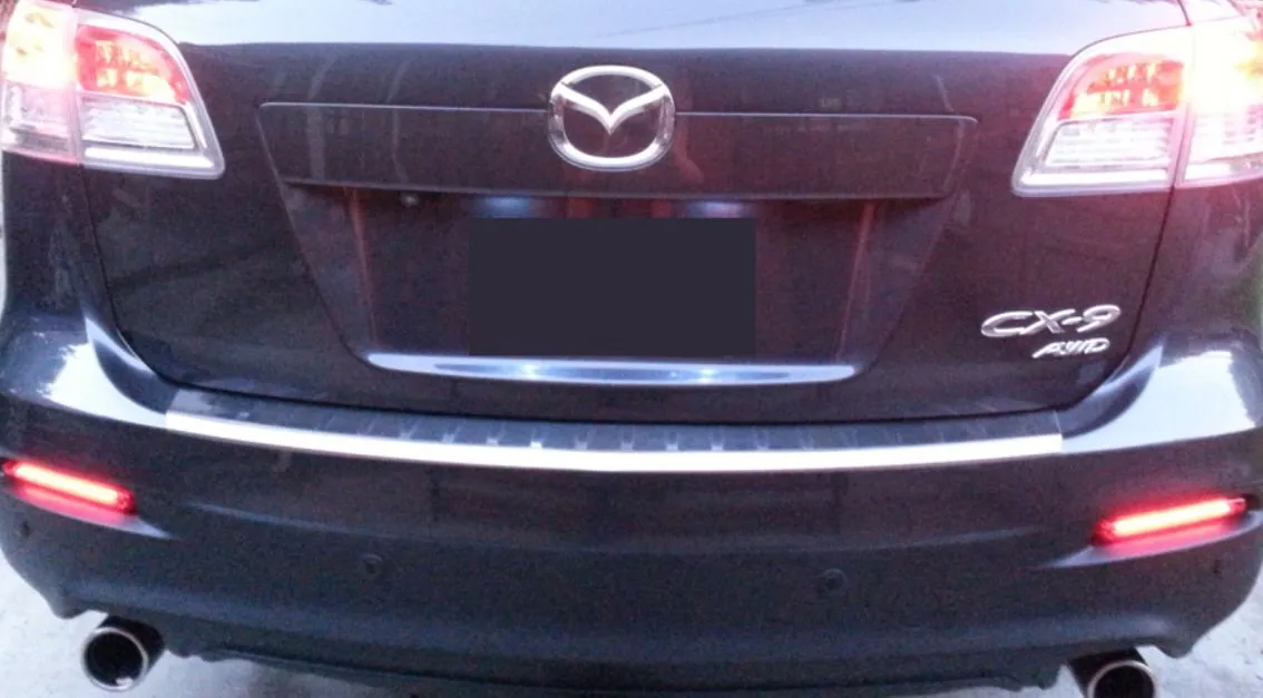

someone did the same for the 1st gen CX-9, I plan to do this mod also....

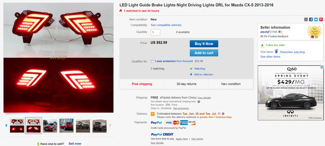

adding those cheesy chinese LED bumper light replacements lots of car modders these days likes to do does NOT increase safety but in fact makes it WORSE... they have LED light bars only, NO retroreflector

the OEM parts are fine, regardless of which country it's meant for... by all means, get those... just stay away from the cheesy chinese ebay crap you had posted earlier

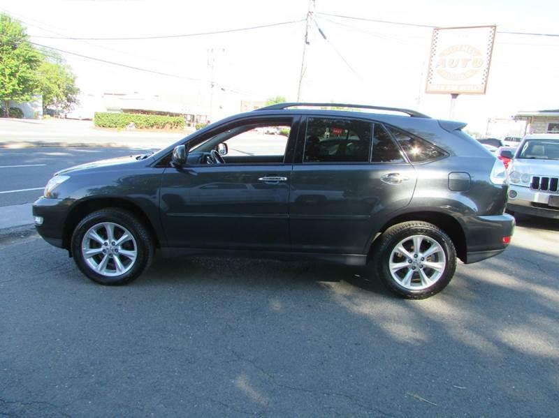

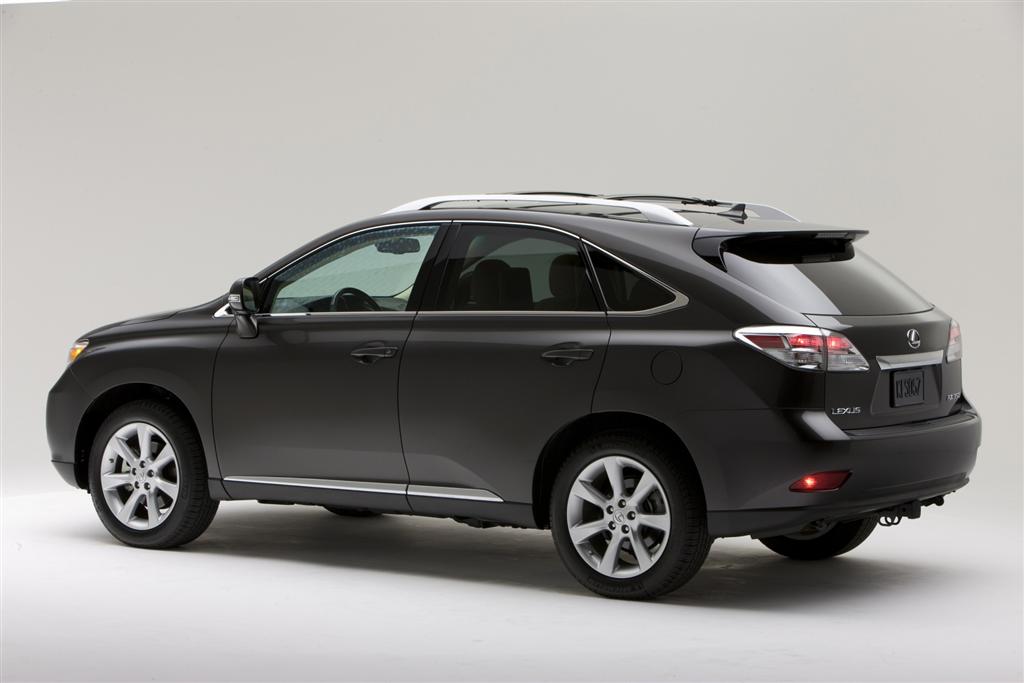

⋯ I've also seen OEM Lexus RX, Audi A5, and Inifiniti EX with lighted bumper lights straight from the factory not modified by owners.....
Yes I did see friend's Lexus RX 350 has two lighted rear bumper lights from factory on the other night. The intensity is low like the taillights and they serve as part of the taillights.
⋯ the Lexus, etc cars have them because regulations requires backlit SIDE retroreflectors, they just happen to be also visible from the rear... they're not there to help others see you better from behind while you're driving down the road... that's what the tail lights are for!
No in case of Lexus RX 350, the lens of those rear bumper lights, just like our CX-5, can't be visible from the side. Lexus make them lighted as part of taillight in US market simply is to show the distinctiveness for marketing. In other regions where the rear fog light is required, they will be served as rear fog on one of the locations. The rear side marker, or "backlit SIDE retroreflector" is build-in on the side of taillight unit, just like our CX-5's.
US DOT requires front amber side reflectors or "retroreflectors" with light starting in 1973; and rear red side retroreflectors with light starting in 1974. In addition, two rear-facing red retroreflectors are required with taillights since even earlier years. Those retroreflectors and lighted side markers are not required by any other regions in the world, hence car manufactures have to find a clever way to design different front and rear light housings for different regulations. Using rear bumper lights for rear-facing red retroreflectors for US market, and rear fog for other regions is just a simpler way for manufactures to meet different regulations.
Wrong. Older RXs had tail lights which did not have built in retroreflectors, necessitating the installation of non-integrated retroreflectors, which in this case at the bumper corners that also served as rear retroreflectors... the position of the bulb in the bumper lights also indicates its intended purpose, which is for illuminating the side retroreflector. Regulations does have minimum intensity limits and required viewing angles for the light source of a "side marker"... regulations also do allow the light source to be at a different location than the actual side retroreflector... it's allowances, I don't know because reading the US regulations sucks, thus I don't care to bother
The side retroreflectors are now built-in to the tail lights on the latest RX though, thus there are only rear retroreflectors in the bumper now

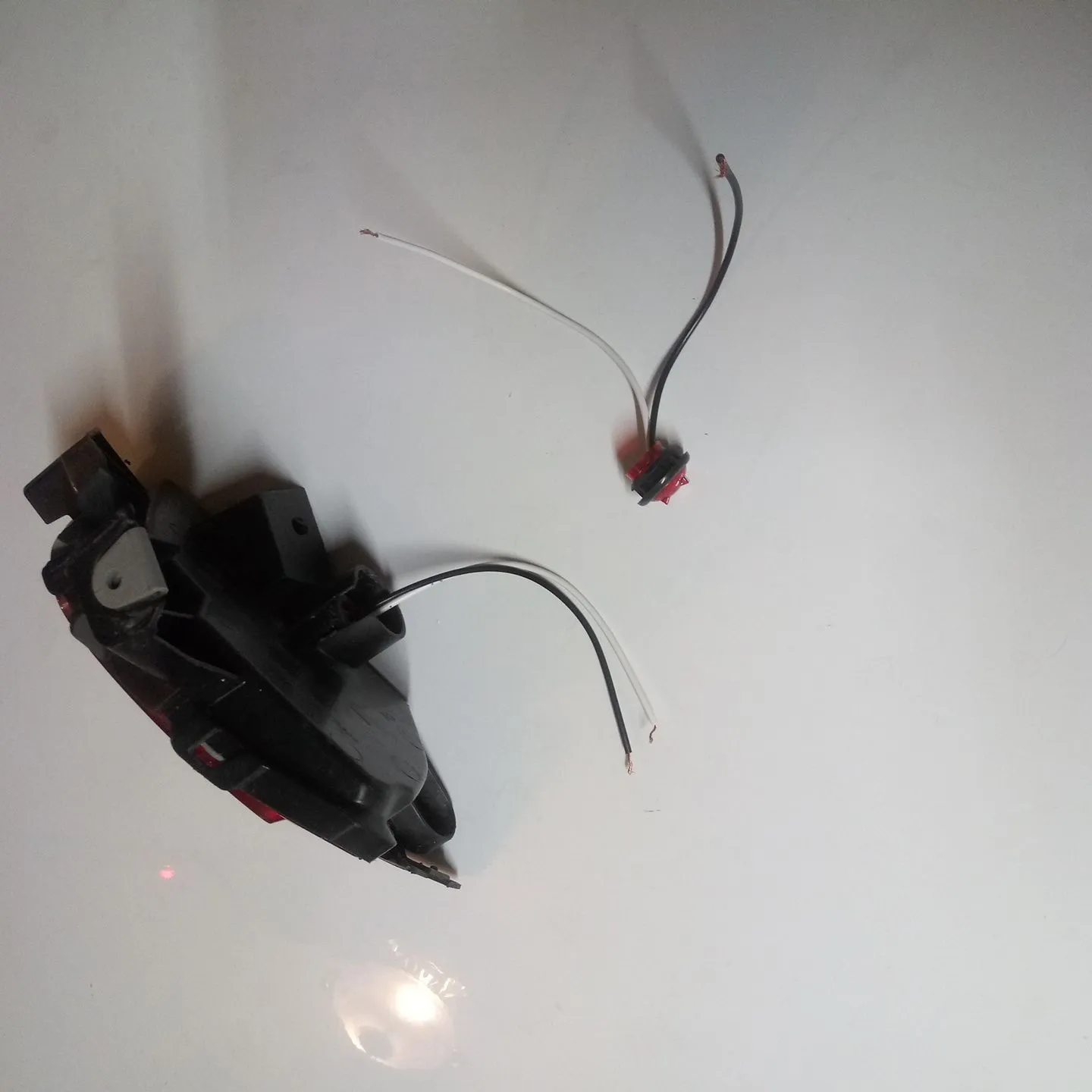

I decided to go with the OEM housings and add a small aftermarket led sidemarker.
I bought them at Walmart for a few bucks. They probably make them to add to a trailer.
I drilled out the center part of the existing vestigial bulb holder. I had to enlarge the hole to 5/8 " so I used a rotary rasp I bought from Harbour Freight in a cordless drill.
I prefer to attach to the sidemarker bulb because this led is about the same brightness but it could be linked to the brake light.20200204_073714.webp
