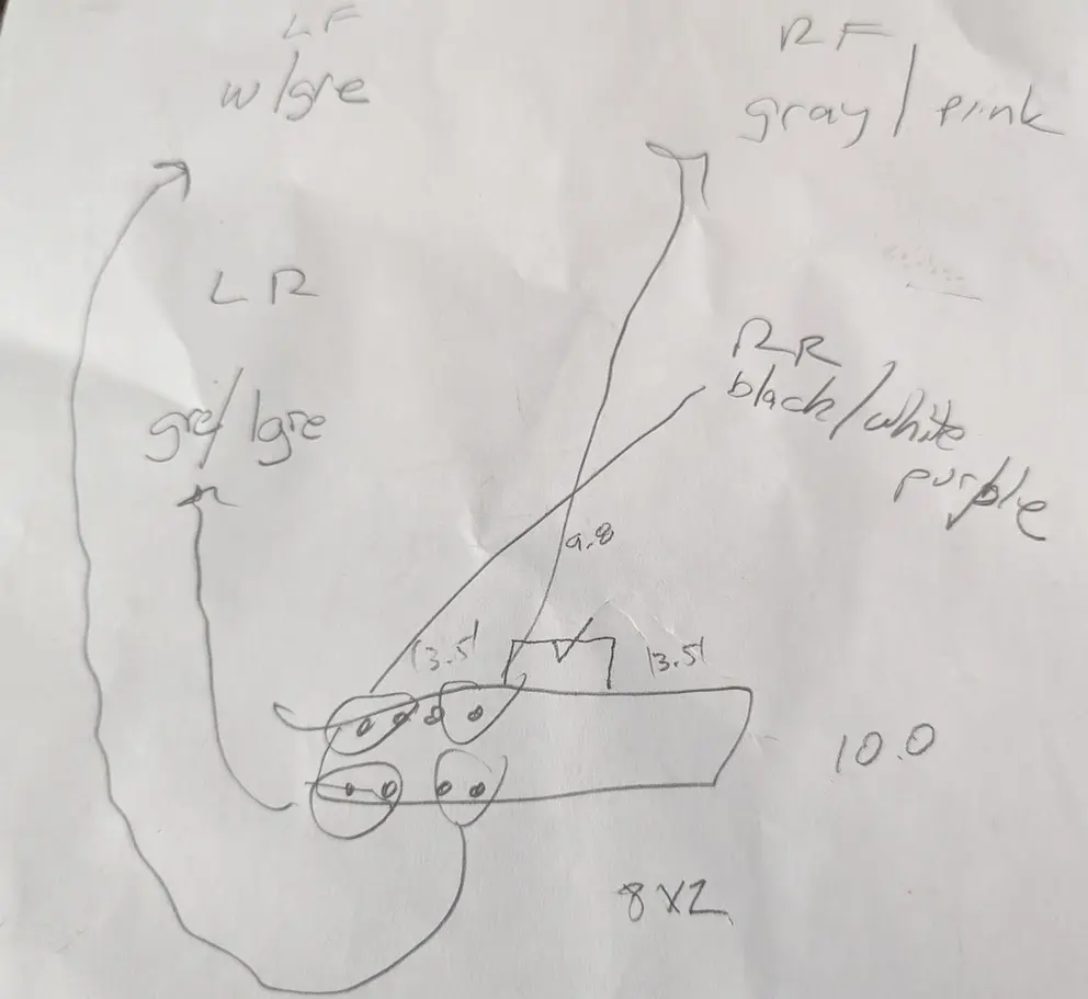

is there a diagram of the Piin out anywhere?
Yeah, I made one. ;) This is looking at the pin side of the harness, not the wire side. You'll see what I'm talking about with the wire colors and all when you get in there.
LF: white and green
RF gray and pink
LR green and light green
RR white with black stripe and purple
As far as which is + and -, I haven't gotten that far yet. But to verify this, you should always, ALWAY do a polarity check with a very inexpensive meter. These are good for home audio, too!
