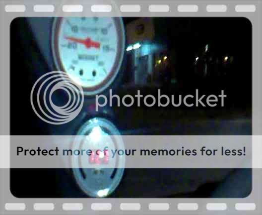

A couple members of the forum suggested that I get a boost gauge so I picked one up and ran it to the cabin. The vacuum is at 22 and the boost is picking up slowly but surely to 6psi.
Any ideas?

Ok I did 60 in 3rd gear at 4500RPM with no boost so it is possible to run 0 boost i guess. Not WOT of course. Did you pay for the dyno runs? I wouldn't pay if it was only being pushed to 3500rpms and running lean. Can you post video of your boost gauge response?
