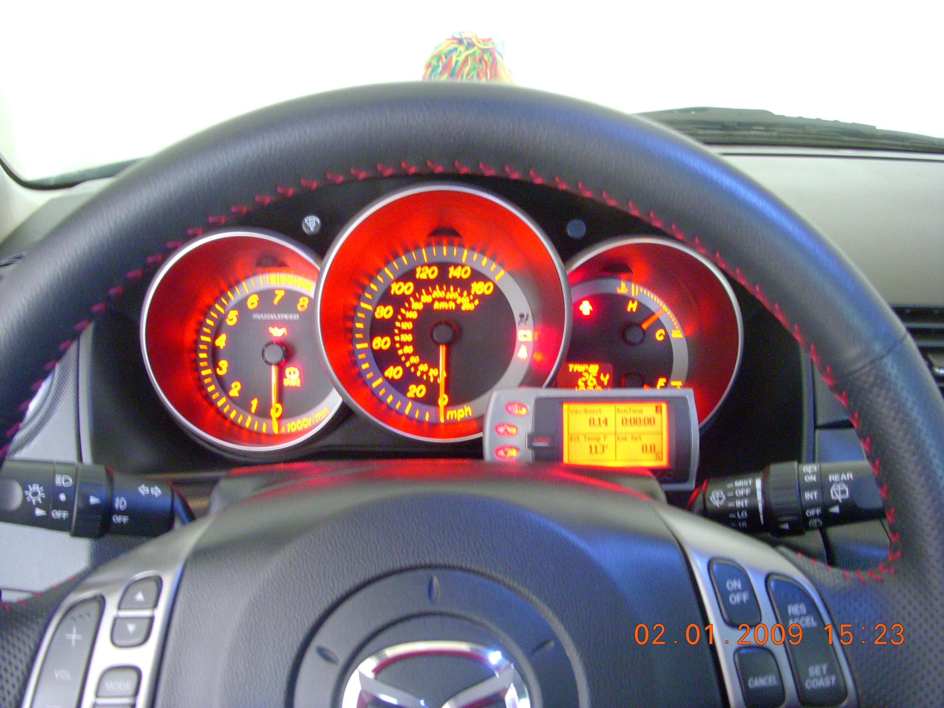

I gotta get a Dashhawk...Honestly I just wish it looked a little diffrent...I know I'm too picky.
You need to get one even if it cost 299. If you are running any kind of tune, it is a must. And it looks awesome with the matching color.
