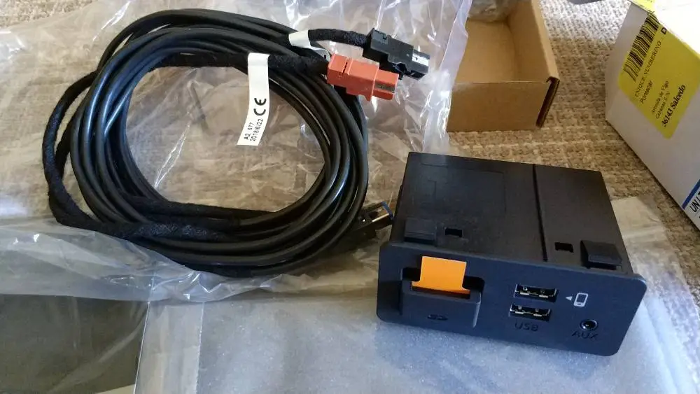

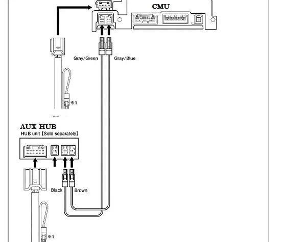

Here is Wiring diagram and the parts needed..

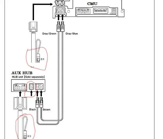

Do you know what the circled connectors are for? I am assuming the one with the 1 next to it out the original USB cable? What is the circled port on the back of the AUX hub?Questions.webp

Yes, all you need are the cables and the USB hub.

And no me not personally, but provided AUX Unit is the ORANGE Label TK78, you should be OK, having said that those who have bought the KD USB cables from China have reported issues, I do not think it is the AUX Hub, but perhaps the cables and or perhaps the installation of, you do know that YOU MUST install the NEW FIRMWARE FIRST with the old parts still attached, once you have installed the new 70's Firmware, you then install the new parts. Any other way and it will NEVER work (CP/AA).
