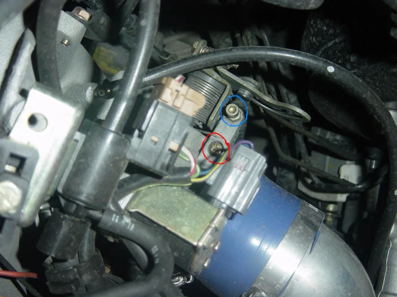

You may want to unscrew at least 2 or 3 turns the by-pass screw in the throttle body. It is the one with the red circle. The one with the phillips screw. Do it counterclockwise until you get a steady idle. Juan
Thanks Juan, I'll try that today. Just out of curiosity, what am I actually doing here though?

it wil raise/lower the idle of the car
actually, that's the other screw in the picture. The allen head one.
The screw is the throttle bypass. I'll leave it to the experts to explain it, though. :D

the reason is that the IAC valve isn't working with the Haltech, and you need at least SOME air in there.
Right, the Haltech is NOT controlling the IAC valve, so you may have to open the screw a little to get your idle right. I idle at about 870-1004 RPM.
The reason is that for some reason when you cut the injector wires, the stock ECU works in a different way and does not control the idle as well as when the injectors are working with the stock ECU. Just by allowing some more air in, the idle control motor works better. This will not change the stock idle speed thought. It should be around 650 to 700 RPMs.
No, PLease do not touch the allen head screw. That will chnge the voltage in the TPS and will screw all the stock settings. Both screws will do the same, they will allow more air, but the idle by pass (the phillips one) is the one to play with not the allen.

I was telling him not to mess with said screw.
