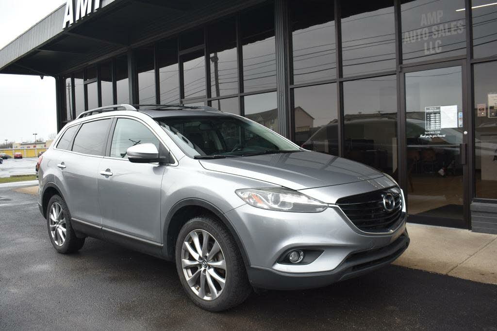

Greetings, I love the CX-9. My girlfriend is interested in buying a 2015 CX-9 Grand touring. It has 129,000 on it. I believe they want $10, 800 but, I don't know if we are going to meet that price.
What can you all tell me about these particular automobiles? I had a 626 back in the day with my first wife that was brand new. Love that car. Ever since then I've been a Mopar man could be eights only. So I lost track of Mazda. But I got to tell you when we test drove this one today it was smooth. I hit the gas pedal as if I was in my Dodge Charger and it didn't seem to like that but that could be the all-wheel drive. Any information you could offer would be great. Here's a link to the car we looking at
Thank you in advance!

At that mileage and price I'd skip the Mazda. Basically it has a Ford engine with a water pump design that will take out the engine if the water pump leaks. It's inside the engine and the leaks go directly into the sump. Coolant mixes with the oil and that's the end of the engine.
Also, the if the PTU for the AWD has not been maintained properly they can grenade and create a whole other set of problems. At 129K miles that's another potential time bomb on these cars. The genius' at Ford decided to put about 1/2 quart of lubricant in there and make it a 'sealed for life' component. Don't even mention the fact that it's mounted next to the hottest part of the exhaust.
I know all vehicles have their Achilles heel but this one has two major ones that would be enough to make me move on to something else. Good luck with your search.

Well as beautiful as the automobile is, she needs this for a daily, I'm going to pass. Did some research found out it had some mechanical issues. Call the dealership and told them I knew about the mechanical issues so what are the mechanical issues, that's when they let me know that they replace the engine after they got it from auction. There's another one coming up, 2015, CX-9 GT with about 33,000 mi. I'm not sure what they're going to charge but I got my eye on that. I also got my when an Acura, a Honda, and a pathfinder. Less miles and no shady business about replacing the engine. The guys could have told me that yesterday when we were test driving it. It would have made a world of difference as opposed to me finding out on my own and having to ask them about it.
Thanks for everyone's input. Good information. I'll take all this into account If I look into the one with $33,000 mi on it
