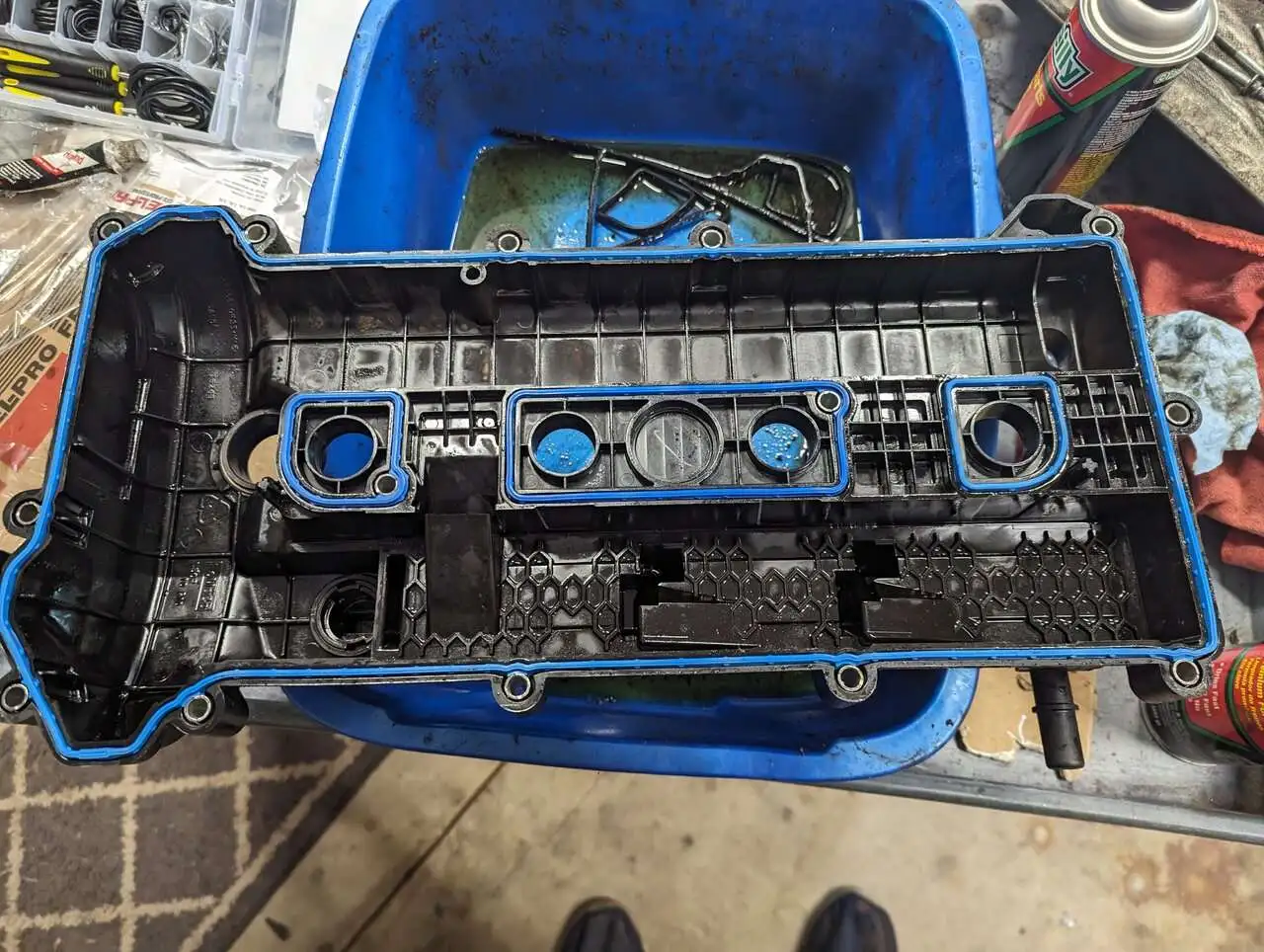

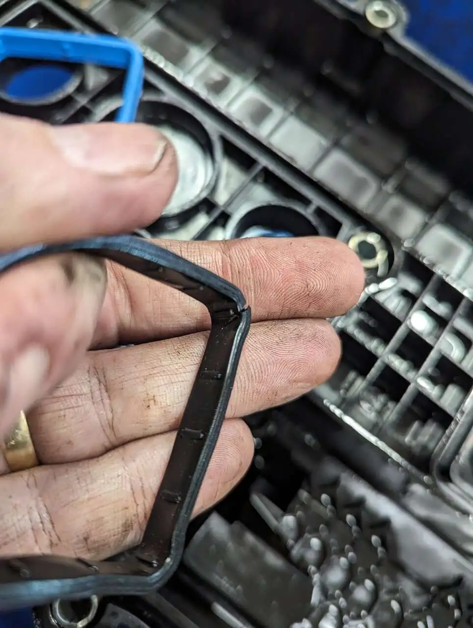

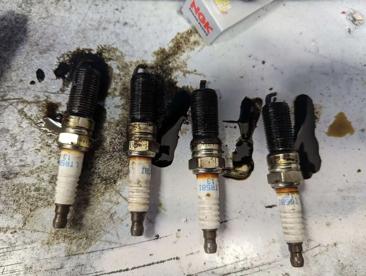

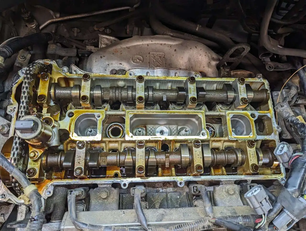

150,000 miles on the 2012, time for new valve cover gaskets. The internal one had failed, coating the spark plugs.

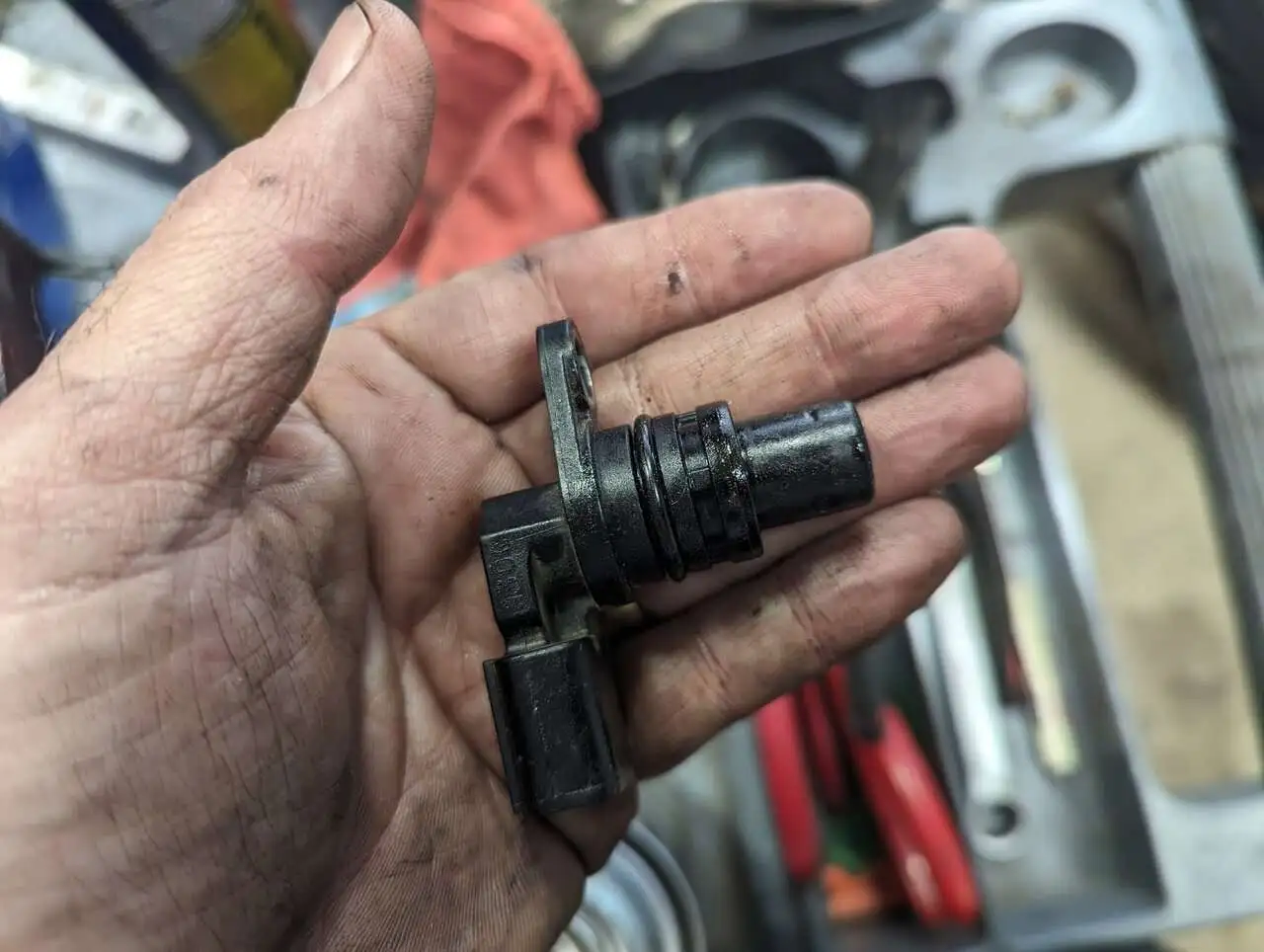

I used Fel-Pro part number VS 50639 R-1. Perfect fit. I also changed the o-ring on the cam position sensor while I was there.
