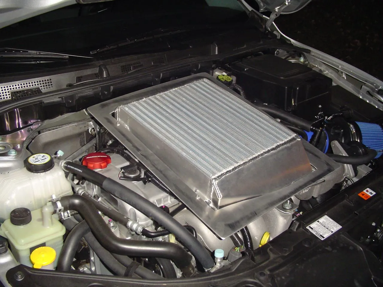

I've had the TMIC for a while. It seems that top end opened up quite a bit. They are very different in design. The ETS has much more surface area to absorb/release heat.
I just put my ETS 3.25" TMIC in a few days ago and the first thing I noticed after a long drive is the intercooler is cool to the touch, almost cold. The stock intercooler would be extremely warm, if not hot, after that same drive.

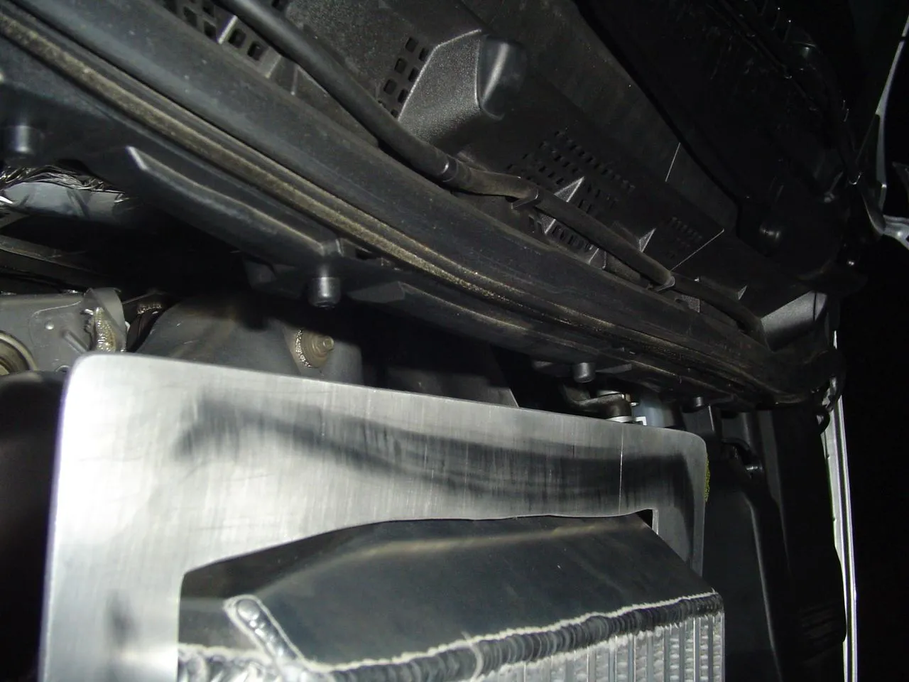

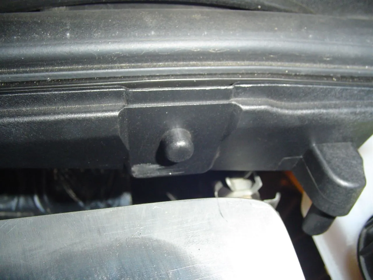

It didn't stop my ETS TMIC from hitting the back of the engine bay..i'm guessing because it's not stiff enough. However, I know where it's hitting and it's just a piece of plastic..so I think i'm going to trim the plastic down and leave it at that.

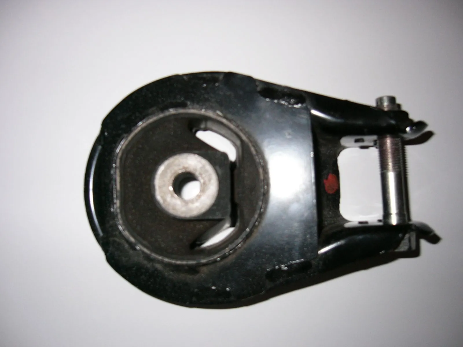

No, it takes about a month to brake in the su mount. Is a #62 urethane, so is stiffer than stock, without being hardcore. The reason the stock mount sucks is because of the gap in the ruber that allows for A LOT of movement.
Check this video and see the movement:Here
And a pic of the stock mount:

It could be a design thing. Here are some pics of mine that I took tonight.
You can see the gap between the TMIC and the back of the engine bay and where it's hitting at.
Is that stock mount torn...? Eww, thats a horrible design...
